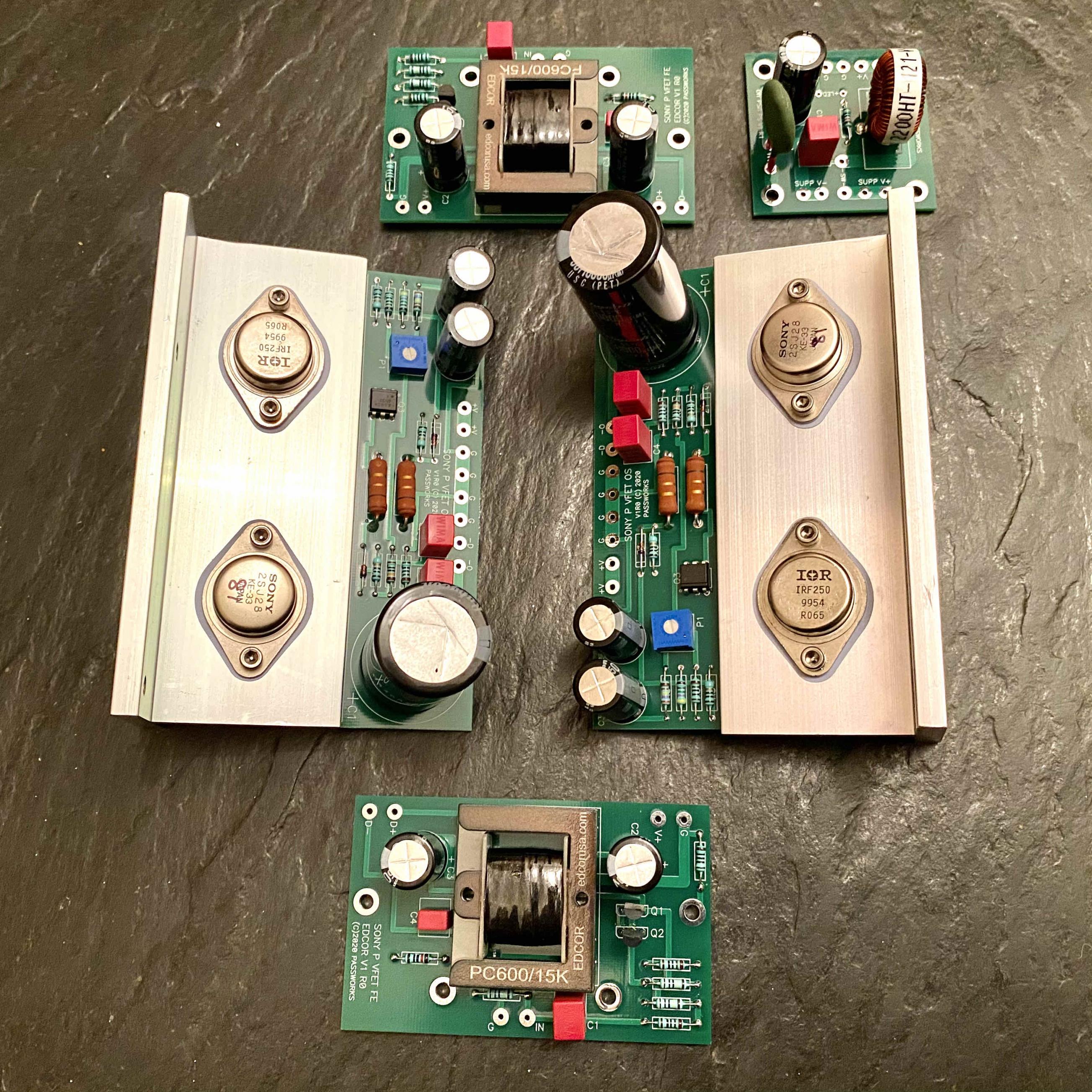

Builders alert - an artwork error on as many as 8 of the OS boards out there have the
output cap legend reversed. Check the builders thread for details, but the C1+ should
be pointed toward the bracket, not the edge of the board.

I finished the boards tonight and I don’t have a prototype board so the + sign for C1 is towards the metal as it should be. Quitting for tonight, time foe a beer and to listen to some music. I want to stretch out this build and savor it. Once again thanks to all, who made this happen!

FYI, It seems we do also have "prototype"/earlier revision (at least 1 pair) input boards over in the building thread.

On to the reason for my post. This greedy-boy, who suffers from audio nervosa was wondering what the minimum voltage rating is for C2 (the DC blocking cap between jFets and Ecdor) on the Front End? I’d like to use a Silmic II there.
Second, compared to the schematic on pg5 of the article, the pcb has switched the positions of R1 and C1. If C1 blocks incoming DC, is R5 (“bleeds DC to prevent thumps”) needed?
16V will do
in fact, no - you need 100V there
send all useless caps with lesser voltage to OPLDF
