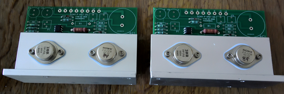

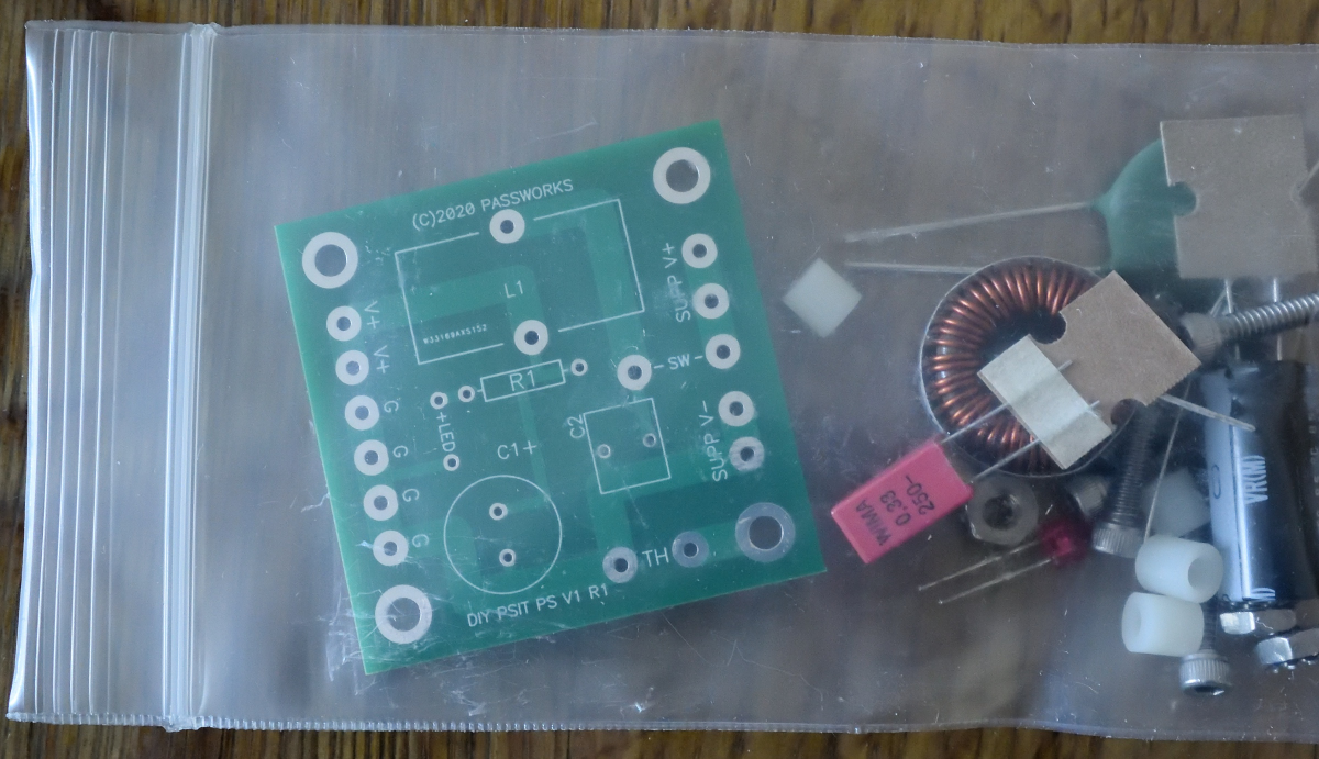

I picked up my kit today!
The VFET boards seems to be the production types with + close to the alu bracket.
The SMPS filter boards I never realized how to check if it is production or prototype but both will work well was my conclusion.....
I am not aware that there has been an "issue" with the filter boards...
That said I'll assemble my front-end board without fitting R7 even if I did receive the final production version.
It was something with a gnd/chassis connection.....which was not really needed as it was redundant....something like this 🙂
@ Meper
This chassis ground connection was with resistor on the FE cards.
Without R7 on the card is a prototype
