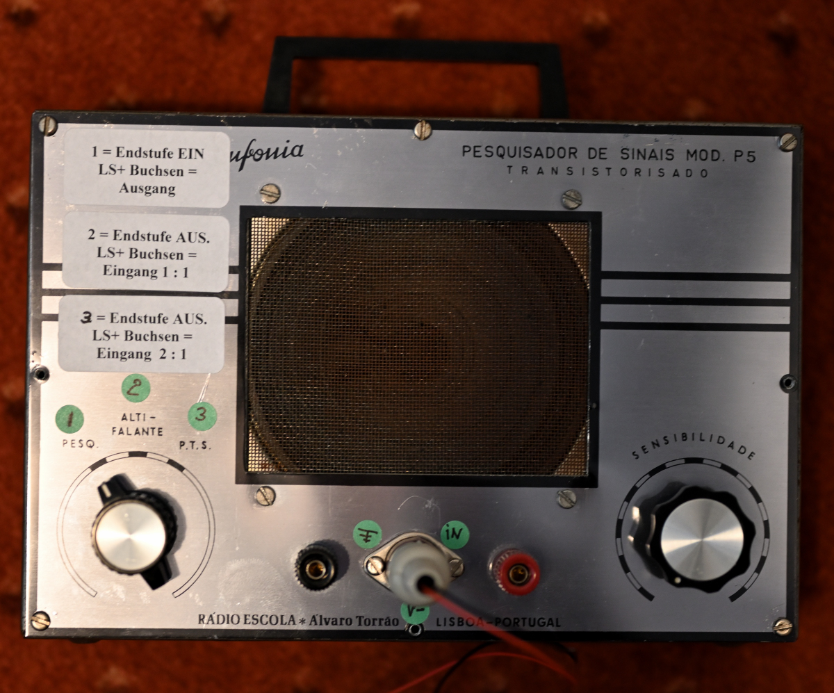

did you made any step in localizing exact source of noise - FE or OS?
Yes, I think I can say with high confidence that noise is generated on amp board. I used the old equipment from Portugal a "tube-guru" sold to me for "nothing" and told me it could be very useful for tracing "errors". I used the setting where an small amp amplifies the signal and outputs it to the built-in speaker. It has a 9V battery inside and I could hear the noise very clearly when I "measure" at -O at amp board but not at -D which is the input/output from FE-board. I also did a similar comparation with other channel where there is only a faint "ssshhhyyyy" sound at -O.
I have not tried to "work" with pot to check if a bad connection could cause this strange noise.

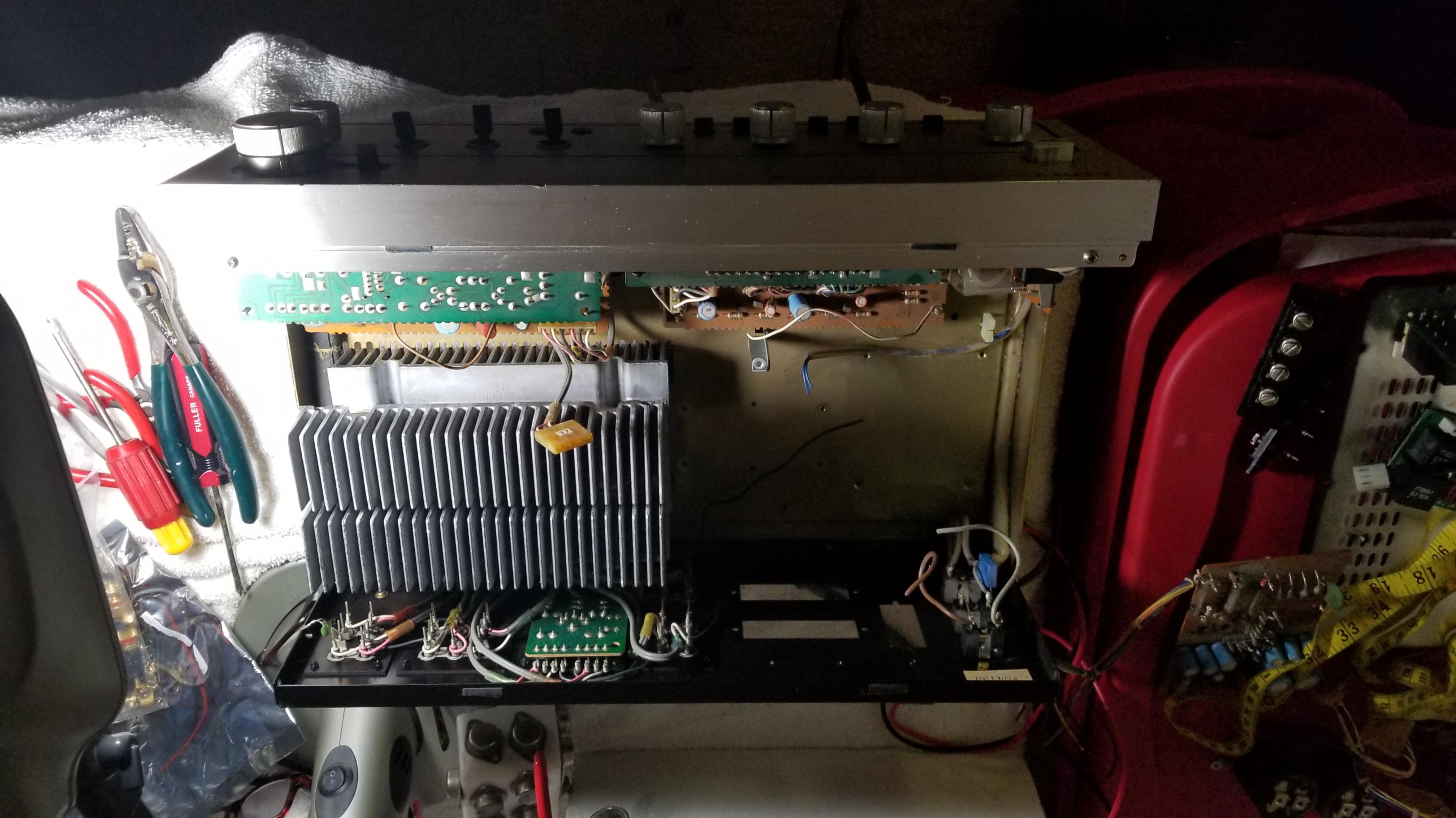

Still spitballing TA 4650 chassis. One heatsink per VFET card if necessary. Will try one heatsink first for both cards and measure Temperature. looks like room for cards and even internal SMPS power supply.
I guess I have a few months to conceptualize while auction feeding frenzies going on and before alternate cards become available.
I ordered small SMPS 20v PS to see if the preamp section will work with it.
Anyone have measurements on the actual size of the cards and VFET aluminum mounting bracket?

I think Sony TA 4650 chassis for this amp will work. I am going to commit myself to the concept over the next couple of months and strategize. I think the single heat sink will be OK dissipation for two channels, 20W class A, since heat sink was designed for 80-120 watt class AB, but will measure with T gun and alter strategy as necessary and add a heat sink/fan as necessary.
It also looks like there will be room for dual SMPS, one for each channel, a small smps for the preamp, volume knob and input section, and reasonable room for additional smoothing card and input cards. It already has an on/off input harness and switch selectors if necessary.
