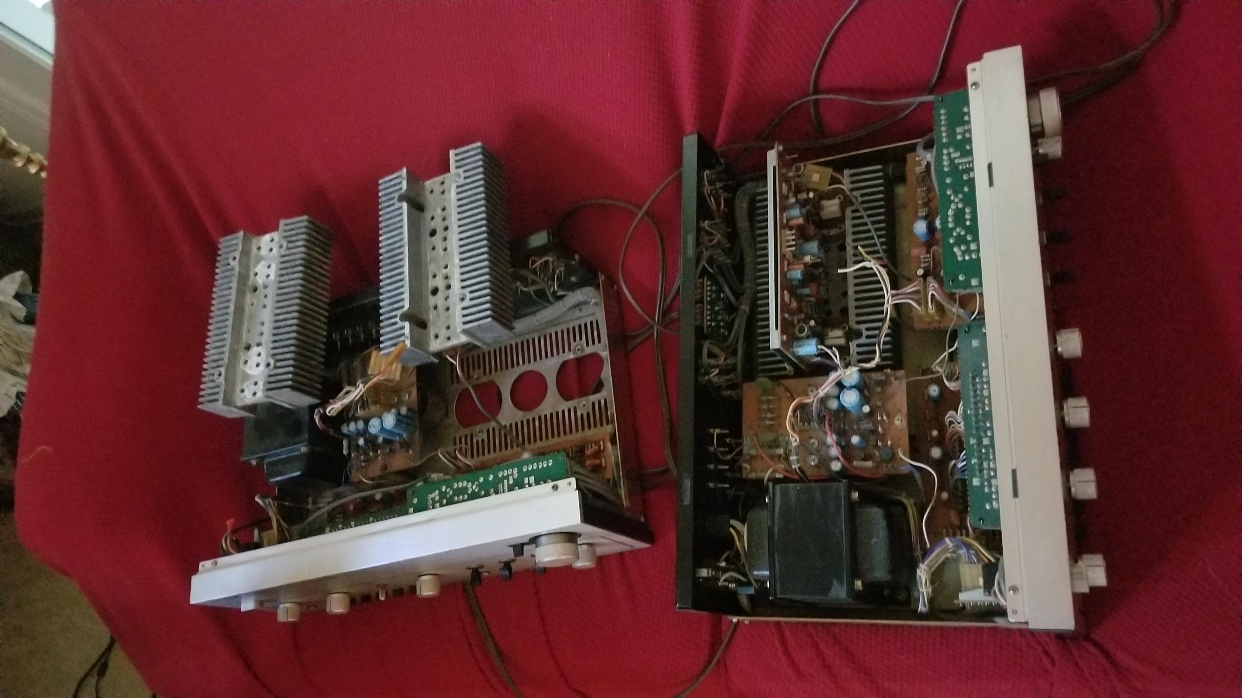

I also have a pair of heatsinks from a TA 8550. I went and took the 4650 apart. The heat sink is exactly the same as one channel of the TA 8550, which was designed for 120 watts class A/B. So, it should be OK for a total of 20 watts Class A.
There is also room for two of them for two channels of heatsink if necessary.
Power supply components should be re-built. I will just spit ball it for fun. Like I said, it's probably out of my class, but looks do-able for somebody with expertise.
I know some of the 4650 an 5650 had smaller heatsinks than others, but they eventually increased them.
Hmm. I have two 4650 chassis. One, the preamp works and only needs 20v rectified power supply and has separate inputs/output. The other chassis, nothing works. I have four heat sinks designed for 120W class A/B, so I can use two per chassis with one VFET/Mosfet pair per heat sink.
I am thinking strip out the transformer and the existing old power supply, which is too large anyway. That leaves lots of room for new PS and/or wall wart with smoothing circuits.
One chassis can use the existing preamp section into VFET board, upgrade speaker outputs.
Second chassis can be equipped with Korg B1 and VFET board if the first chassis works.
I think this can be done, and the facade will be vintage TA 4650, which would be cool and a nice tribute jalopy.

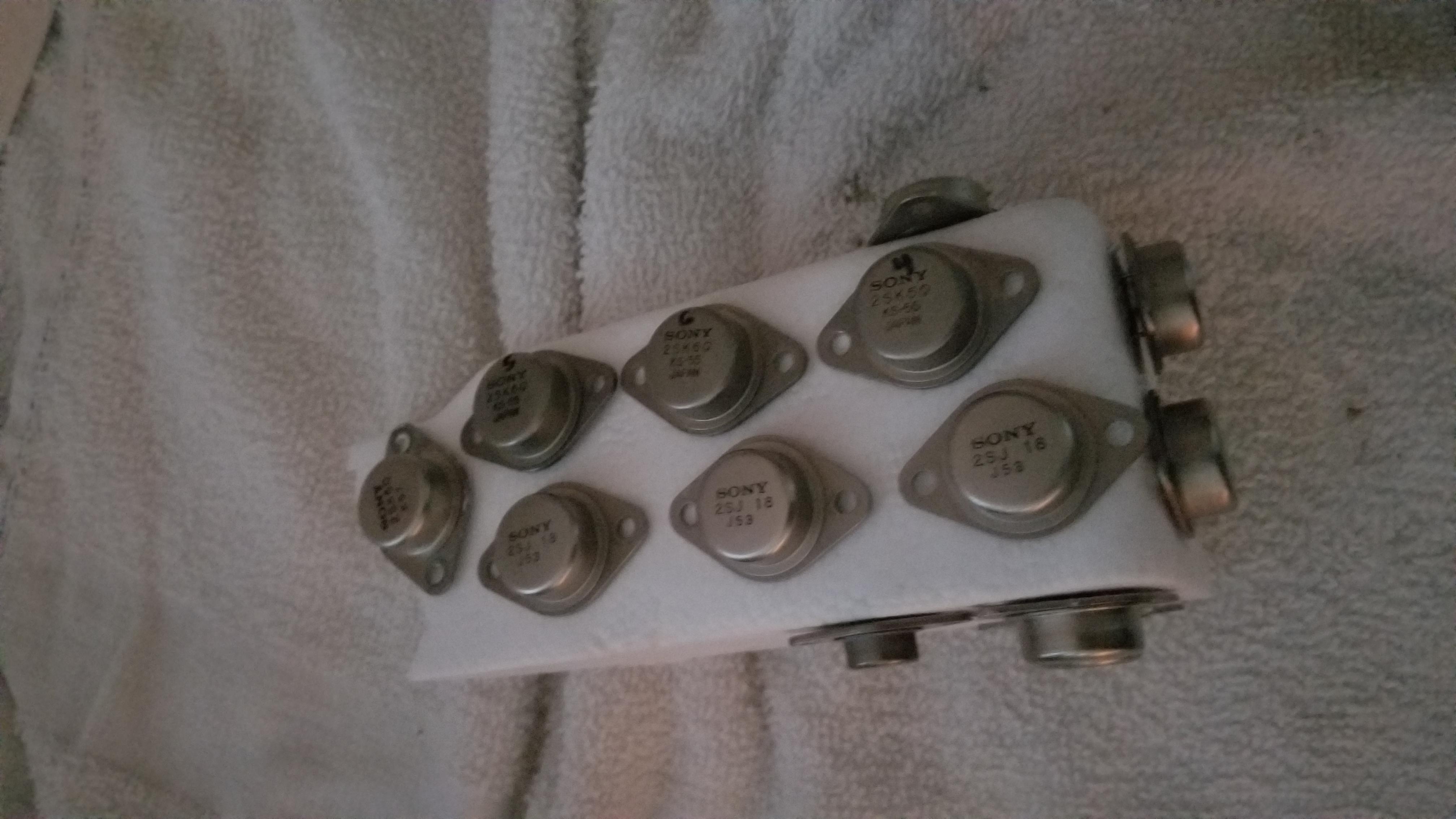

Guess I have to continue to study and wait for the boards that accommodate 2sk60 and 2sj18, of which I have several of each.

The 4650 heatsinks are designed to accommodate six VFET's each (2sk60/2sj18) in three pairs, as in the TA 8550, rated at 100W per channel class AB.Yeah, that's the same heat sink size my TA 4650 has. Compare to the size of each of the heat sinks of the DIY Sony VFET chassis, which I believe are Modushop 4U/300.
Regards, Claas
I am not sure about heat equivalencies, but I would imagine a heat sink OK for 100 watts AB would be OK for 20 watts class A and certainly for 10 watts class A.
DIY store chassis is beautiful. It does look like heat sinks are over size for the job. I suppose the question is what is sufficient rather than over size for 10 watts per channel class A.
Again, just spitballing so far, but I gutted the two chassis and am thinking about implementation and space usage. The working preamplifier in the one chassis sounds excellent when connected to headphones and has all the multiple inputs, and even tone controls from the olden days.
I believe the TA 4650 was the first commercial VFET amplifier sold. it would just be cool to have a PASS DIY sticker on the front with a working 10 watt Class A VFET amp inside.
