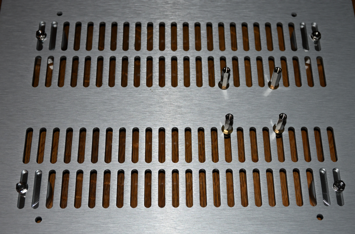

i have built 2 version of them , one with the Sony 2SK82 and Edcor 64ohm OT and the second with TOKIN 2SK182 and Tango FW50 Nemesis style.
the edcor version was not as good as all the other L'amp Vfets in fact i did'nt like it at all . the TANGO was fun sounds more like a beefy 300B SET . but the Tango OPTS are very hard to Find and very expensive.
but at the end if i had to rebuild one the IronAMP with hammond 193choke was my preferate . easy to build , half the power supply of the Lamp .
and the keeper is this last DIY SOnyVfet . it would be funny to go to a hifi store with it and say can i compare my Diy amp to your big dollars ones
