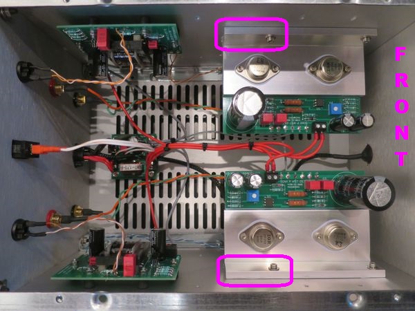

For builders who are considering possibly installing one or more of the other front end cards, I recommend that you plan to position your VFET sub-assembly on the heatsink exactly as member andreasw exhibited in post #1183 above.
Scourge, Bulwark, Marauder, and Dreadnought all have larger PCBs than the Toshiba JFET front end cards that were included in the kit. These other boards fit correctly on the UMS drilled heatsink when placed exactly where he shows.

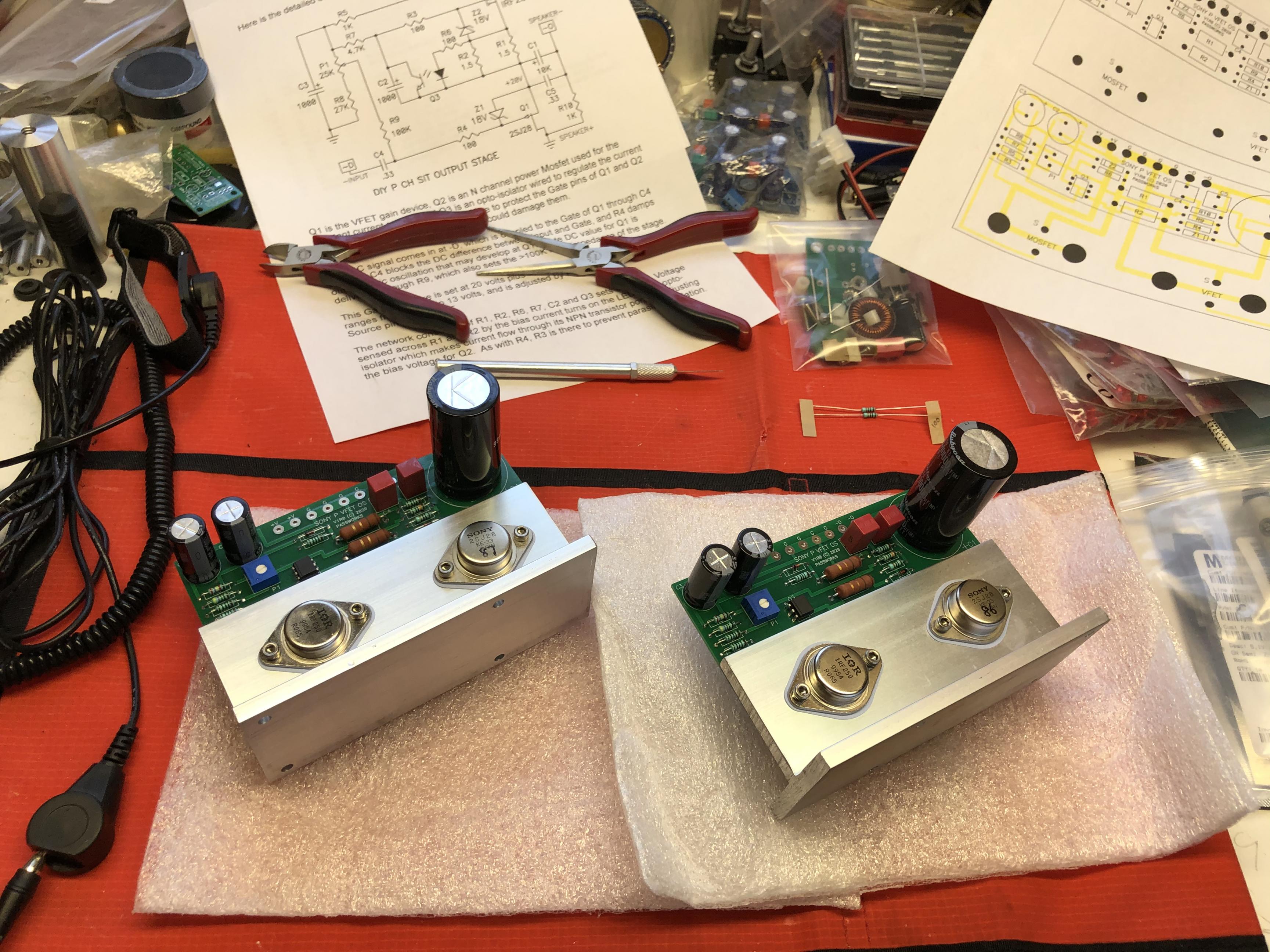

Actual progress...
Nothing here anyone hasn’t seen...still, its great for me given renovations and everything I’ve got going on.
This has actually been the most relaxing thing I’ve worked on in ages.
It got up to almost 90 F here yesterday and today, so I took some time off.
The whole concept of an “Amp in a box” is wonderful and brings me back to my childhood when I used to spend a bit of time in my parents basement building model airplanes and other projects during my summer vacation.
I probably won’t be done any time soon, but I’ll enjoy every minute of my “quiet time”

“Follow the plan”, got it. There could be additional input cards by the time round 3 comes out, later this year, which I hope to participate in. Thanks for the tip Mark.
There already are more front end cards. Some but not all of them have been shipped to reviewers for listening evaluation.
If we set aside people named Nelson or Mark, nobody else has built any of the first four (so far!). Accordingly there is no urgency to uncloak others. All in good time.

I’m interested in the Bulwark and Dreadnaught cards, but currently have another project entering final assembly.
I don't quite get this (maybe it's because I still have not received my parts kit, so I cannot look at the parts and boards...). What exactly are you trying to show with the purple rectangles? I don't see anything interesting there.
There is a (one) recommended way to position the OS boards, and that is "closest to the front panel".
Due to the heatsinks having several bores to attach them, there are though other ways to position the OS boards, more to the center. Some went this route for whetever reason they liked (supposed better heatspread, shorter wires etc.). Various combinations with the OS and also FE positionings are possible with the provided boards.
My understanding is Mark points that all this might be Ok with the provided boards, but the other FE boards he designed might not stick to the same form factor and hence should you want to try these tempting FE boards you might be limited unless you undo what you did if not positioning the OS boards correctly. Read some FE boards require more space.
Mark outlined in purpple the recommanded mountings of the OS board, which enable compatibility with current and presumably further developments as this positioning is the one that leaves the most space.
I hope this helps
Claude
