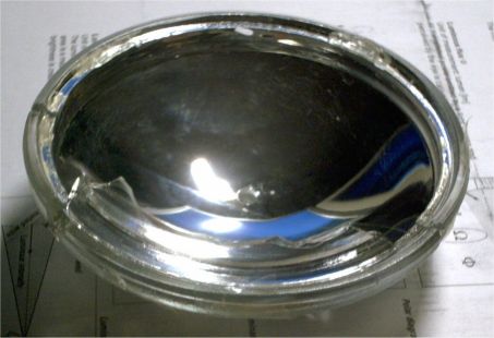

I got my chrome plated reflector. It looks so nice and really is a mirror finish. I don't have camera right now. WIll show u image by Friday and maybe we can see by then if it really can withstand high temperature. i will share with you the result in a few hours if it improve brightness.

chrome reflector brighter than my stainless steel reflector. ( Probably because the stainless reflector is much bigger)
The chrome is holding-up since my last post.

Why make a reflector when you can use a ready made ? This is the reflector from a PAR36 spotlight, it´s a perfect parabolic reflector and the surface is just as reflexive as a mirror and not heat sensitive. Just cut away the frontglass from the PAR36 and you get this perfect reflector. I just wanna show you before I throw away mine because I smashed mine with a hammer, not a good idea.

And for the chrome reflector, after using it for 4 hours, it cause bubbles about 5-10 mm in size.but its still very shiny. I will bring it back to plater to see if there is still anything that they can do to improve their process. I think its alot cheaper if this will work. Its look like some moisture is trapped between the chrome and reflector. Unfortunately i don't have a camera right now to show it to you.
Can anybody tell why my other stainless reflector is not affected by heat? My problem may be solved if I can find a smaller stainless steel reflector of this kind. It is shinier and thicker. This reflector cost only $3.

Use a silver one and you wont have a problem.
As for your chroming, i presume they acid dipped the laddel first for the chrome to stick? ( it could be gasses coming from the polish undeneith), if not its gas thats trapped undeneith the chrome thats causing so much presure from the heat that its causing it to lift.
Also chrome and stainless dont mix well together and it could be your very reason why its bubbling, chrome is meant to coat mild steel for show or as a protectant. chrome also chips very easily and it dont stick too well to anything.
If you want to use a soup laddel, get a sterling silver plated one.
Other stainless steal reflectors may not degrade with colour because of either the polish being used, the grade of the material upto the distance the lamp is being placed in the laddel.

I recall that i showed the plater two of my reflector for chroming and he chose the smaller one which he thought is just made of mild steel (I sanded it already because of too much yellowing). i insists that it is a stainless steel but he thought otherwise. He does'nt want to chrome the other stainless one( the one that is slightly yellowed and still shiny) and i did not ask him why. I thought since its for trial, he want to try it in a smaller reflector.
Hard chrome maybe the answer if want want to stick it hard to metal surface, but it will not be mirror finished. I am wondering why can it not be made mirror finished.
More then likley because it has zinc in it, it may also crack rather then bubble this time. Try it and give it a buff, you will be suprised how shinny you can make anything, yess even zinc.
When chroming anything or even painting anything that is made out of steel, you should always sand blast it and acid dip it, also a etching primer helps too. This etchant is a very strong mix of chemicals that actually eats into the metal and helps the paint/chrome or what have you bond to the material, powder coating uses this also though only on those items that require it. The more exspensive computer cases has this done hence the price and the paint on those dont come off nor chip.

Yess you could use that aslong as its not a flame oven and if you dont plan to eat out of it again due to poisons lol, bake it on with the bulb, its hot enough.
The teflon wont stop the bubbling, the bubbling is a problem under the chrome and thats why the reflector should be sand blasted and etched first, (so the chrome sticks). The teflon is an idea to coat uncoated surfaces like raw aluminium or stainless steel to stop the yellowing and discoulourisation.
