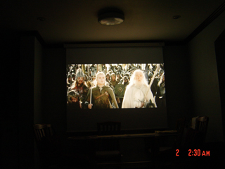

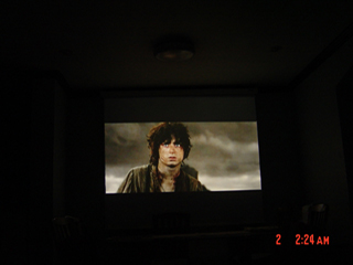

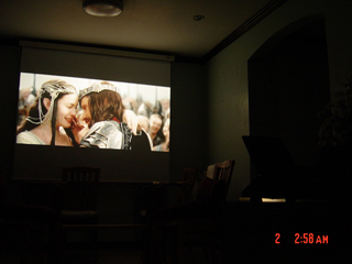

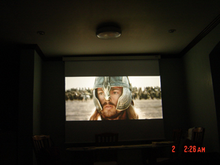

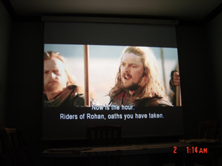

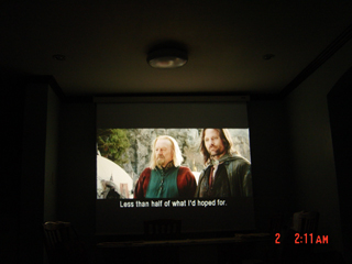

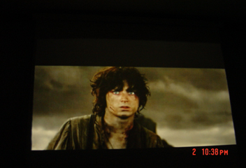

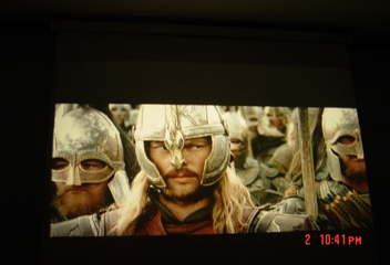

After a month of tweaking, I am now very happy with my results. Thank you guys from these forum who unselfishly shared their knowledge and experience.

It looks great, with very even light. How are u finding the 250w osram, is it bright enough?

I'm gonna take a closer shot next time
Osram 250w is very bright enough. No need to upgrade to 400w.
At the size of 70inches no, over 100inches u will lol, but that depends on your screen, mines as bright as the crt monitor i have at 100inches and thats on a light using screen, put it this way, paper is brighter lol.

wait, are u packing 400W then ace? and what do u mean by a light using screen?
golftdibrad said:looks like somebody is also showing off that they are cool enough to already have Return of the King.![]()
Very nice results, looks like a comercial pj

Looks Good Hertz.
Not yet but im thionking about it seriously, when u build somthing you build it right? well i like to have options as in screen size so im thinking about a 400w hqi-tsd, though not sure yet, just a thought, probally not worth it.
When i say light using screen, that means my screen absorbs more light then it ought to shine back at me, in return that means its crap! lol, paper is brighter then the screen im using.
