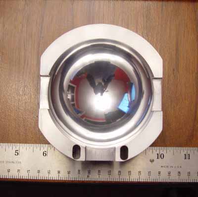

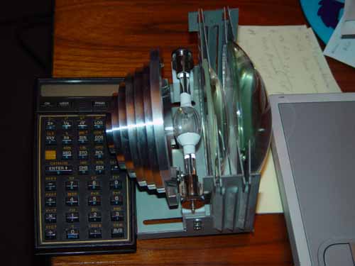

Why don't you guys use such a reflector?
hi, i'm not sure why your having problems with discoloration
of your stainless steel. maybe it is just a bad batch. most types
of ss should handle the heat without problems.
if your going to cnc your reflector, why not just use aluminum? it
is much easier to machine and works fine. i don't think you need
to get too caught up in high tech plating for this application. a nice
finish on aluminum is quite reflective. here are a couple pics of a
nice cnc reflector i have set up to use hmi de lamps.
all the best tony

I used to CnC some. Lots of fun. You make that tonydean?? Nice job. That done on a table top mill, upright industrial size? I was thinking of cnc lathing one, for a 2" bulb. But the stuff we had in high tech class at school was way outta my $$$ bracket to own. Looking for some used ones though and finding some good deals. Lucky for me my bro's a autocad engineer so he's still fresh up on useing them. Im a little rusty by now. Been about 3 years since I touched a CNC driven anything.😱

Yeah i got them, they arent bad, they handle heat no worries, well they should being pyrex lol
