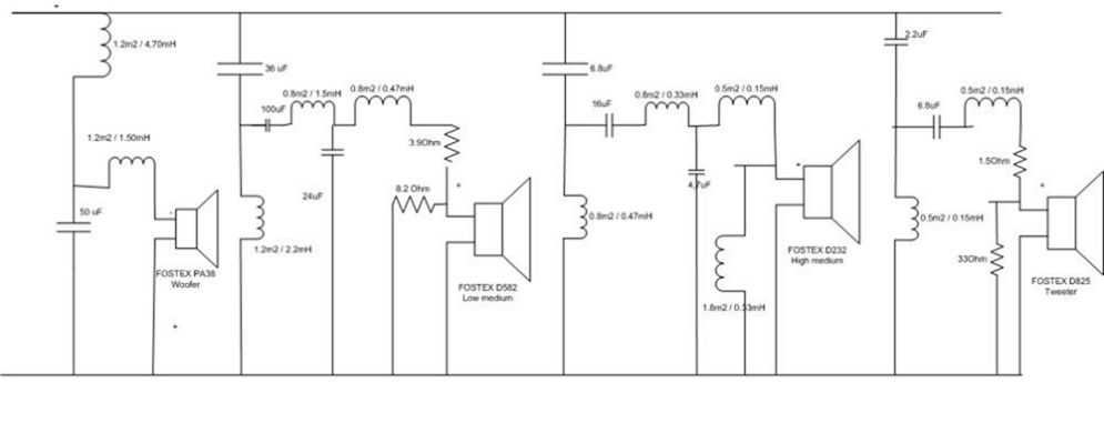

Next DIY loudspeakers will be a four ways based on fostex drivers (plan attached) at about 100db 1w/1m. Idea would be 4 way amplification. Now the question: suppose I use the Firstwatt. What would be advisable : four F3, four F2 (interesting the current drive for the speed) ? A mix of both (F2 for tweeter an high medium, and F3 for the bass and bass medium ?)

1) Neither. Both amplifiers are too different from the F1/F2 that
I don't think I can make that comparison for you.
2) I don't know. The F3 is the best all-round amplifier, but an
F1 will pump up the bottom typically, and the F2 is the fastest
thing I have on the top.

What would you set up for a four ways - just interesting to know. [no liability issues there... ;-) ] Pure matter of interest. You know your creations. Would it be wise to take some F1 / F2 for the bottom and F3 for medium high and high ? Just a pure matter of curiosity.

The issue was not so much to know which one is better, this is a matter of subjective taste and anyway F1 and F2 have a lot of THD compared to other models / brands.
What interested me was if you would consider that one model fits slightly better for this of that type of frequency range.
I understood from your answer F1 seem better driving the bass. I was wondering how about bass medium, medium and high.
From what I caught something like
F1 bass 20 - 200Hz
F2 (or F3 warmth) for bass medium and medium
F2 (fast) for tweeter (5khz - 35khz )
Only to understand the sonic caracteristics of each amps.
Additional comments will be helpfull and appreciated, but thanks anyway.
