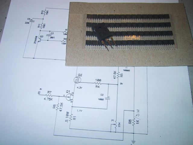

BTW Have a look at the size of those J-fet devices:bigeyes: They are pretty small indeed. There are 60 pcs on the pic, with a IRFP240 on top.
Steen😎

Blues, this is what I was planning on. (more or less at least) Its just some cut and paste work for now. The CCS is the one we used for the F2 clone and the capacitance multiplier is the Zen reg. without the zeners🙂 Nevermind the designations for now.
I will draw it in Eagle later on. I am looking forward to see if it has the slightest resemblance with the ZV9🙂
Steen😎
Edit. Be warned, the circuit on the schematic is not a tested design!
I guess that CCS can be modified to use IRFP240 or similar. Basically, that would be "copy-paste" of CCS from ZEN V2 with the regulator from ZV3.
However, I don't think that Nelson did just that. There may be something else...uhm....
....patience, patience....😎
