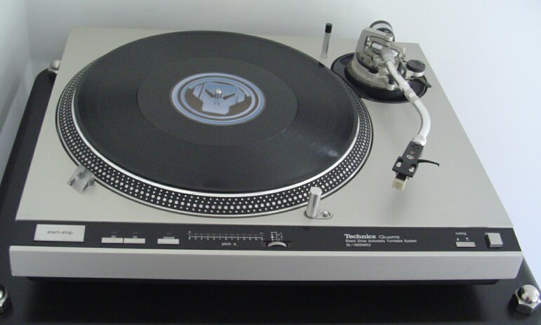

ebijma said:
Hello maxw
The vsps is should work fine with a Stanton 500.
Nice homepage by the way.
You did a good job on your gainclone.
Sorry to see you destroyed the looks of you turntable.
I have restored my SL1600 MKII to its original glory 😀
