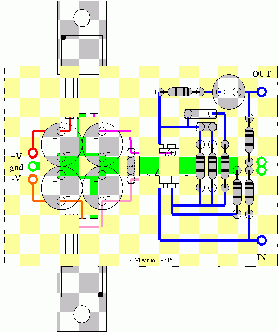

Oh, I see 🙂 huh well on the pcb the C1L and C2L are the same dimensions and the physical caps oddly are the same size too. I'm just using plain old Wima FKP2 caps... hopefully they are good enough... I printed out a physical sized board and matched all the parts I have to the board to make shure everything fits, the only parts I do not have are the Blackgate's which should show up soonish. I will upload a zip of my pcb and schematic (eagle) later on just in case anyone wants to tinker with it, outta time this morning 😀
Thanks a lot for clearing this up, rjm. The new layoutI mean like this. I'll upload it to the homepage shortly.
does make sense. You had me confused with the old one😉

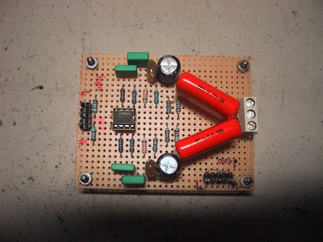

With all informations confirmed, I just finished and had a quick listen to the VSPS. Vima FKP3 for the RIAA. 4,7uF mkt for output caps (because I had some of those). OPA2132 opamp. Well, it played music right away, and sounds pretty good too 😎

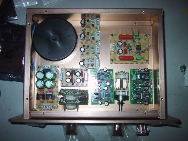

Yeah right😀 😀 Here is a mock-up of what it is intended for, in case you care to have a look.Looks like a rather sweet setup you have there.
Steen.🙂

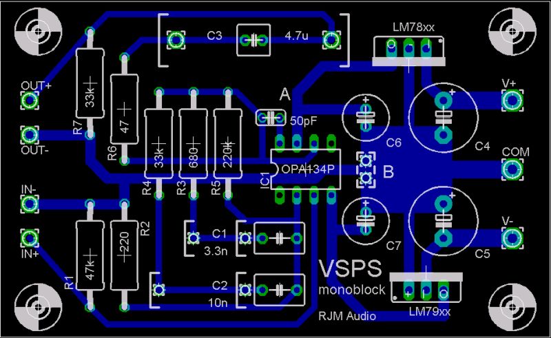

Also I would like to add a PCB I layed out and see what people have to say about it. 🙂
Naz, what about making the layout for single opamps and go dual mono as rjm suggested? You would then be able to use the OPA637😉 Also, if the railcaps were moved closer to the chip, the circuit might perform better! Just a thought.
Steen🙂

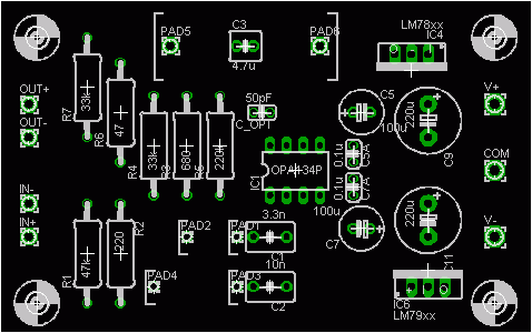

Well I did little more tinkering with the layout.. is it better? I'm trying for a compact pcb layout. I might try to do a dual mono setup this next week, but I'm going to try and build this one and see how it performs.
Naz
Naz
Naz, that looks good. Quite a compact layout. I did add a 100nF film cap after the ps electrolytics, might be worth it, if you could fit them in🙂

I built the VSPS REV.2 and when I tried it out it didn't seem to have enough gain. As I read over the old posts I saw that I had C1 and C2 reversed. What would this sound like? Could this be my trouble?

I have made the VSPS and built it into this preamp:
http://www.diyaudio.com/forums/showthread.php?threadid=55558
It sounds really good. Amazingly simple to build, I am quite impressed by the performance. Thanks RJM.

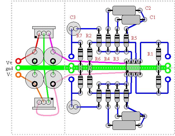

A possible layout for single op-amps might be like the suggestion below. Here, the op-amp is on the underside of the board.
I used to have this on the VSPS page, but removed it since it was confusing people. (What? Two layouts? Huh? Which one should I pick? U..g...) 🙄
