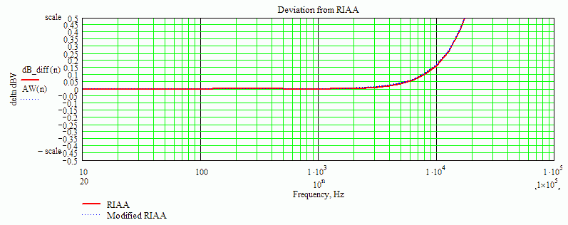

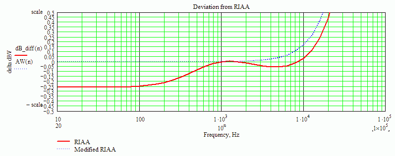

RIAA values pt 2
... and second the response for the following numbers
R2 220 ohms
R3 780 ohms
R4 33k ohms
R5 229.8k ohms
C1 3.2nF
C2 9.57nF
where I tweaked the values manually until the response converged on the modified RIAA.
-rjm
PS: the red curve labelled "RIAA" is the simulated VSPS. The dotted line "Modified RIAA" is the Allen Wright response I'm aiming for.

Thanks rjm!
The 2nd graph with modified RIAA values looks great minus the dip in the lower frequencies and around 5kHz from the 1st graph using the original values.
Is the difference noticable with listening?
Those graphs are 1dB full scale. The worst deviation on the first is only 0.25dB. So, no, honestly I doubt you'd hear a difference.
But, if you are selecting caps from a large lot, or have a wide range of precision resistors available, you might try choosing ones closer to the values from the second chart.
-r
