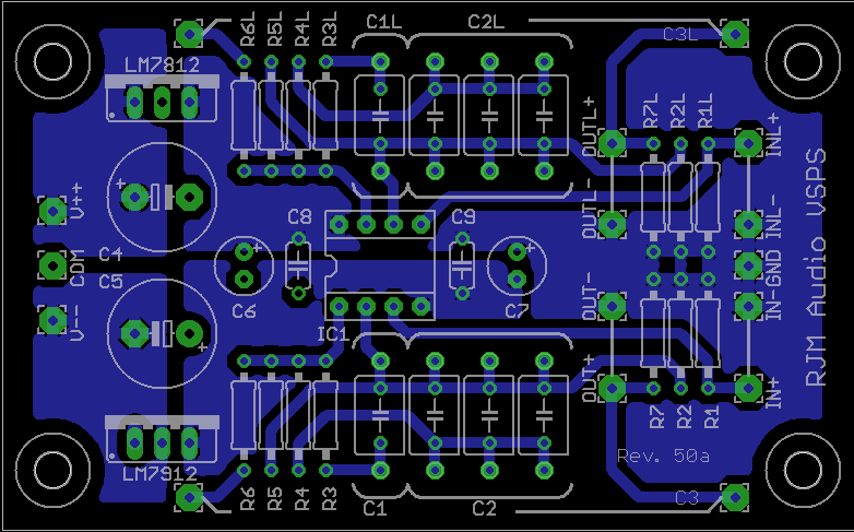

Hi RJW, just wondering if your single side board download file VSPS 45G is complete, I down loaded the file and all It shows is the black traces and pads is there another version I am new to electronics so please bear with me

answered elsewhere, but for future reference: In Eagle, press the ratsnest button to fill the polygonal traces.
VSPS rev. 50a
Eagle .brd file attached.
Changelog:
Changelog:
- Added thermal isolation of power and ground planes.
- Added optional C8, C9, 0.1 uF ceramic bypass caps for decoupling high-bandwidth op amps.
- Removed the alternate C3 cap mounting position to fit Black Gate NX. These caps were discontinued many years ago and are essentially no longer available.
Richard I was browsing today around the DCB1 sections and I found this topology diagram.
Since the cartridge output is inherently balanced, you think something similar could be done with 4 boards of VSPS or Phonoclone?

It's electrically feasible, but unlikely to be worth the expense and complexity.
Incidentally the noise for a balanced phono pre is 3dB higher than an unbalanced one. That's because each phase sees an input signal that is half the total cartridge output voltage.
