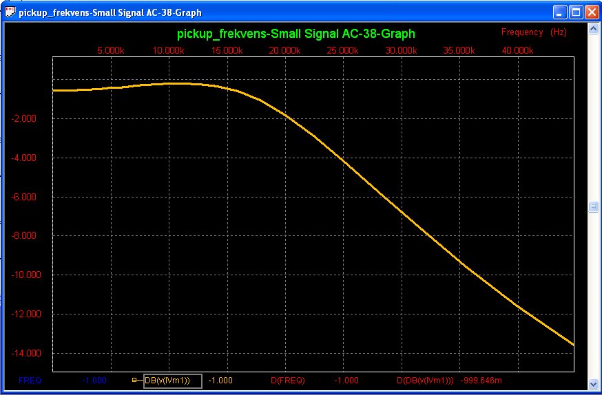

Today I also tested my new loadplug's. I have done a pair of 47k plugs as the load for the cartridge. I maybe will do some trim but today I saw (heard) the light so it will maybe take some time. 🙂
I tested a new cheap but allaround good cartridge today. An Audio Technica AT95E. Wow ! My old Pickering XSV3000 from the late 20's century had to go to rest. Now I have to listen to all my collections of vinyl again.

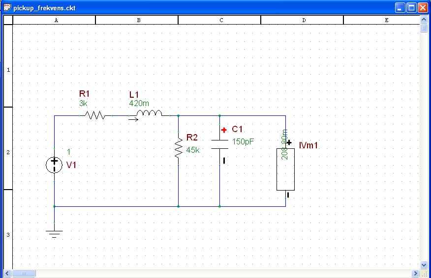

I have built an LCR meter kit from a genius in France that I have measured my cartridges with.
This new MM pickup measures 420mH and 3k ohm Z at 1khz. The specs say 2.8kohm and 400mH so they are near what they advertise. 🙂
I load it (with my plugs) to 45k ohm and 150pF. Cables from turntable gives 120Pf and input to OP amp is 30pF.
AT recommend a capacitive load of 100 - 200pF so I should do fine. And the result. I'm very pleased. It was OK before but with this new cartridge, even though it was cheap, is awesome 😀

Loading graph
Here is the expected frequency responce with my setup mentioned in my post above.
