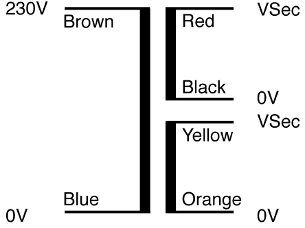

I'm building myself the VSPS, however I have a question about the power input.
Instead of the 3 pin XLR power jack, can I just a 2.1mm DC power jack instead?

remeron said:p.s. My knowledge on electronics only extends up to holding a soldering iron....
Indeed, and the website you are following is at the same level, without even a circuit diagram to help you know if it's right for you or not.
Unfortunately it's not, since the supply shown is a single supply rather than a split supply, with only two output wires not three.
For the VSPS you need a transformer with two output windings, and a connecter with at least three pins. It doesn't have to be an XLR of course, but that's the most common.

I've just bought the transformer toroidal, which is this one:
http://malaysia.rs-online.com/web/s...chProducts&searchTerm=223-8538&x=0&y=0#header
is this part that i bought at least correct, or did i just waste my money?

Lemme see if i got this right.....below is the schematics of the toroidal that i bought:
Basically, since the VSPS needs a 12-0-12 rails...
Everything on the PS website (http://www.rock-grotto.co.uk/easyxpsu.htm) applies EXCEPT the out put part from the toroidal.
So instead of 2 outputs like the ones on the site, I need to do a 3 output.
Which means the red, yellow and combined black+orange and this would give me a 12-0-12 rail output. Is that right?

As i was saying previously...the layout is the same as the website i mentioned, however the out from the toroidal needs to be connected to a rectifying diode and that would give me a 12-0-12 railing
(as per diagram on the VSPS page).
am i correct?

rjm said:Relax, that transformer will be perfect.
Thanks... 🙂
Anyway...could you help me out about the toroidal output?
So far I gather,
the Black + Orange combined to give me 0
The Red and Yellow would go into a ?bridge rectifier diode.
Is that ok?
