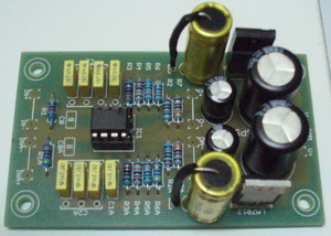

sombody said he paid just 15 dollar for all the components
i only searched for 2 c,s and the were 16 dollar a piece
check out http://skycoral.com/?p=78 the guy will sell the components + pcb for 20 dollars delivered (its not advertised anywhere but I asked him). he has a good rating on ebay: akita.skycoral
this does not include the sockets however.
That's a very nice deal.
Considering the amount of work involved in putting together a complete set of parts, I'd say it's an absolute bargain, and I encourage Akita to increase his prices so he properly compensates himself for the effort. (Right now I would guess he's selling at cost.) Most people would be happy to pay twice what he's asking, just for the convenience alone, even if the parts are all standard grade.
His price on the bare PCBs is also so low that I suspect his profit margin is basically zero. If he's paying anything like Olimex pricing for the boards, I know it is for a fact.
If anyone is planning on building the stereo VSPS, then I strongly recommend paying the $12 or whatever it is and getting a set of PCBs to work with, rather than trying to do it point-to-point. Working from PCBs is so much faster and easier.
/rjm
P.S. I also think he should advertise more. I'm attaching his photo of the completed board in the spirit of attracting some business for him.
/rjm
