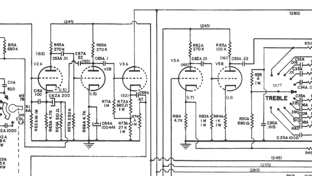

As far as I know the only model 7 preamps Marantz made were the 7C (tube) and the 7T (SS). The 7C used all (5) 12AX7s. What's the connection to Marantz?
Here's a section of the 7C schematic. I'm not very technically oriented but it doesn't look the same to me.

I guess our newest member is from the oriental land, citizens of planet audio in that part of the world is still raving about the Marantz model 7c or "M7" as they call it. The model 7C and the model 9B power amp still command some handsome money in the second hand market. They seem to really enjoy that mellow mid range of the said preamp. Many in the DIY community have gone all the trouble to "optimise" the circuit with difference tubes and resistor/capacitor value, whether the resulting circuit and tone has any resemblance to the original Marantz model 7C is questionable.
I built one using the a very similar circuit, 3 12ax7 and some cheap components, extremely high gain for modern power amp but mate wonderfully with big MOFO by Michael Rothacher which has no gain. I can understand why audiophile in Asia like it so much, the mid range is very sweet indeed one can almost tastes it.
When they say M7 circuit, they actually mean the output section of the model 7C without the RIAA and tone circuit. What you've posted is the the RIAA and the first 2 stages of the output section. Here is the full model 7C circuit:

The amps circuit is the same as the 7C.Here's a section of the 7C schematic.
Since i improved the power supply , input, output circuit & the output tube, it not exactly the 7C.
So i named it as M7. M is stand for Marantz.
