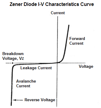

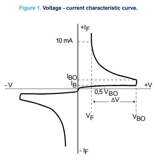

Let's think a little more about Jhstewart9's consideration. I attach the I / V curve of a Zener and the DB3 diac. Why is a Zener a good protection to avoid output spikes, while the DB3 Diac is not?
the DIAC will still allow large enough transients that the inputs of some amplifiers will be damaged. It's a poor choice. A relay with a simple time delay transistor arrangement would be far better and can easily be implemented.
The diac DB3 is a pulse shaper part, very useful to trigger triacs. See the I/V diagram at post #35 from the DB3 datasheet. When the voltage increses beyond Vbo, it forces very rapidly the voltage between the terminals at the new value Vf. This will create a narrow pulse with delta V amplitude. The zener diode does not have this behaviour. If both positive and negative pulses need to be limited, two of them are needed. The zener value should be carefully selected to avoid any clipping at normal operating voltages. As Linwendil said, a time delay relay would be the optimal solution here.
That DB3 clipping is exactly what I want, as its output voltage is under 28V when it is under normal operation (2V RMS). When the output voltage appears to be 28V, the voltage level is almost to the power amplifier input damage level. So the clipping serves its most useful function as to decrease the voltage, while the zener keeps the voltage into a dangerous level which is I don't hope to. 🙂
