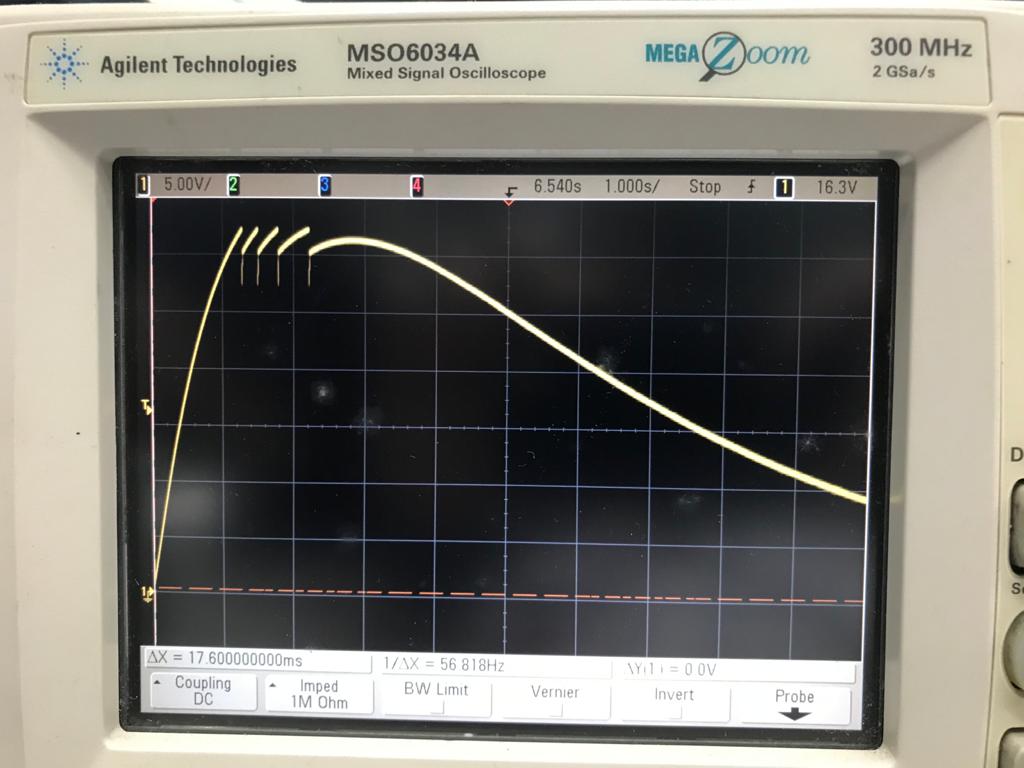

Have you tested your diac-based protection with a oscilloscope?
I have observed it with an oscilloscope
What is the observed 'it thing' you observed?
Shew us what it looks like coming out of your amplifier as it operates on an overload signal. Most of us know what a DIAC does & what the signal looks like during normal operation in its intended circuits.🙄
The breakover voltage of the DB3 is given as 28-36 volts on the Spec Sheet. So if exceeded a step of that size would be applied to the gain control. Depending on the gain control setting a step function goes to whatever speaker system is connected. Could be damage.😱
Here attached with the waveform. You could observe that there are 4 protections at the output after the start-up time.
As I mentioned before, this DB3 does not serve as a protection to speakers. Instead, it protects the input. However, DB3 certainly could also protect the speakers to some extent as the peak maximum is around peak-to-peak 5V at protection moment. I believe it is much better than you add nothing as at least the voltage could be kept under 30V.

That's a interesting circuit. If I correctly understood your measurement, the input of the power amplifier does see 4 narrow pulses with 5V peak-to-peak amplitude, clustered in a 20ms window. That's a step forward compared to the situation without the DB3 diac, because I've seen 35V rated coupling capacitor at the input of many chip amps, and they may be damaged if some protection is missing. But I think that the goal should be to also remove those spikes. Could you do a little further test? Try connecting a 24V zener diode in parallel to the DB3 diode. Measure the output with and without the DB3.

Your suggestions is actually not necessary to be carried out as all of us understand well that this is a straight line. As what I have mentioned before, if you do not satisfy with the over-voltage, you could choose a zener with lower voltage instead. For the reason why I did not use a zener is that there is a hidden problem when using zener. Protect a circuit, the very basic function is to protect itself. However the zener current is too low(around 100mA), for DB3 which is around 2A. That is 20 times larger than zener's. Zener would be much easier to be damaged at the protection moment. Therefore, choosing a DB3 is simple and enough.
If you really hope to decrease the voltage, I suggest "TVS". 😉
