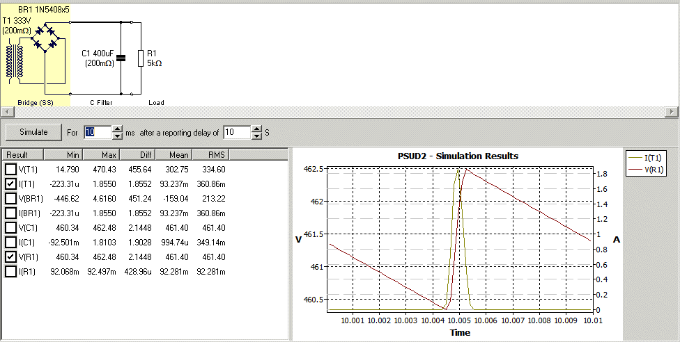

Everybody says that. But do math. The rms actually goes *down* when we super-size the cap... the worst-case is an undersize cap such as in plating or welding.
source 333V(0.2r)
Load 5k
4ufd 400VDC 140pp (35%) 7Apk 1Arms
40ufd 460VDC 20pp (5%) 6.5Apk 0.8Arms
400ufd 470VDC 2.4pp (0.5%) 3.5Apk 0.5Arms

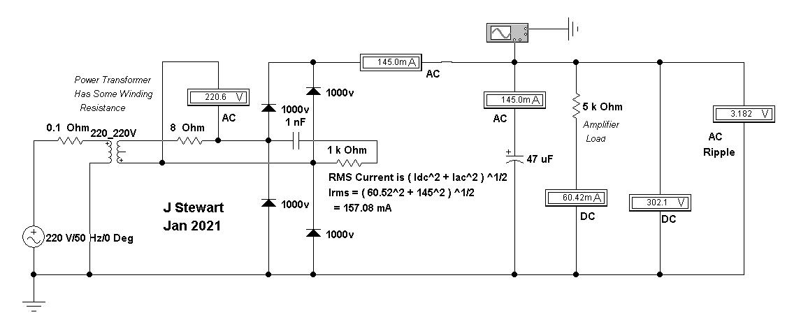

PRR, Can you increase R2 (8ohm)Between the transformer and the diode,Do simulation test once again ?😀

What simulator was used in post 67?

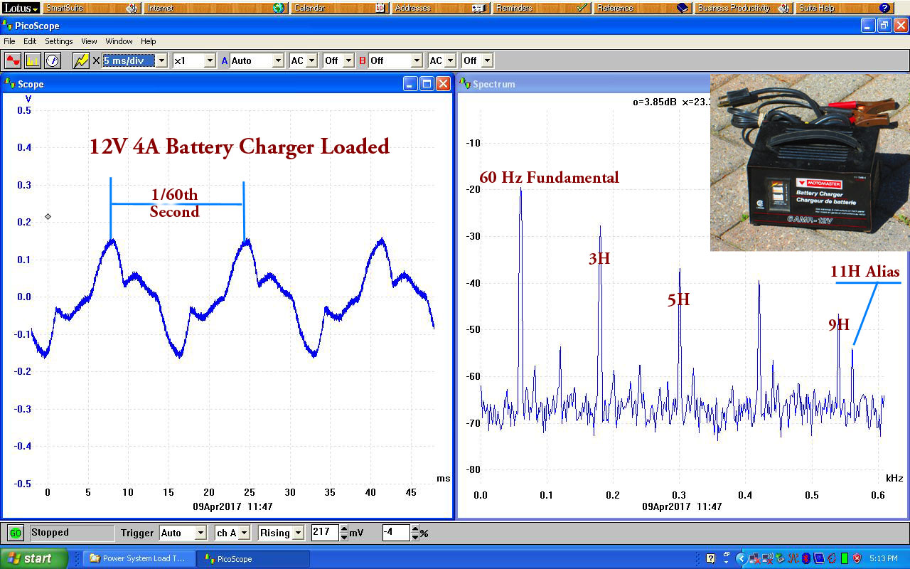

Referring to Figure 30.8 on page 1175 of RDH4 we can see that the RMS current could easily get to 5X the DC current. Total of the resistance/impedance of the source makes a large difference in the result. Adding some extra R in series with the rectifiers reduces the RMS/DC ratio.🙂
A good example were the source impedance is increased in the design is a common automotive battery charger. Build in some leakage reactance, problem solved.

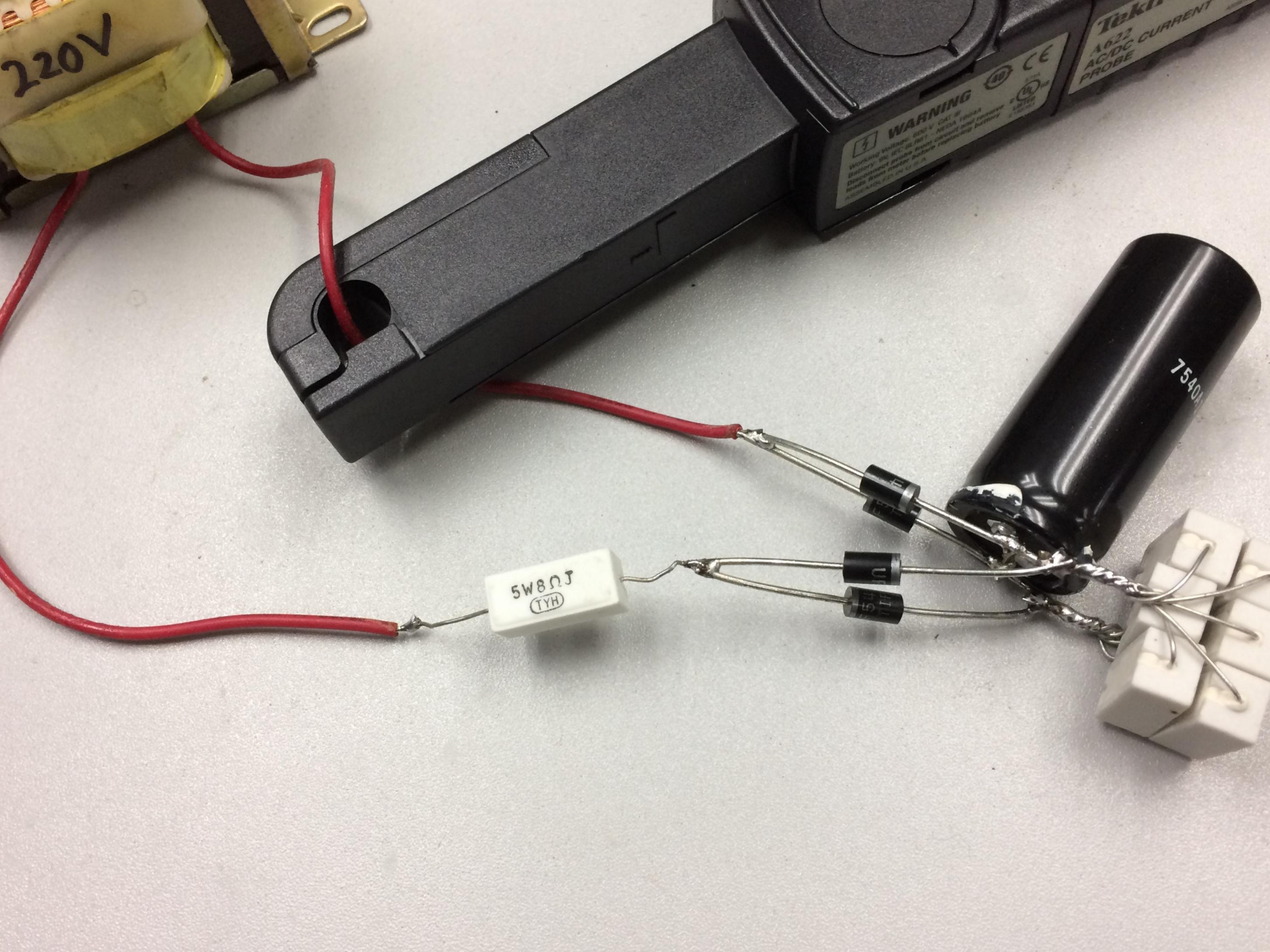

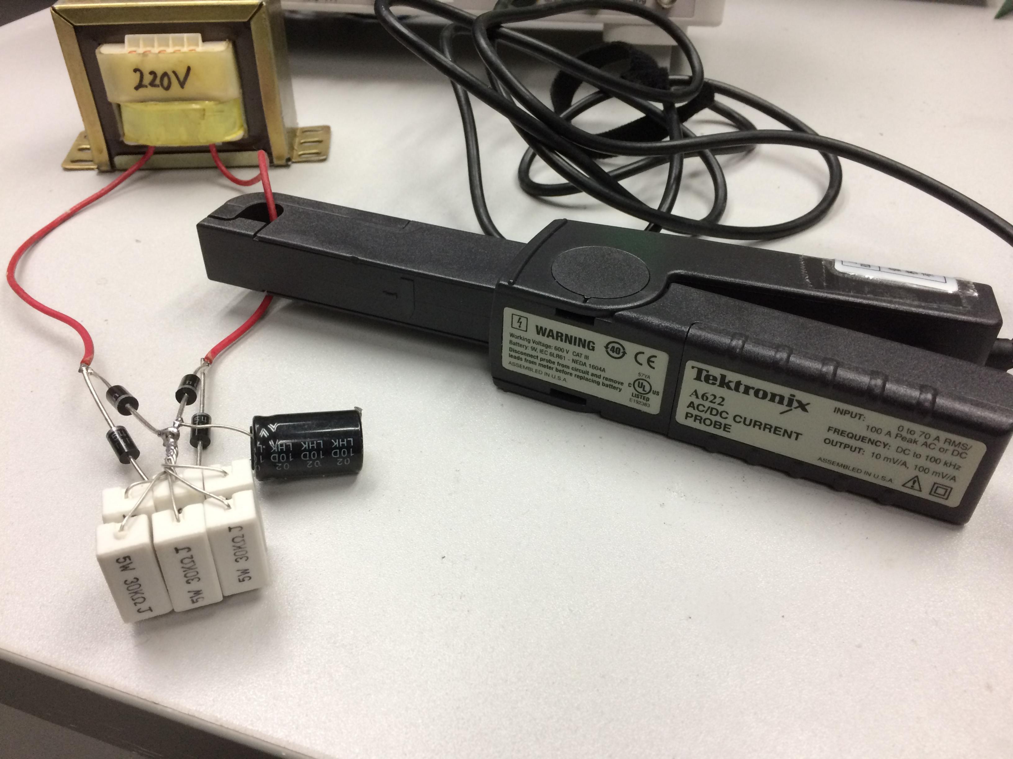

I used PRR circuit diagram for a real test, The test results are as follows, I just record the most interesting peak A,
source 220V ac
Load 5K
4,7uF 1.2A peak
47uF 0.84A peak
470uF 0.65A peak
470uF + 8 ohm 0.42peak

AudioGANG,

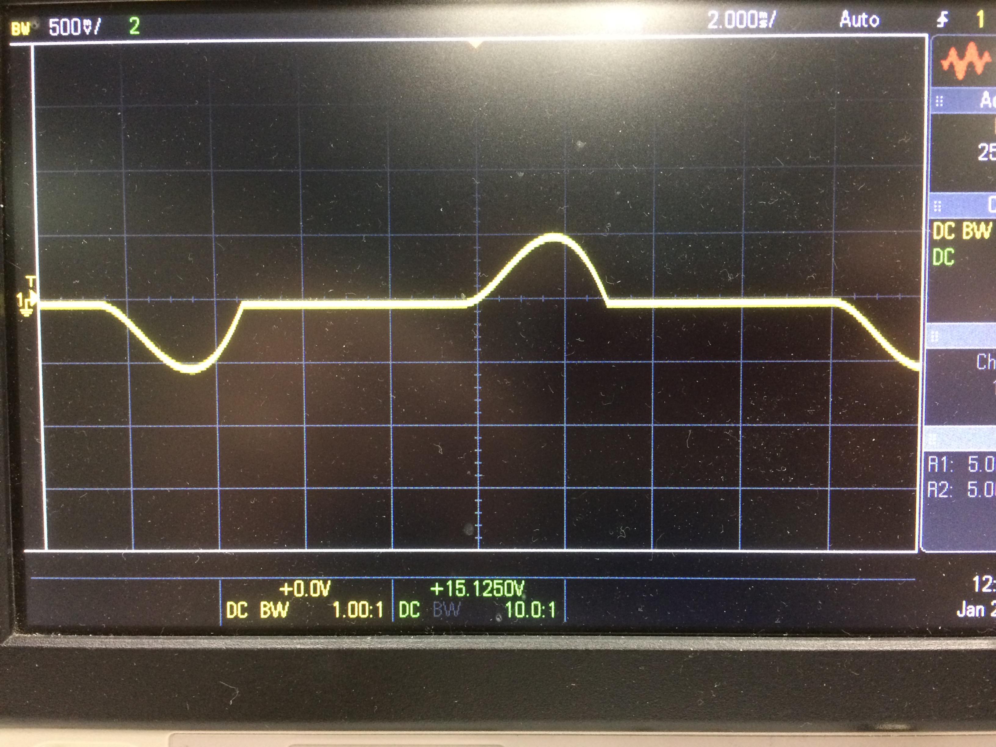

Thanks for using a DC/AC current probe to do that measurement.
That scope trace is a wonderful training aid.
An analysis of the integral of Current-Squared (I-squared) will cause it to become apparent that the peak current is many times the average current that the capacitors can supply over time (over 360 degrees of the sine wave). The transient current is only for a few degrees of each alternation.
Therefore, the extremely large transient current, and the integral of I-squared times the winding DCR of the transformer secondary will heat it. Also, that transient load current on the primary winding DCR will heat it too.
If you change the filter to choke input (L then C), the current will be spread over a much larger number of degrees of each alternation. That means the I-squared current is lower, and the DCR of the secondary and DCR of the primary will have less heat loss (I-squared x R).
Of course, the cap input filter can output up to 1.414 times the secondary rms voltage (Well, we have to subtract the diodes voltage losses from that).
And, the choke input filter can only output up to 0.9 times the secondary rms voltage (Well, we have to subtract the diodes voltage losses, and the choke's DCR losses from that).
We may get back a little of that voltage, because there are less volts lost in the transformers secondary DCR and the primary DCR, because the peak current is much lower.
To get the choke input filter to work correctly we have to calculate and use an inductance equal to, or larger than the critical inductance.
If you get a chance, do the same experiment with a choke input filter, and the current probe and scope.
Be sure to reduce the 5k resistor to get the same load current. 5k x 0.9/1.414 = 3,182 Ohms gets close to the same load current, due to the reduced voltage to the load of the choke input filter.

Post back the result pictures.

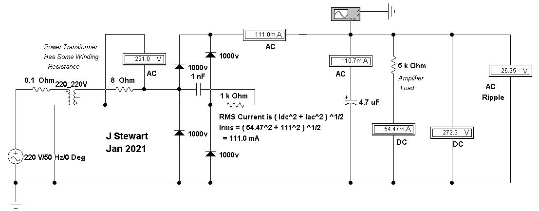

Your results are not complete, the winding resistance of the primary & secondary of the transformer needs to be included. Check the list on Image #1 on Post 69.
Then calculate the RMS value of the current. That is the part that causes much heating in transformers.🙂
