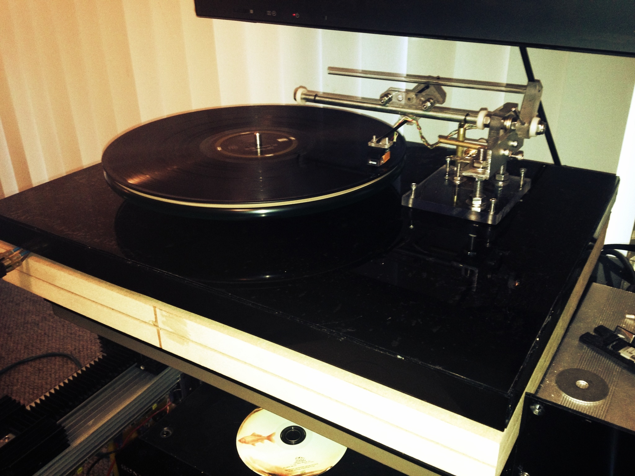

Just in the process right now of finishing a turntable. The motor is isolated on a lower portion, it uses easy to work with mdf in constrained layer, but uses very acoustically inert floor tile as the sandwich.!the upper plinth which contains the platter bearing and arm is isolated with rubber grommets from the lower half, results so far are no less than superb thus far. No acrylic platter happening here, as I have been using a superb cork/foam hybrid mat which I've used religiously for the last two years.

Marra, 10mm is fine for the arm base and counterweight material. ultimately you can use whatever you wish, but for the carriage mass is important, I had used 1/4" for the headshell but went back to 1/8" due to the ability to shave off a couple of grams.

Have secured some length of 16mm borosilicate glass tubing for bearing race. It seems to be bigger than your design but I don't think it will be a problem as it is not a moving mass. Correct me if I am wrong though.
Now to the hobby store to get some bearings and the hardware store for the rest of the pieces. ;-) If I am lucky can have one built before I head to FloydFest this week.

To recap and see if I am following this, the vertical bearing consists of the 4 ball bearing outer races sliding on the glass rod?? Also the mass of the entire assembly moves and rotates on the glass rod when it moves in the vertical axis?
Also, I am unclear on what was said about tracking warped records?
Pretty sure I read that it does well on off center records, but have you looked at the stylus carefully for horizontal offset under these conditions?

PS a light smear of silicone or a suitable oil on the glass rod might further reduce the sliding friction of the vertical axis - if this is how it is operating.
If you consider how this "bearing" operates - or any bearing for that matter - initially any vertical force will be generated via pressure on the stylus. So, the stylus will deflect first, until it overcomes both the moving mass plus the friction inherent in the bearing. The additional friction in the bearing adds to the effective mass, and increases the force required to move the assembly. Then the assembly may well overshoot... the other half of this is depending on the stiffness/compliance of the particular cartridge, so the cantilever could well get "buried" before the arm assembly overcomes the threshold required for vertical motion. For stiffer higher tracking force cartridges, it might not be an obvious issue (A Denon DL-103 might be an example), but for lighter tracking, high compliance cartridges it could be a critical problem. Just thinking out loud.
EDIT: also occurred to me that most ball bearing assemblies have some slop between the inner race and the outer, meaning that if you place a shaft in the center and hold the outer solidly, the shaft can be made to wiggle a bit. So, to some degree you get more or less a point contact bearing in that axis of rotation. Of course that is limited, maybe even a degree or less, but sent out the length of the arm, that *might* be sufficient to provide enough motion in the vertical axis to track a flat LP. IF this is taking place then you end up with a bearing that has essentially two thresholds, one that is essentially nil friction, and then another after a teeny bit of motion that is much higher in friction... another random thought. Fwiw.
