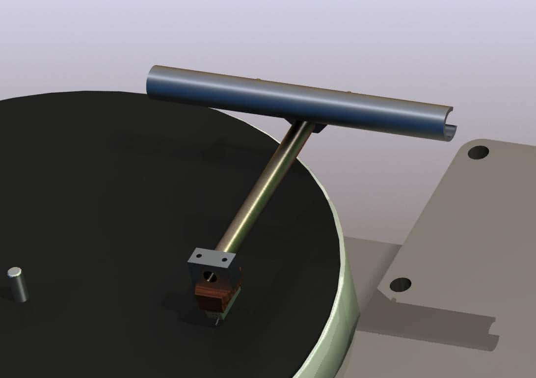

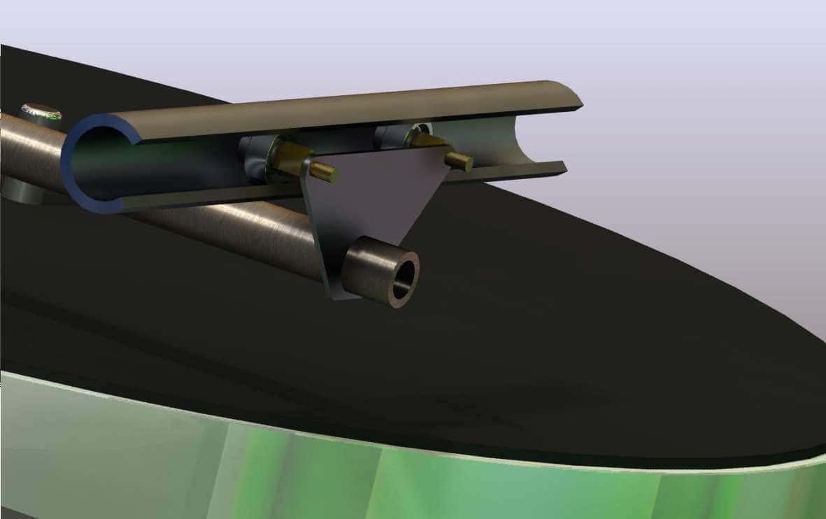

The convex shape must allow for free movement along the vertical plane. For a design where the carriage rides on the outside of the running tube, one could mount the tube to the main pillar using another roller bearing (such as larger version of those the carriage rolls on). This would theoretically allow free vertical travel of the arm wand and perhaps improve performance for higher compliance carts.
Isn't the convex shape to keep a fixed pivot point in the vertical plane for tracking warps? If they used flat edged bearings the whole assembly would rock front front edge to back as it tracked warps making it much less sensitive to warps and adding lots of noise as the flat surface of the bearing slammed into the runner.

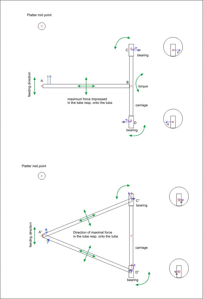

I´m no mechanical expert, but my guts feeling tells me that a framework carriage like the one shown in #93 should be advantageous over a single arm tube like in #105.
Reasoning:
The feeding force echibited by the stylus (not accounting for the perpendicular to this dragging pull due to the table´s spinning) at point A is orientated perpendicular to the single arm tube, thus exhibiting maximum torque on the midpoint B of a straight line spanning between the two bearings. Also the bending forces on the tube are maximal.
Assumed an infinitely stiff armtube/carriage this torque is translated into forces acting on the bearings parallel to the arm tube and in opposite directions at points C and D. This would push the bearings against the glass tubes wall, thereby lifting them slightly (due to the tubes shape).
Thereby it´d generate a small force in parallel to the glass tube, which then results in a movement of the bearings along the glass tubes length axis.
But most of the torque will be wasted to drive the bearing ´up the wall´.
With the framework as in #93 the bending stress within the two tubes or ribs is lower because not only will the feeding force been shared between the ribs but also will the force component perpendicular to the ribs be smaller.
The bearings will experience a force component immediately pushing in the glass tubes direction. The wasted force component pressing the bearings against the glass wand will be smaller.
I think this applies under the assumption that the points B and B" are kind of fixed, due to mass inertia of the carriage. I don´t know up to which extent this assumption holds and to which extent the assumption fails due to the moveability of points B resp. B".
If it applies, the conclusion would be that the bearings distance of the carriage for a single arm tube should be lower for higher force along the glass tube, while the conditions for a framework would be the opposite --> larger distance between the bearings.
The above lend me to the idea if it weren´t advantageous to use a flexible joint between a single arm tube and the carriage instead of a fixed one?
Is that reasonable, or am I thinking utter rubbish here?

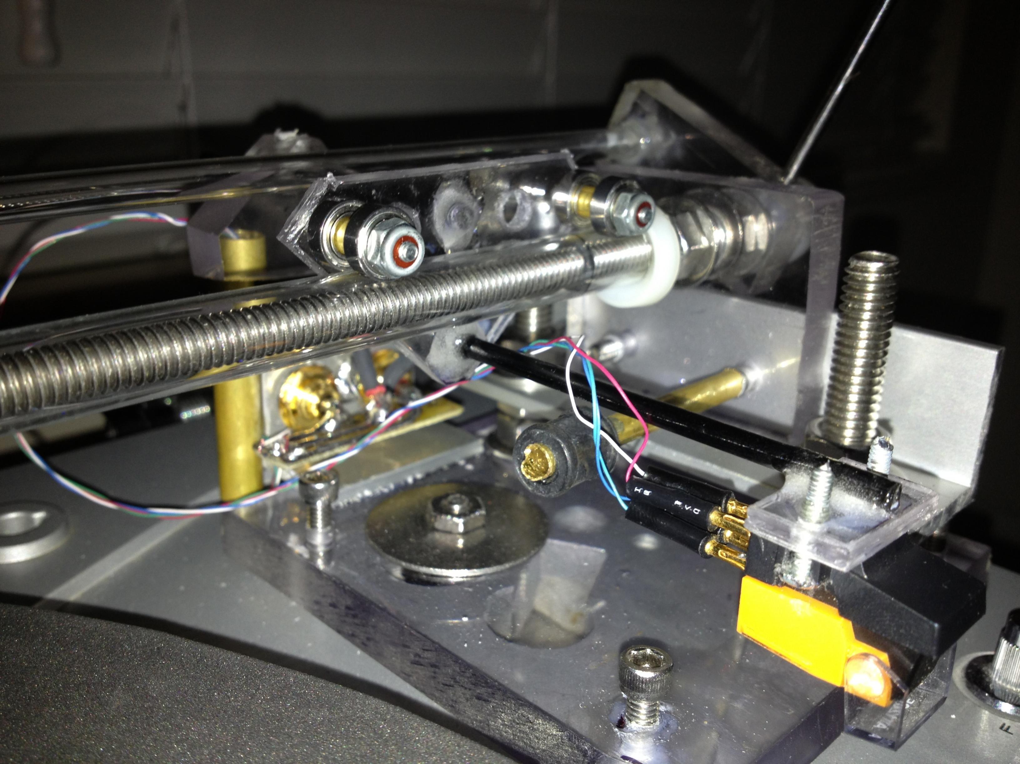

Colin, what kind of "glass tube" are you using?
Slowmotion,
It's a borosilicate glass tube used for lab pipettes, glasswork, I just used a new 10ml pipette and cut it up. You can also get stock glass tube.
To add to the arm trials, this last carriage is the one that beats all of them, wow, vinyl playback sounds open, dynamic, and imaging to die for!!
Colin

How are you cutting the glass tube without damage ...?
Jamikl,
I've seen the u bearings, but decided to go with the four bearing arrangement since as the way it's laid out promises lowest friction and no yaw.
Resonance is low, this is shown by ultra low surface noise, and tapping the plinth which gives a deadened thump.
Cutting the glass tube:I used a file to score a line into the glass completely around the tube, then it just snaps clean.
Colin
Colin
Last carbon fiber carriage, 18.0grams with counterweight with no cartridge, 24.5 grams with cartridge, I'd say its about as good as it gets.
