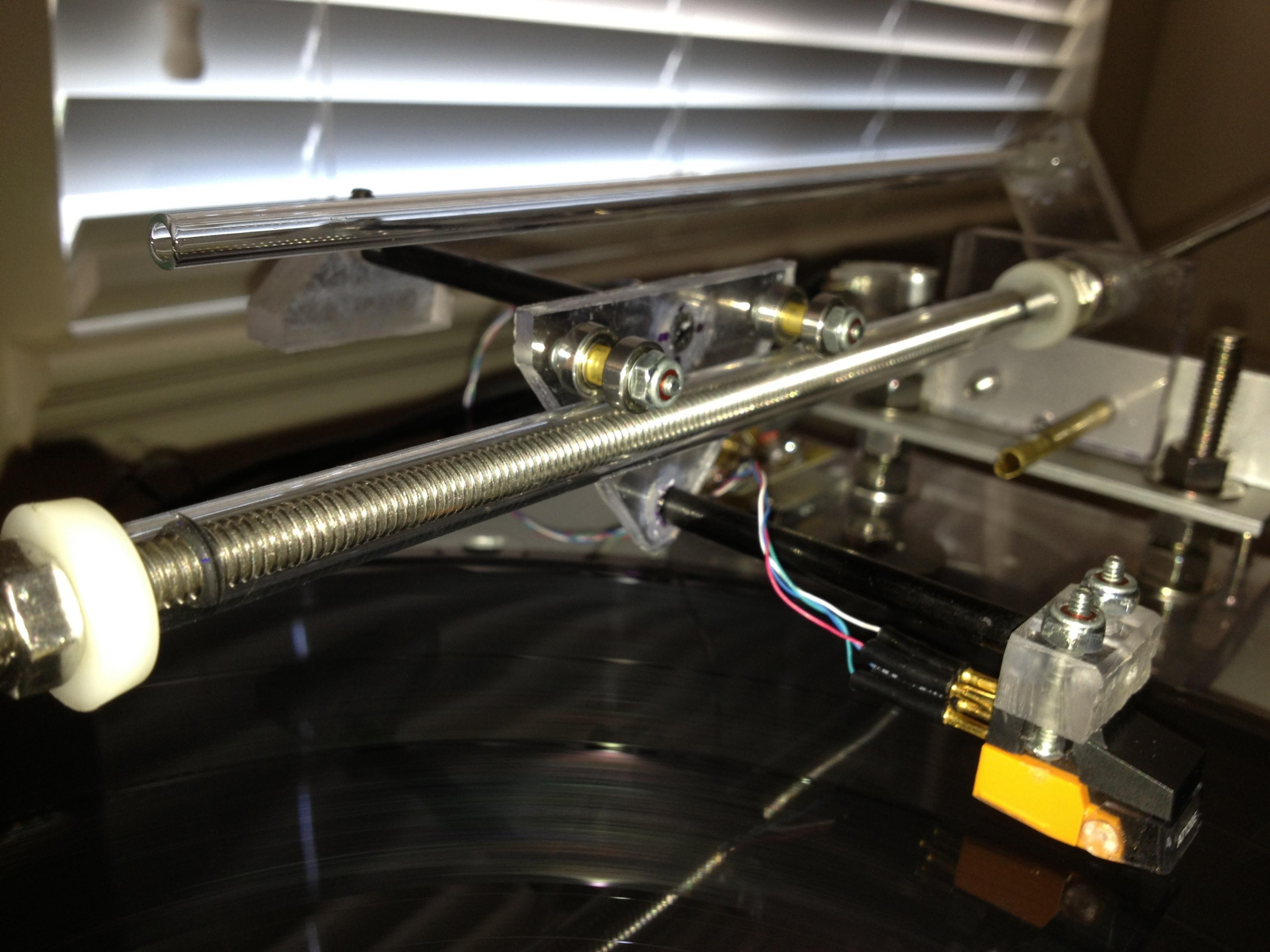

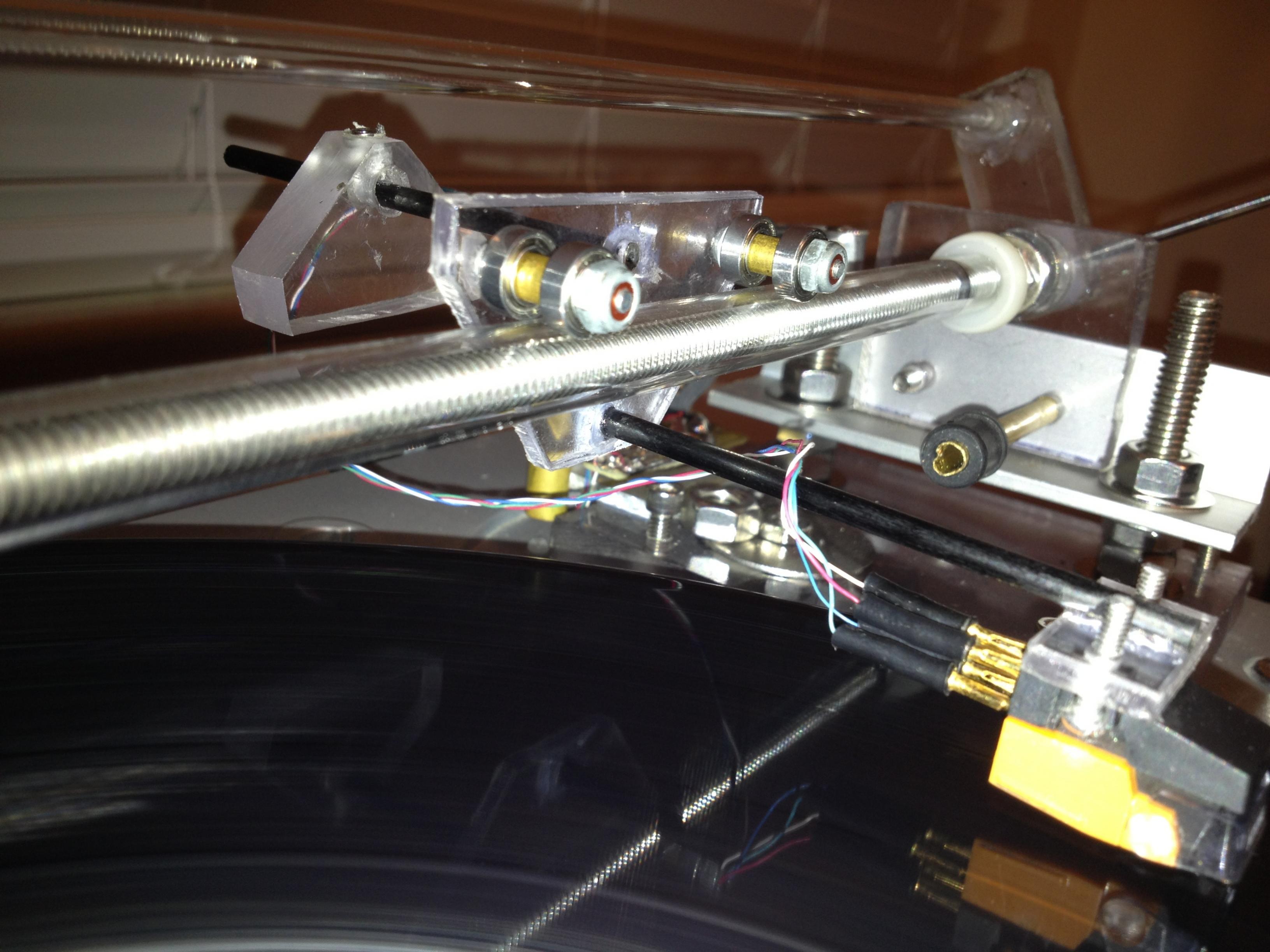

Another DIY project from here.
The results!, with cartridge installed.
Glass tube-34.1g, 27.6g w/o cart
Carbon fiber-29.5g, 23g w/o cart
Higher than I predicted, but perfect for a mid compliance cartridge as the at120e, not so good for a high compliance shure m95ed. Could use thinner cf arm tube, but getting too low the tonearm wires must be dressed precariously 🙂.

So far the carbon fiber seems to have a lead on the glass for sonics, surprisingly not by much 🙂. Going to build a lower mass version from a thinner cf tube for the higher compliance cart. But a total lateral mass of 29.5 grams in not too shabby.

Carriage is a little over 21 grams without cartridge.
Hi vynuhl addict. Can you lower the carriage weight by drilling lightening holes through it it or is that not possible. Maybe it could be made of two thin sheets with spacers in the appropriate place - bearing and tube mounts into the carriage. Just an idea. I'm new to this side of things but extremely interested.
jamikl
Jamikl,
Good idea, and I picked a few I could drill out while still maintaining rigidity 🙂. Another great part of this forum is getting ideas and thoughts of other members to make an even better end result!.
