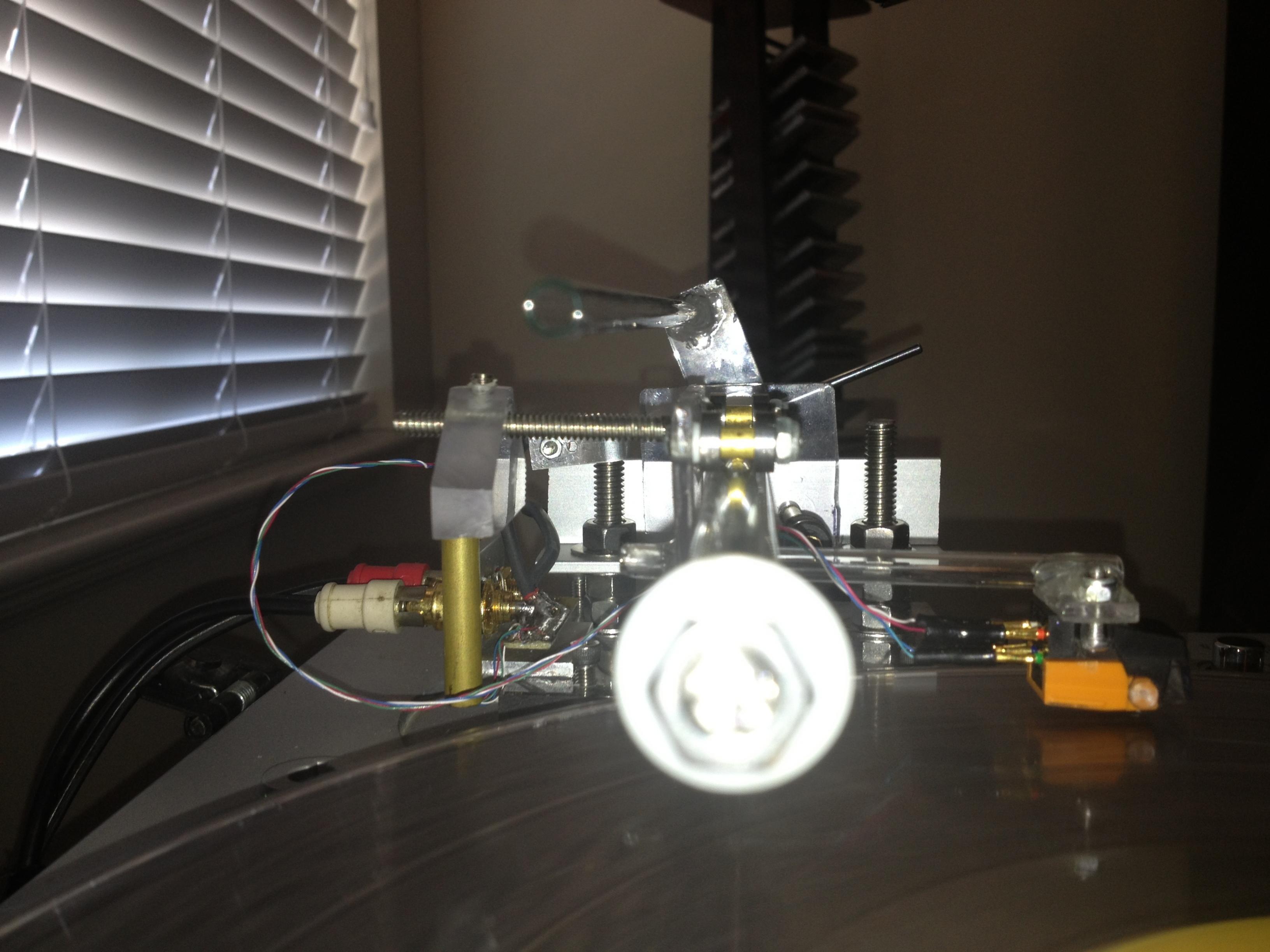

I'll match that photo and offer a similar shot 🙂.
Colin
One thing that also seems to stand out with this arm is deep tight and beautiful tuneful bass, I have a modified rb250 with low slung weight and it can't even come close to the musicality of the bass now. One thing that always drive me nuts about that arm was its bland highs and upper mids,almost grey sounding.

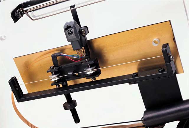

here is a photo of an idea which has been around for a long time and has be commercial a number of times though I cannot recall names other than some current Clear Audio versions. Not sure who made this one (probably clear Audio) but the photo shows the concept and it lends itself to all manner of variants. The other photo with the underside shot was a production arm. I love the simplicity of the idea. Best regards Moray James.

The first photo is of a Aura turntable, a Czech hifi maker.
I have this one.

https://s18-us2.ixquick-proxy.com/d.../www.doebbe.com/hifi/pics/AURA_G6N_ret_2s.jpg
dhs AU/RA G6N turntable
I have this one.
Thanks for that information. Can you comment further on yours do you have the regga table also? Best regards Moray James.

btw: Clearaudio modified this arm a little bit (better cable mainly), called it CAL 3 S, fitted a Clearaudio Alpha System and sold it with an acryl chassis as Clearaudio Evolution turntable in '97. (They still used that silly scale) It seems pictures of the 'classical' Evolution turntable are hard to find... Clearaudio likes to behave like they never used the CAL3S, although it's quite obvious that the actual 'Tangent' arm is nothing more than a redesign of the AU/RA arm. Hey, Peter S.! Invent something yourself ;-)
So see some pics of the 'Evolution' here.
