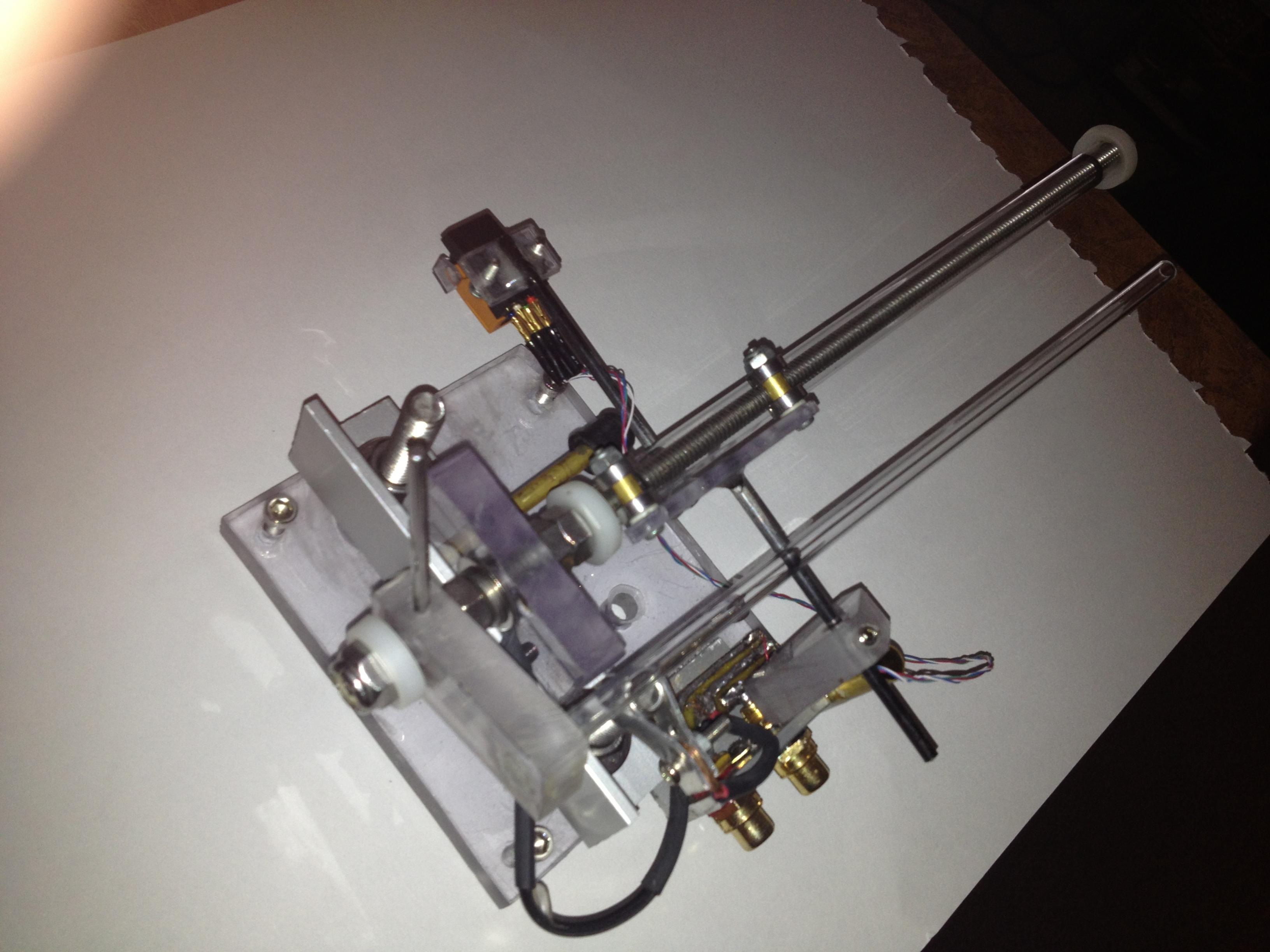

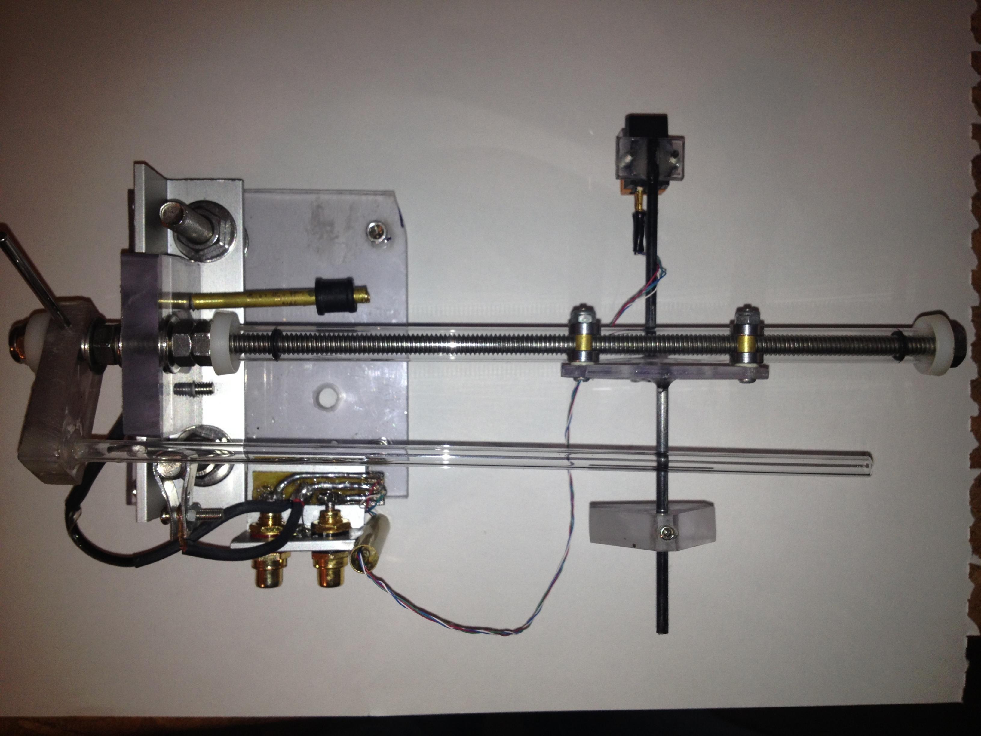

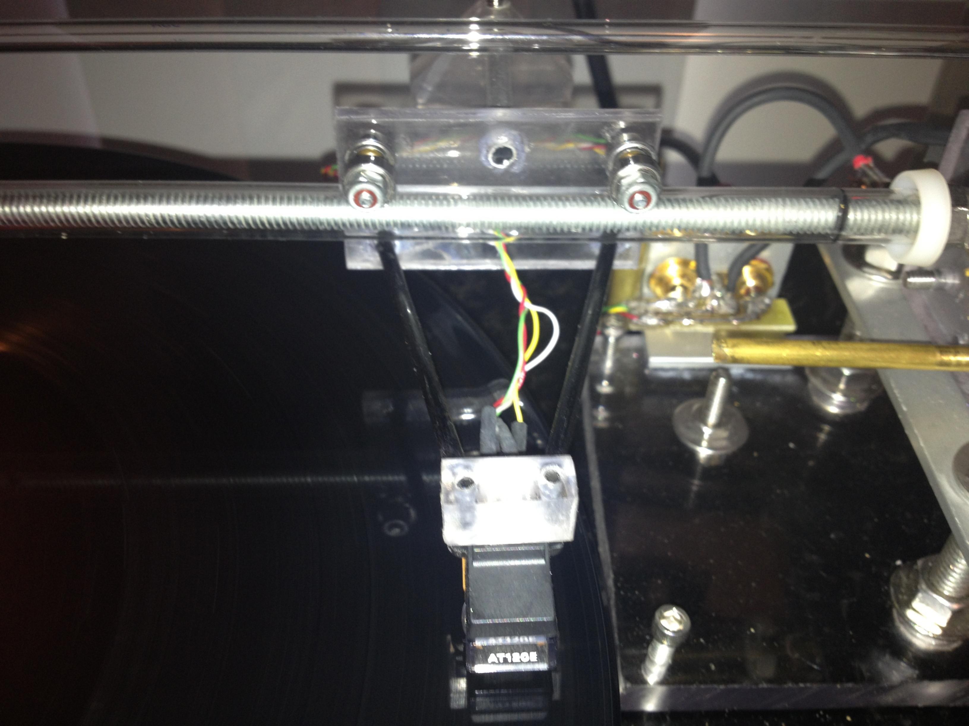

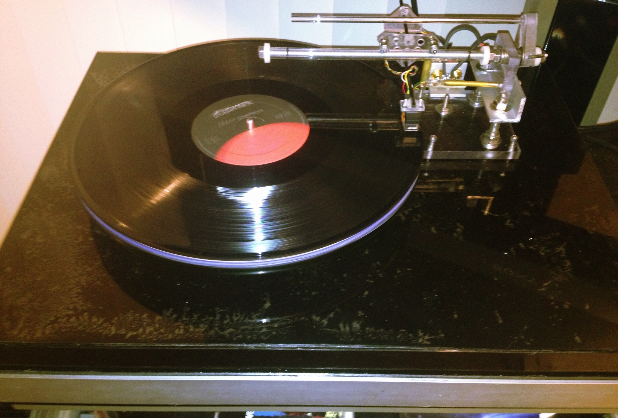

Thanks for the questions. Yes it rides on 4 bearings on the glass tube, for a mid to low compliance cartridge this works very well. The bearing arrangement floats on a brass spacer in which the upper round of the tube keeps them seperated via gravity/weight of the carriage. I'll attempt to post a video to you tube but had trouble doing so in the past. You are right, there is a small amount of friction on the vertical axis but nowhere near enough to visually move the cantilever out of position on a mid compliance cartridge, on off center records I've also carefully watched this and on the most extreme cases there is very little movement from center but rather the carriage runs smoothly side to side. Due to its light weight there is little overshoot as seen by how quickly the carriage recovers to traverse back on off center pressings. On a slight warp there is no audibly speed fluctuation unless the warp is ungodly, however it will still track the warp. Vtf also doesn't seem to get affected too much but this may be more a result of where I placed the counterweight, on a difference of 5 mm translates to less than 1/10th of a gram difference in vtf measured with a scale. Heck, who knows, the additional damping with the small vertical friction may be of benefit, I've been running this version almost a couple of weeks with no issues thus far once setup properly 🙂.

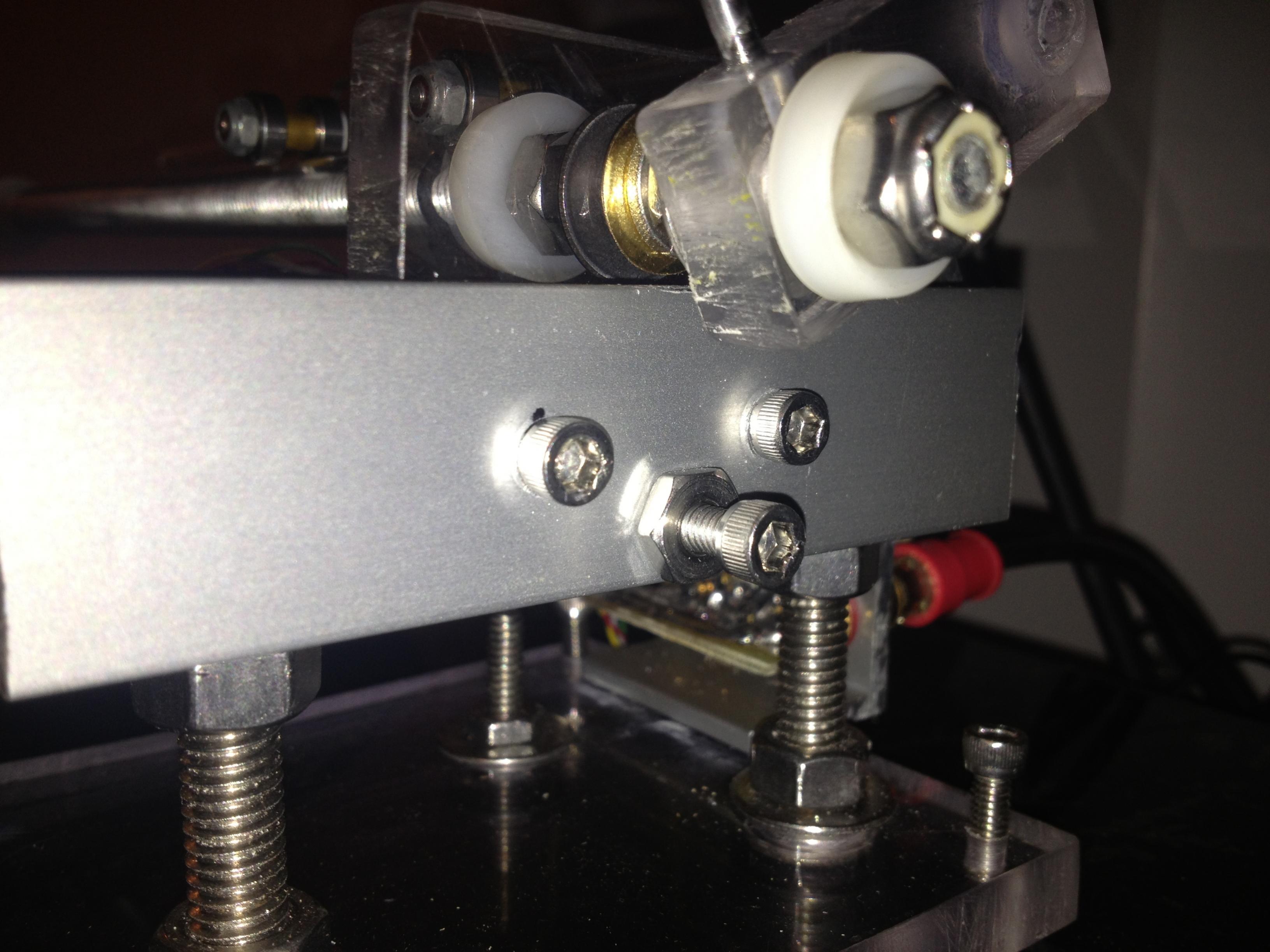

Correction, brass shim not spacer. The bearings are only locked at the outside, without the glass tube they are free on the shim. It's more a case of the glass tube working together with the bearings for a solid footing. I'll do some measurements and post them ASAP.

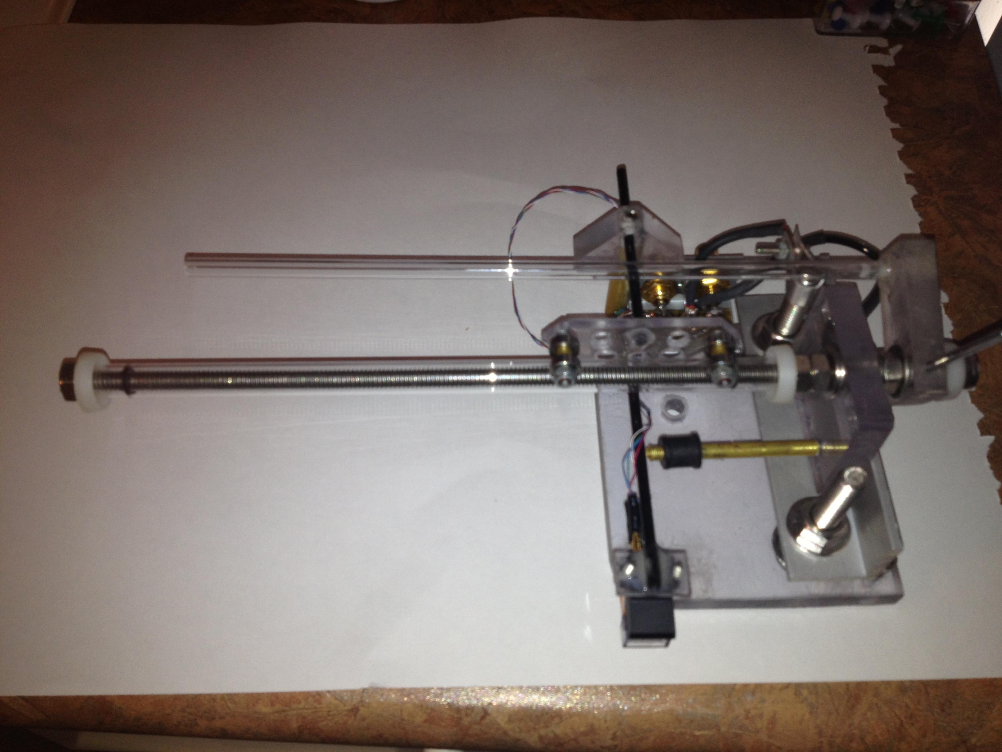

Another arm only angle

There must have been a reason Bo did it this way, I thought I'd give it a try placing the arm tube axis in line with the bearings from the cartridge point, it is a tad heavier and I replaced the counterweight tube with aluminum. The nice part with this arm is that different carriages are easily swappable. Though instantly and easily noted this technique will make for a more rigid platform for the cartridge 🙂.
