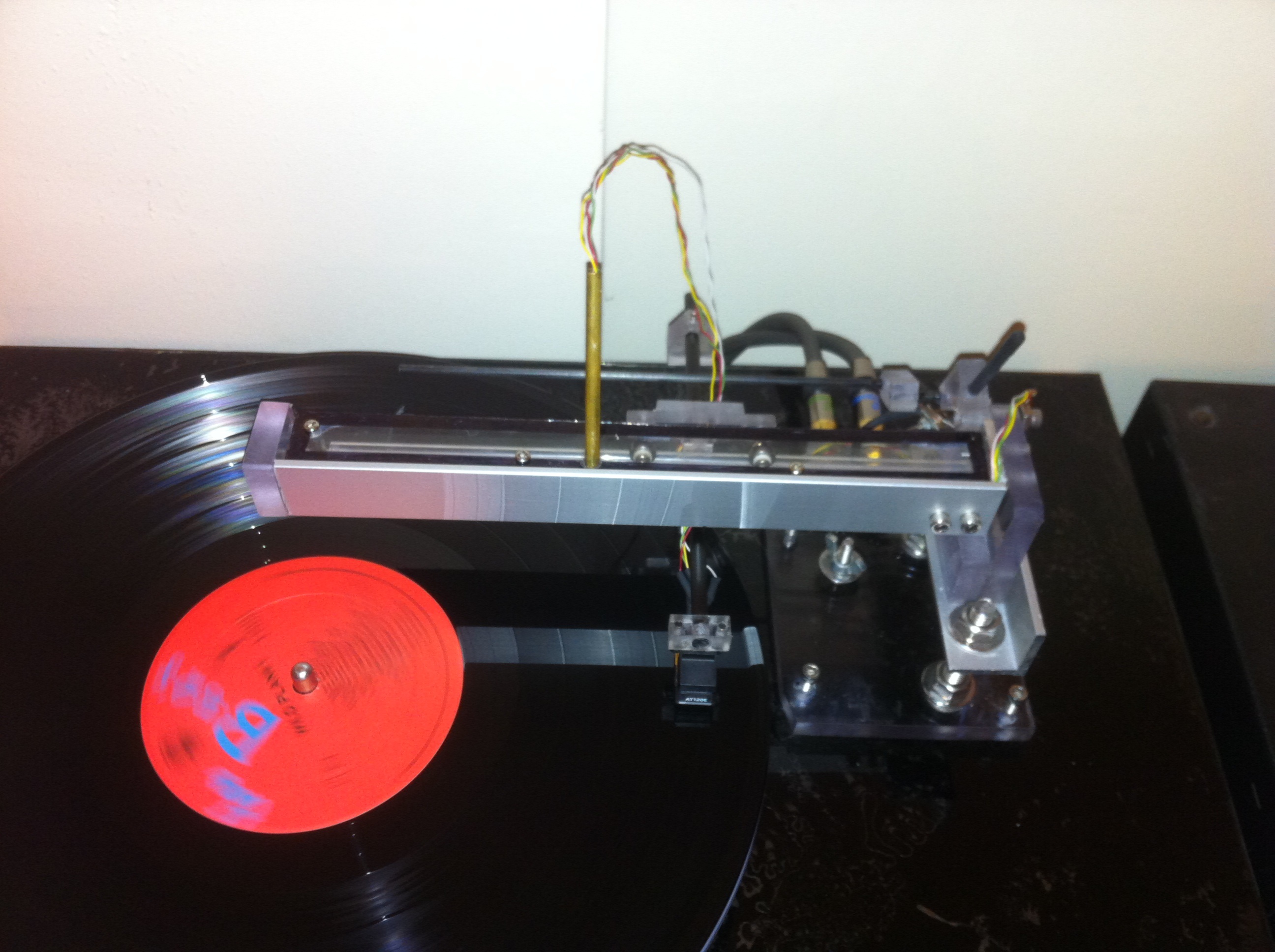

Arm lift developed and installed, carbon fiber and polycarbonate :).

looks like we are evolving back to the Cantus albeit an inside out one.
That's exactly what I was also thinking :D same vertical and horizontal properties .. however , this 2 rodded animal has a larger contact surface .. perhaps also deviding resonances over two glass tubes , instead of one . who knows what else :D I also strongly believe that the mass of the carrier has a lot to do with a dead construcion .. as we need mass and materials to dissipate the energy .
I'm happy to hear positive news about this new arm approach !!

Paul,
The Cantus never left the thoughts myself or any others, similar in the respect they both use two bearings. I think this one rather takes the V concept to a whole new stratosphere :). I half agree with mass, in the right places yes it is needed, but more appropriately over mass is the correct materials used to cover different areas to control resonance. Just aiming for "dead" is something that is applicable more to speaker boxes and stands, but even those dead boxes heavily rely on sometimes ingenious shapes for resonance control and redirecting and dissipating internal reflections.
Rega has their own anti mass philosophy, and based on their sales numbers it works for them, IMHO their tables do sound very musicial while not being the king of accuracy. Perhaps putting all of our minds together here we can rewrite some areas of prior ways of thinking, physics is set in stone of course but its too simple to just add mass to everything and hope for the best :). I see no reason why we can't come up with possibly even a better arm than what is commercially available :).
Colin

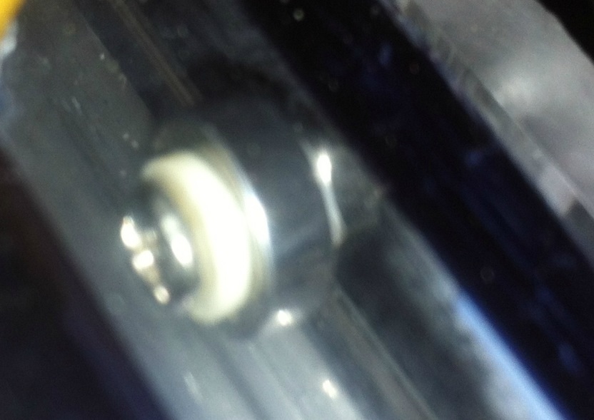

Hi Chris,
I still use a spacer to center the bearing and a top hat at each side but the bearing center is firmly bolted in place. I use a small bolt for the bearing, really simple to set up and requires no gluing. The polycarbonate T for the carriage is tapped for the bolt.
Colin
When I built the first prototype of the dual tube, it was my goal to keep the
weight down as low as possible. Since the 2 bearings dont need to "slide" on a bushing, or "seat" themselves at a slight angle on each side of the a single tube, I figured why not just affix them permanently. I could see no reason to have to remove the bearings, so why add the additional mass of bolts, shims, bushings, nuts etc.
The cost of one of these arms, including bearings, is right around $8...I have a removable and adjustable headshell that can be fitted to any of the arms. I have 4 now, with 2 different headshells.
What I did was to fit a small piece of carbon tube, hollow 3mm.....the same tube as the wand itself, into the 3mm opening of the bearing. I cut these pieces with my Dremmel to fit for width. These I superglued in place, and at the same time glued small brass rods that fit into the carbon tube and glued them into place as well. Two holes drilled into the acrylic carriage to fit the
rods, you guessed it glued in place.
So now the whole bearing assembly weight is only that of the bearings themselves, the small 3mm carbon tubes, and the brass rods. Tweaking the
alignment of the bearings was done in a few minutes using two small needle nose pliers on the brass rod.
It worked really well and, if I remember correctly, the wand without cartridge
is right around 13 grams, including the 5 gr counter weight.
You can see the brass rods in these pics....

I'm not a fan of a permanent fix since it doesn't allow exchanging bearings. To be honest. The movement is so smooth weight doesn't really matter much at all bow about 35 grams :). In fact going too low will be a detriment for Mc cartridges. The bolt weighs barely a half gram, it's tiny and allows much more option, I've tried to avoid glue as much as possible and with the bolts it avoids errors in alignments :).
