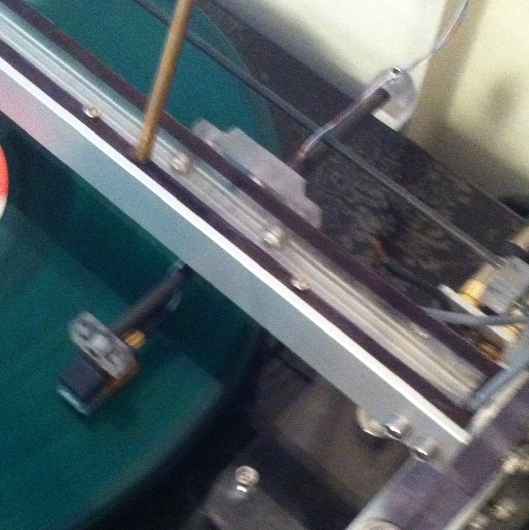

I have found counterweight placement to perform best further away from the carriage, doing this also increases dynamic vertical effective mass. Also this allows for a lighter configuration as a 10gram weight near pivot can be reduced to as little as 4 grams further away, but I have found ideally on these arms the weight should be the equivalent of the cartridge weight. Without cartridge or counterweight the carriage should balance out on its own, this has seemed to be a good engineering guide to shoot for.

Here is an example pic for the cw.
