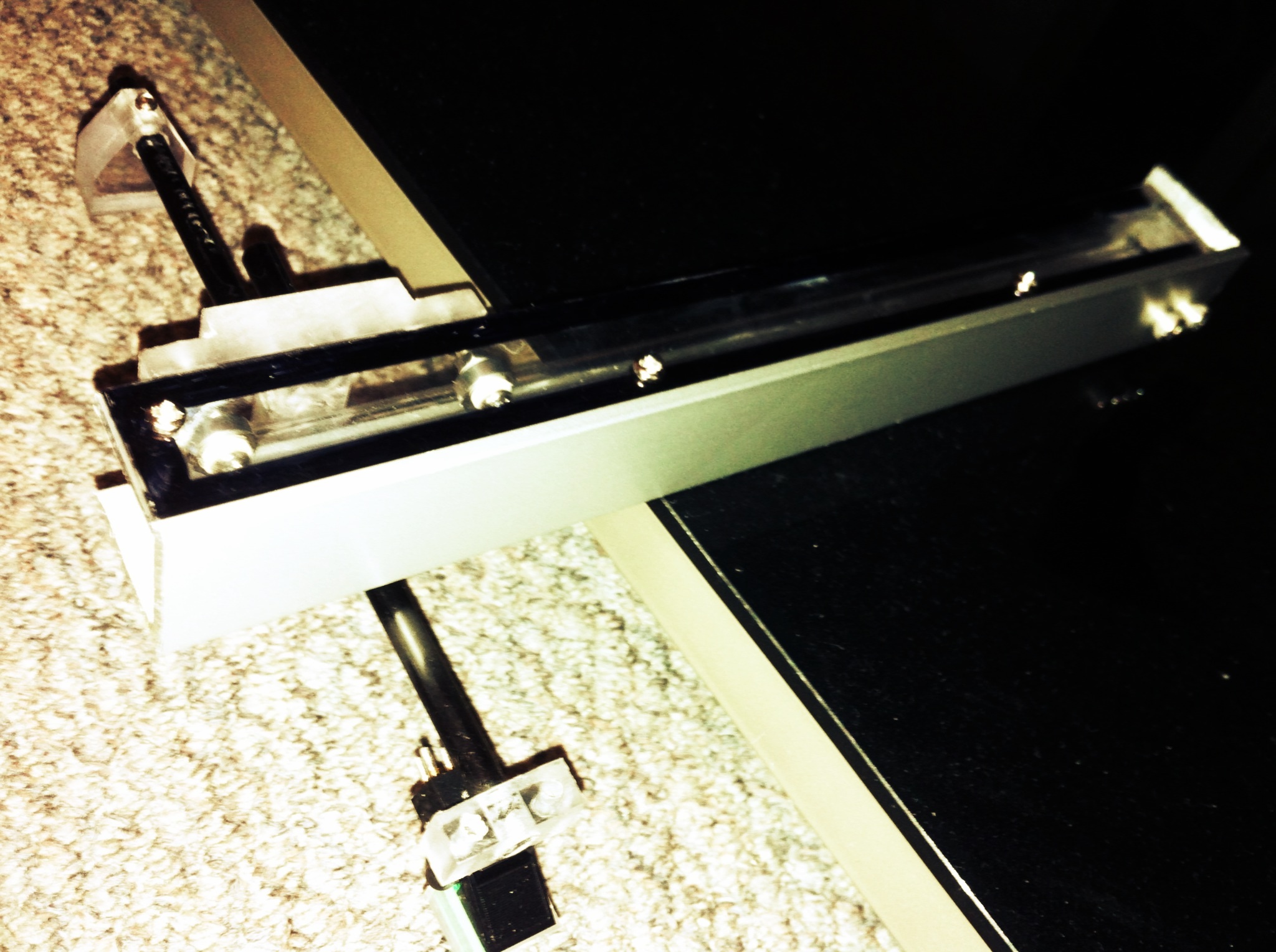

I've got to hand it to PDR, good job and excellent job on proof of concept on this design. With the two glass tubes being rounded edges its a much better pivot than a V shape . Now this can be honed substantially, currently designing a system which the arm won't fall off at all. This bearing is not as good at tracking extreme warps as the 4 bearing system,but who would play those anyways. PDR, give yourself a pat on the back fellow Canadian .
Colin
Thanks Colin, its just an idea that seemed to work.
Looking forward to where it goes.
Colin, thanks for the back pat.
Its just something that came up, looking
Bill, I have to apologize.
I just havnt had time to get into my room to muck around this weekend.
I work out of town for 10 days out of 14 and I'm heading out this morning again.
I do get to come back for Wed and Thurs night this week, I'll give the
ringing tests a go then.
The tubes I used are 10mm O.D. and 1.5mm thick.
They are glued together on each end with one small drop of crazy glue.
The tubes are epoxied to the thinner top acrylic plate. The way I have the
thumb screws mounted I can level the tubes length wise and across, just
takes a few minutes.
The acrylic plates are held with a threaded hollow brass 7/8" fitting.
There is a nut on each side of the the plates to hold them steady, and
one on the top and bottom of the Rega. The brushed nickle looking
shaft is actually hollow tubes that covers the brass fittings and give it a finished look.
I'm having a hum issue with the Rega, the DD was dead silent. Will have to see if I can work it out.

Thanks Colin,
Looks like I should be quite happy with what has developed. All along I've been working on the TT, the shelf it is on and so forth. I can now bang on the shelf with my fist, beat up the plinths, do a drum roll with my fingers on the track mount block, all with a record playing at normal volume and hear next to nothing! This is a far cry from where it was a few weeks ago. My only fear was that the normal resonance of the track tube(s) could be excited by vibrations in the system and be detrimental to the signal. Apparently this isn't happening and I can live with it (the resonance) in its highly attenuated state.
Niffy,
Sand/silicone mix was my next step. My 2 tubes are glued together with thick magic glue. Looking at the tubes I can see a magnified image of the glue line and all its smears. Ugly at best. So the yet to be implemented cure was to make the silicone opaque, mix it with sand. It may well work better than the clear oil filler. I'll report.
Rgds to all,
BillG

I've been running the 2 tube since November. I have a lot of hours on
it now, enough to take it from prototype to a finished arm. The first
version was on my DD table, this new one on the Rega was just finished
after X-mas, I only have maybe 40 hrs on it.
I found that if I drop the wand on to my scale that I get consistent
reading every time, I wasnt getting that with my single tube.
I would think thats because there is less weight above the tubes
so it settles better? Dont know why, just know its better.
The total weight of the arm including 6 gram cart and 5 gram counter
is now a just over 19 grams, I trimmed some fat yesterday.
I have 8pc of 12" woofers in my system...dont want to wreck any of them.
Just a note, I'm not a bass junky, I have 2 dual subs behind for smoothing.
Like Bill I have also found that its almost impossible to have
an accidental falling off, thats just a convenience thing though.
I would think the next step of this riding the tubes system would be using smaller tubes and smaller bearings.....I'm going to try that in the near future.
Maybe damp the bottom valley with some liquid rubber, or even a small sheet
of rubber glued to the underneath of the tubes?.......just thinking out loud.

And voila, two tube, two bearing working and non falling off arm with a dust cover, only arm lift left to go, PDR, thanks for the inspiration, this is what its all about . Seems all in all I needed to do some more work with the two tube design I tried out a couple moons back, thanks for proving it can work and needed further investigation.
Colin
