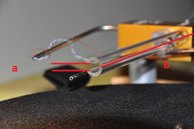

I have seen the ID and OD specs , but please have a look at the attached foto , I must know the distance in MilliMeter of point A ( between the red lines ) + of course the lenght of tube , including the invisible fraction sticking into the base 😀
THX !!

I will send measurements later but you just asked a loaded question which is really answered by "that depends" and it depends on your build the size of bearings and the size of bearing ID you use and the physical size of carriage you build (smaller is going to be better). Think about it and you will see what I mean. I can give you numbers but they are relevant only to the parts used in the Cantus your build will likely vary. Best regards Moray James.
I will send measurements later but you just asked a loaded question which is really answered by "that depends" and it depends on your build the size of bearings and the size of bearing ID you use a d the physical size of carriage you build (smaller is going to be better). Think about it and you will see what I mean. I can give you numbers but they are relevant only to the parts used in the Cantus your build will likely vary. Best regards Moray James.
Thanks Moray for so nicely phrasing your answer. Please allow me to rephrase it in a somewhat less genteel manner. I can not understand this hangup on precise physical dimensions of parts in a Cantus or any other variation thereof. It doesn't matter what the dimensions are as long as they allow the desired action to take place. . The tube has to be long enough that the carriage won't fall off before getting to the end of the recorded music. The slot needs to be wide enough to let the bearing mount rods pass through and not hit the slot edges as the arm goes up and down. This can be easily measured from a simple sketch full size on fish paper. We know from actual measurements the ID and OD of the tube. Again this is arbitrary based on the size of bearing used. It has to run from one end to the other without getting stuck. But we have those numbers. How long for the tube to stick into the mounting block? Long enough so it won't fall out. More pertinent would be to ask how s the tube going to be fastened.

I don't know the dimensions for the slot neither the tube length. However, I did some work in my 3D eng. software with the 16/10mm tube I have and the 614/8 SKF bearing. The slot should be at least 2mm wider than the bearing shaft - meaning, if the bearing is attached/fixed on a 3mm shaft, you would need at least a 5mm wide gap to be able to set the tonearm to a position where it can move freely from a position where the needle is at it's lowest - on the record and upward so it can be raised enough to slide it safely away from the vinyl surface. An additional millimeter can't hurt. I also found that a 170-180mm of length should do - a tube that's too short might compromise the ease of positioning the whole arm construction. I opted for a 200mm long tube, that should give plenty of room to play with.

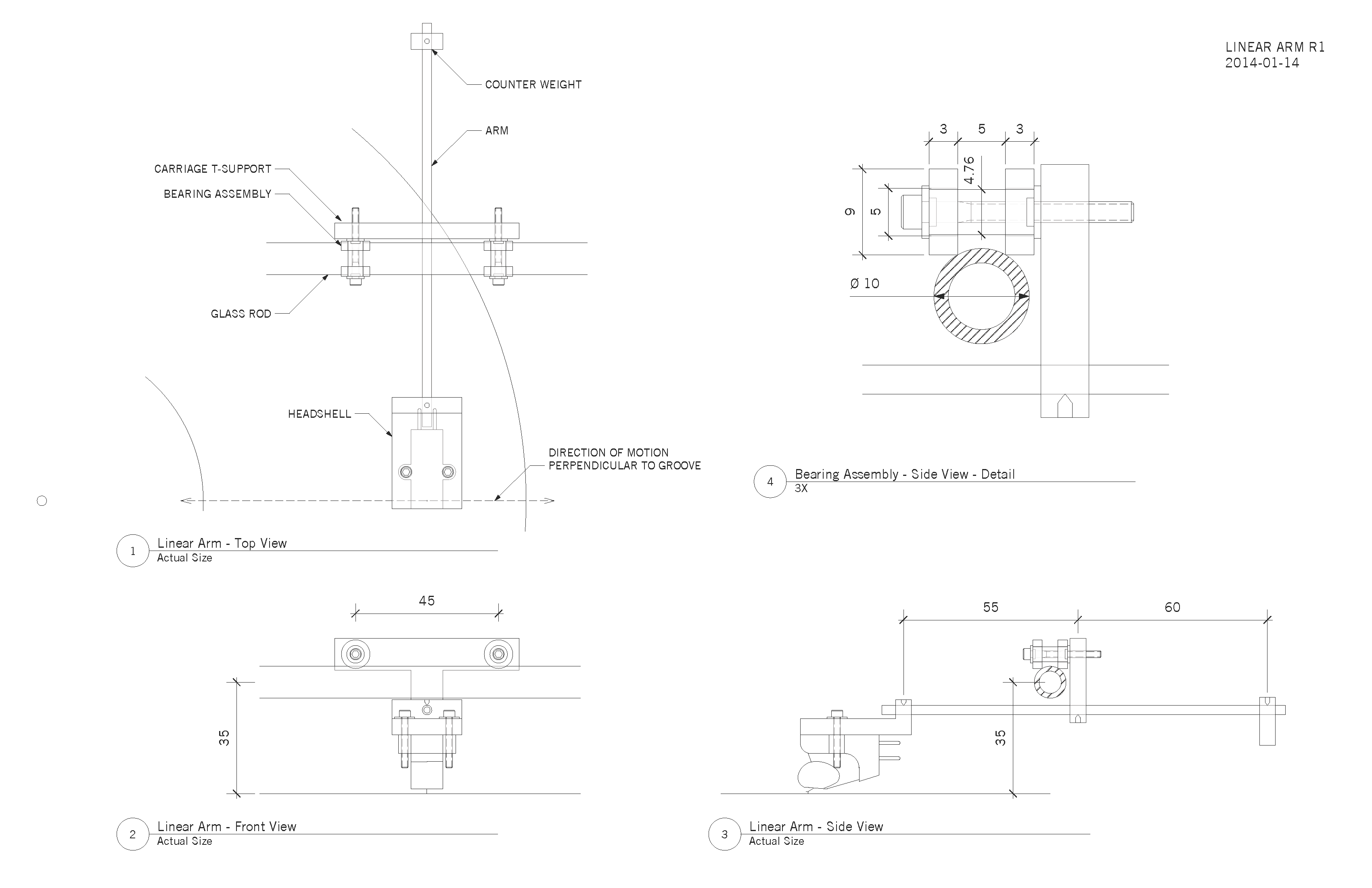

Hello,
I've read through this thread a couple times now. I am very interested to start my own arm. I have also noted many of the critical dimensions and design decisions mentioned and created a basic drawing of the arm as intended by the OP.
Hopefully I can get some feedback as to the drawing for correctness. I am happy to revise the drawings and create a basic bill of materials for all to use.
