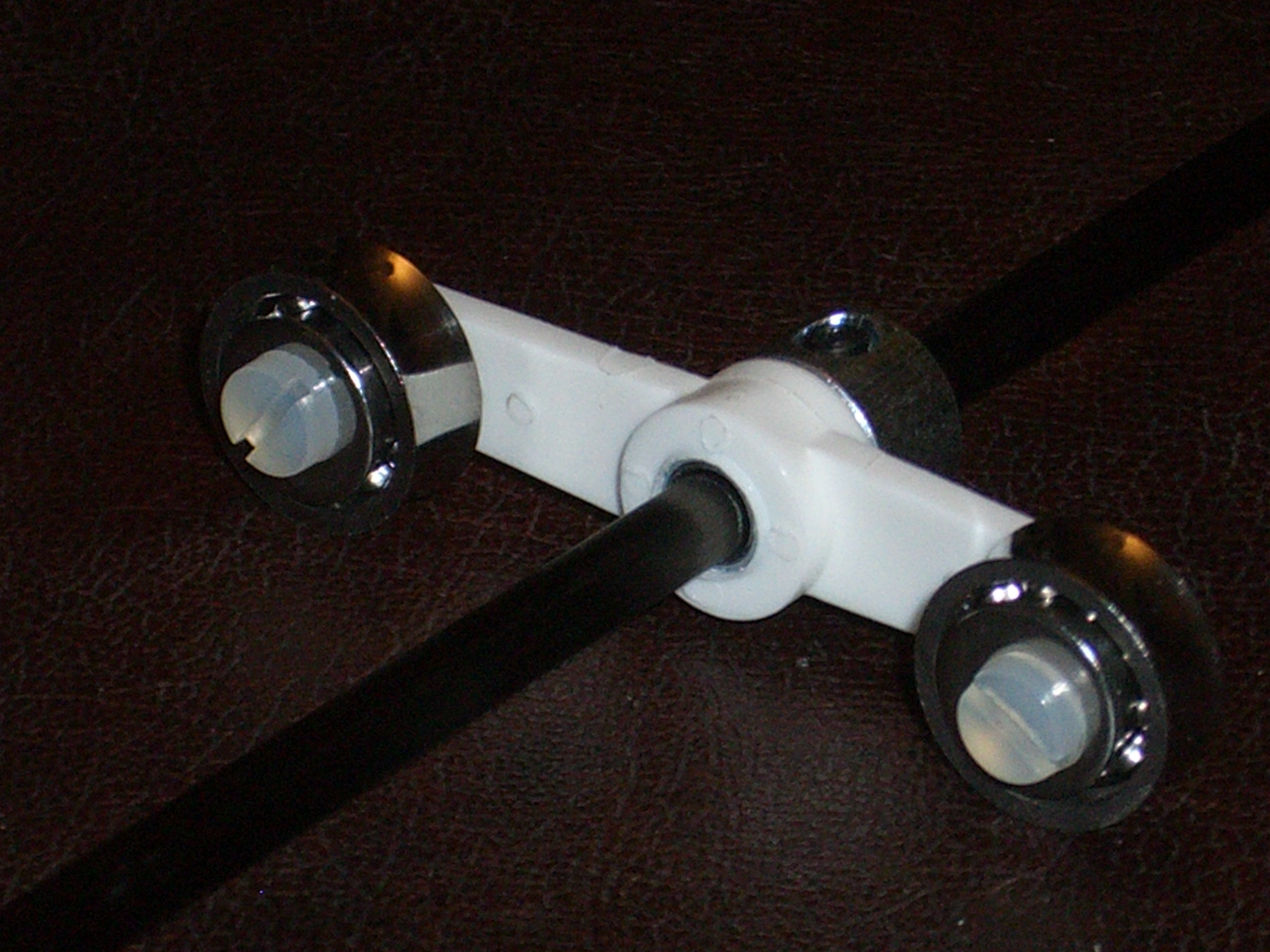

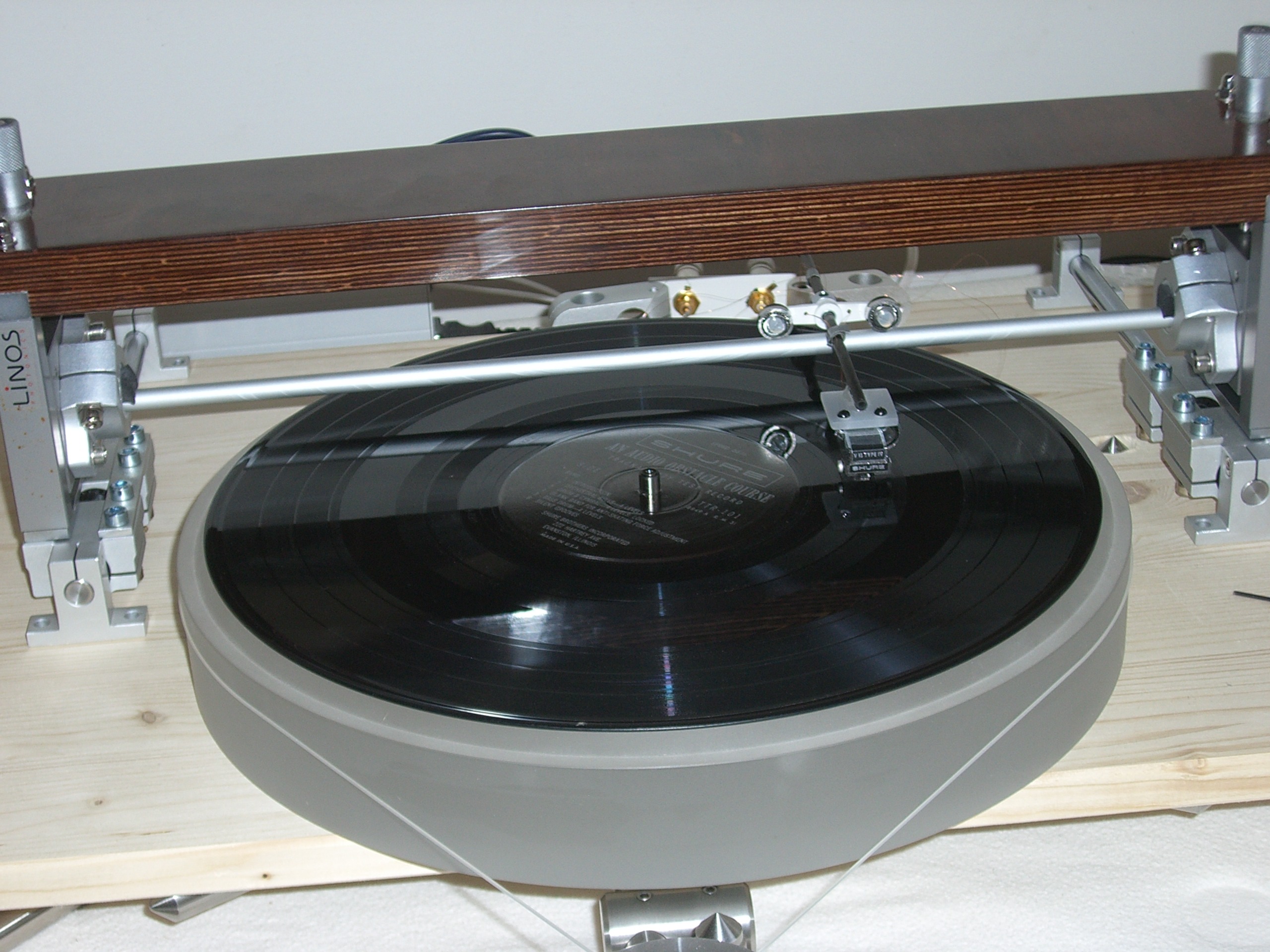

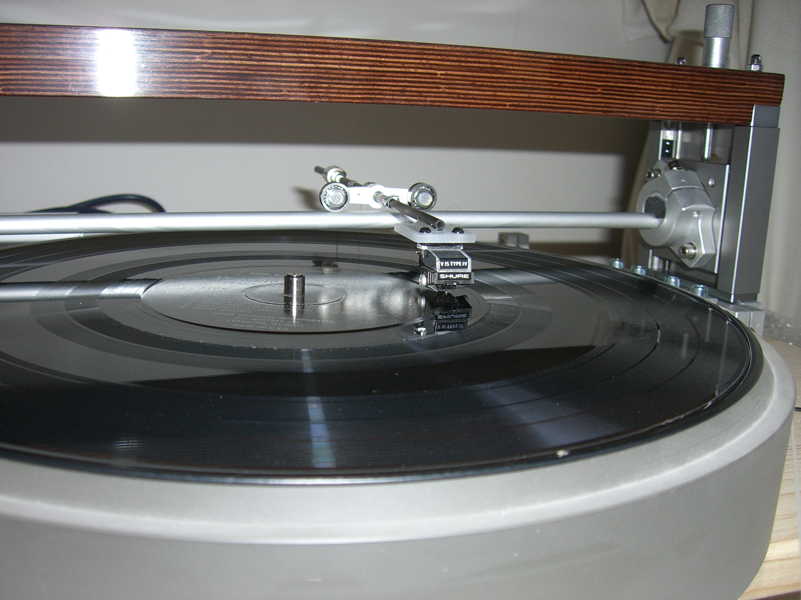

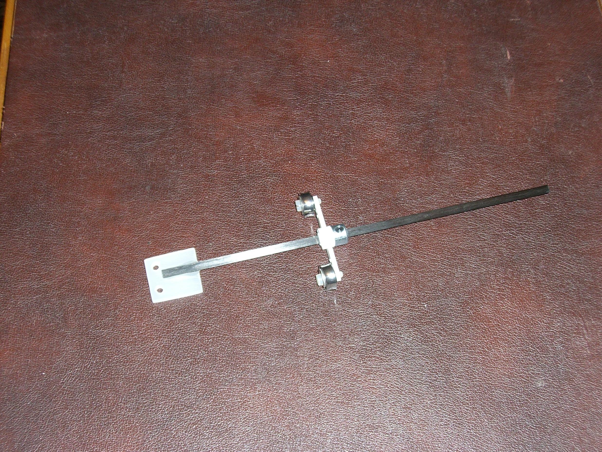

This is a quick and rather simple implementation using a carbon rod and Yoyo bearings, cart weight is 14 gs.
Runs smoothly without any problems on a simple aluminium tube.
It is, however, very delicate and only a try to look if it is working. Definitely not my final setup.
