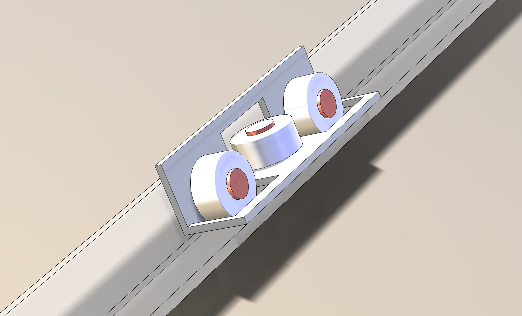

Colin, I had to re-read what you wrote in this topic and found what I have been missing from the equation. The small brass tubes. The 684 bearing has a nominal 4mm ID and found two small brass tubes with just a pinch larger OD - polished them first with a fine sandpaper (500) then with a polishing cream. Just to get a few hundreds of a mm less OD and to get just a small amount of slack between the tubes and the bearings. I think that this will give it some chance to work. I'll report back.
One quick note on tonearm tube weights - a 5/3mm Al tube is heavier per length than a 8/7.1mm tube (OD/ID) - although, not much, but with these arms every bit counts. At 150mm length, the thinner wall but larger OD tube weighs 4.32grams and the 5mm tube with 1mm wall weighs 5.09 grams. Of course, both tubes are from aluminum.
I set up the whole assembly, four 684 bearings, cleaned dry, brass tubes, the total assembly with the OM10 (the small additional weight removed) weighing flimsy 14.89 grams and it fails to move - follow the grooves - I decided to re-think it all and take a few days off - it's really frustrating missing something and not knowing what...

I'm really sorry that you are having so much trouble. Before you decide to throw in the towel or go for outrageously expensive bearings please let me make a few simple suggestions.One of our members, DTUT, and I were having some good success with linear trackers having flat window glass set into a 90deg V track and two ball bearings. As in the Cantus design we both found it necessary to clean the bearings well and run them dry. We were both using inexpensive hybrid-ceramic rc car bearings. Then Colin demonstrated the 4 bearing design using similar bearings from a hobby shop iirc. His design was running with lubricated bearings straight from the store.
DTUT was the first to test this configuration and was using clean, dry bearings like what we were accustomed to use with window glass track. What he found was that the new 4 bearing on glass tube would not run well at all unless the clean bearings had some light lubrication in them. For my first and all further test models I used bearings from the V groove track experiments but lubed them with a fairly light clock oil and blew them out with compressed air so only a film of oil remained in the bearing. This is several months now and the carriage has shown no further trouble. Can I explain this difference? No, and still trying to. So give that a try please.
Lead dress and stiffness can make a world of difference. I've found that 30 gauge or finer enameled copper magnet wire, loosely twisted and some 10 inches long and supported so that the entire traverse of the carriage is accommodated by a smooth curve of the wire does the job well.
From what your pics show, I wonder just how well those bearings will do under the best of conditions. The outter races are much thinner than I'm used to seeing and using. Thinness alone won't do anything good or bad but I have seen bearing race distortion with tightness of mounting that could easily make the carriage stop or skip. So make sure that the bearings are not compromised in any way. And make sure the corners are well smoothed and polished. Those corners in the pics didn't look great.
What I have found is that once you get all these little things sorted out, these arms just keep running without troubles at all.
BTW, I'm assuming that the glass tube you are using is white on the inside and smooth clear flawless glass on the outside.

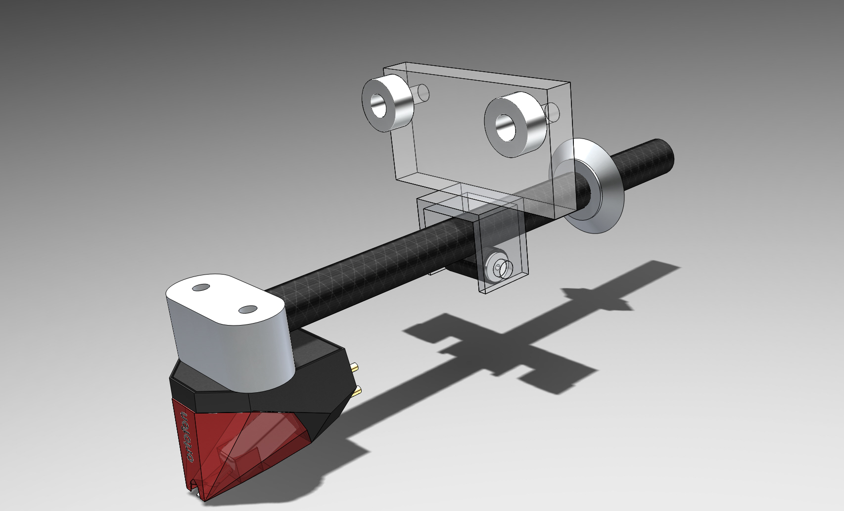

There is one idea I want to try, not sure how wise it is, it would require two roller bearings in-line, above the tonearm height and under the carriage - in line with the cartridge/tonearm tube, a second set of tiny bearings - sideways, as used with pivoting tonearms - to allow the cartridge and tonearm to move up and down, thus, lowering the pivoting point as close to the needle height as possible... Something like this... (just a quick mock-up)
I have those tiny bearings from some other tonearms, not sure which one is from which arm - had loads of broken tonearms in the past, Thorens, NAD(Garrard), Tesla...
Nice pic stein2
If you do it like you are proposing the whole arm will move back and forth with the drag from the vinyl. You would need another set of bearings and rod in front of the sled...
I'd use a narrow tube, say, a "U" or "V" shaped rail...?
I'm not sure why you would want to do this. Looking at other linear arms, both air bearing and roller bearing, they do not employ this. Even pivot arms don't allow a forwards/backwards movement (Y axis) of the arm. It would seem that you are just adding weight to the arm.

Nice arm you've built there. This looks pretty much like the configuration I would use if building an arm with this type of bearing design. Putting the glass tube below the armtube will reduce warp wow and warp induced variation in tracking force. The shallower bearing yoke should also be beneficial.
Are the 2 vertical rods in the arm base there to allow the arm to be raised for record changing?
You seem to have a very long section of armtube protruding behind the weight. Is this for a lift/lower mechanism. Cutting this as short as possible can only help sound quality.
The problem with the bearings that you and others have experienced might not be entirely due to excessive friction. The problem might be eccentricity. All bearing are eccentric to some degree. Precision bearings have eccentricity measured in microns. Budget and rc are a lot worse. In rc applications the outer race is normally held stationary whilst the inner race revolves. Eccentricity at the outer surface of the outer race in this application doesn't matter. In the tonearm it does.
With an eccentric bearing the axil will be go up and down in a sinusoidal curve with length equal to the circumference of the bearing and amplitude dependent on the severity of the eccentricity. If the bearing has an eccentricity of only 1% the steepest part of the curve will be over 1 degree (equivalent at that point of having the tube tilted). A 1% eccentricity in a 10mm diameter bearing is 0.1mm, very difficult to spot with a naked eye.
I had similar tracking problems and tracked it down to a 1.5% eccentricity in one of my bearings.
I hope my explanation makes sense and hope it is of use.
