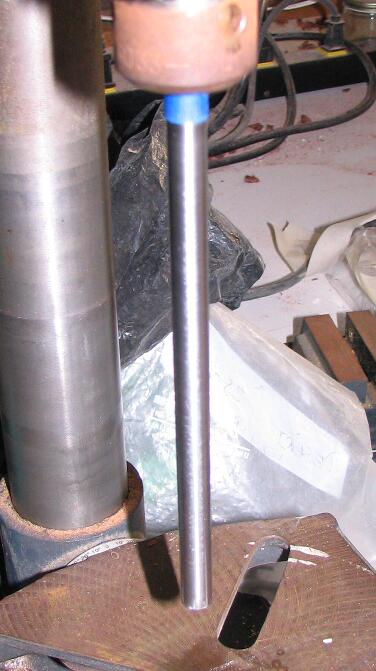

As to 'rod polishing' (ahem!) there maybe a cautionary tale here? The photo of the "ground & annealed" 17-4 SS rod shows on the right side about 15 minutes of hand polishing. Obviously the rod wasn't ready for prime time. Another photo shows a section of the rod in my drill press for more extensive work. More details later. My cache of 10mm borosilicate tubes certainly would make things easier.

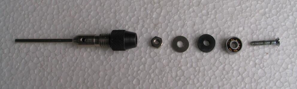

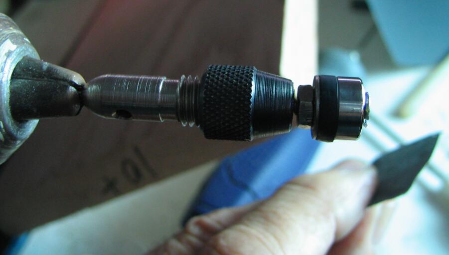

How about 'bearing edge polishing'? My ACER ceramic bearings under magnification of a x10 loupe showed quite a bit of machine tool marks on the edges - seemingly not good. I'd already removed the dust covers of the bearings, but decided to polish the edges anyway. The secret of the polishing jig was the rubber washer - see photo. There's a photo of the jig mounted in my hand drill, in a vise.

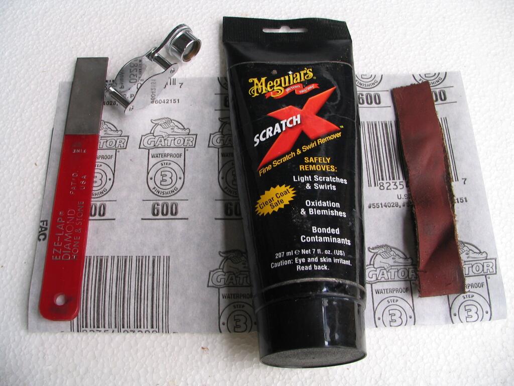

Under scrutiny of the x10 loupe (shocking, just shocking) I used a four-stage process: 'fine' diamond honer, 600 grit sandpaper, auto polish, and rouge on leather. See photo. Time consuming, yes! Nothing like 'rod polishing' though.
I only polished one side of each bearing - and they look very nice now. I rounded the top edge a bit too. Whether this is needed I have no clue. The x10 loupe is merciless, getting a mirror finish is not trivial ... I can't give up on the SS rod now. Too much time involved.
