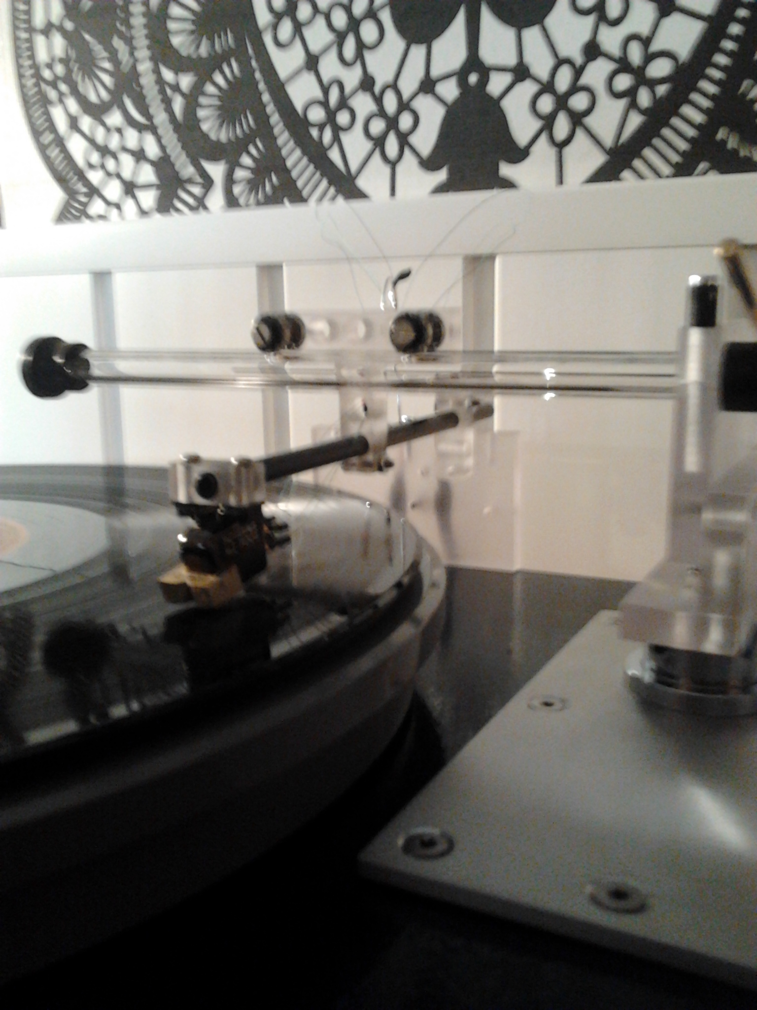

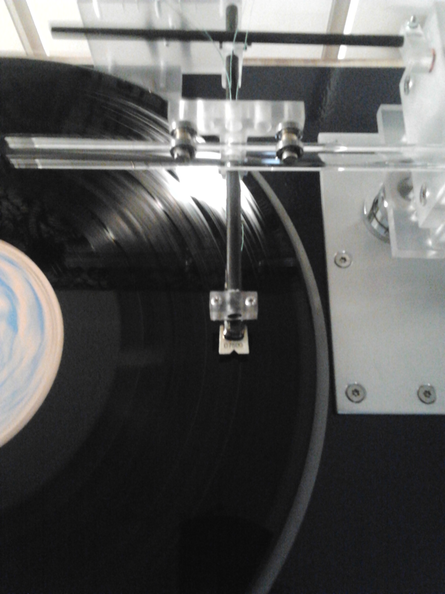

My arm <25g with cartridge. I use a Denon 103r about 1.8gm tracking. 2.3" from tip of stylus to pivot. Arm is a little longer than that for counter weight. Length for counter weight wasn't critical for me, probably could be about 1.5 inches. No friction issues. Glass is as level as I can make it.
I used hard maple to support the glass rod. Basically because I had it. Still sounds great!

Have mine up and running since last night.
I de-greased my bearings and they move like a champ
across the glass tube. Total weight of arm...without cartridge...
came in close to 23gms.
My arm is as level as I can make it, but I'm going to
fiddle with it and the counter weight over the next few days.
I was amazed that it "just worked" right out of the gate.
I picked a couple of albums I dont care for...poor recordings...for
the first spins, ones I could loose. I also picked an old cartridge
AT13 Ea for the same reason, expendable.
When I was confident I hadn't built a wrecking machine, I played
a well recorded album.
My room is set up for critical listening, fully treated,
big open baffle speakers, one center chair.
With that old Audio Technica cartridge I was just gobsmacked
Wasnt expecting that.....wow.
This is really a nice piece.
Hunting for a proper cartridge now.

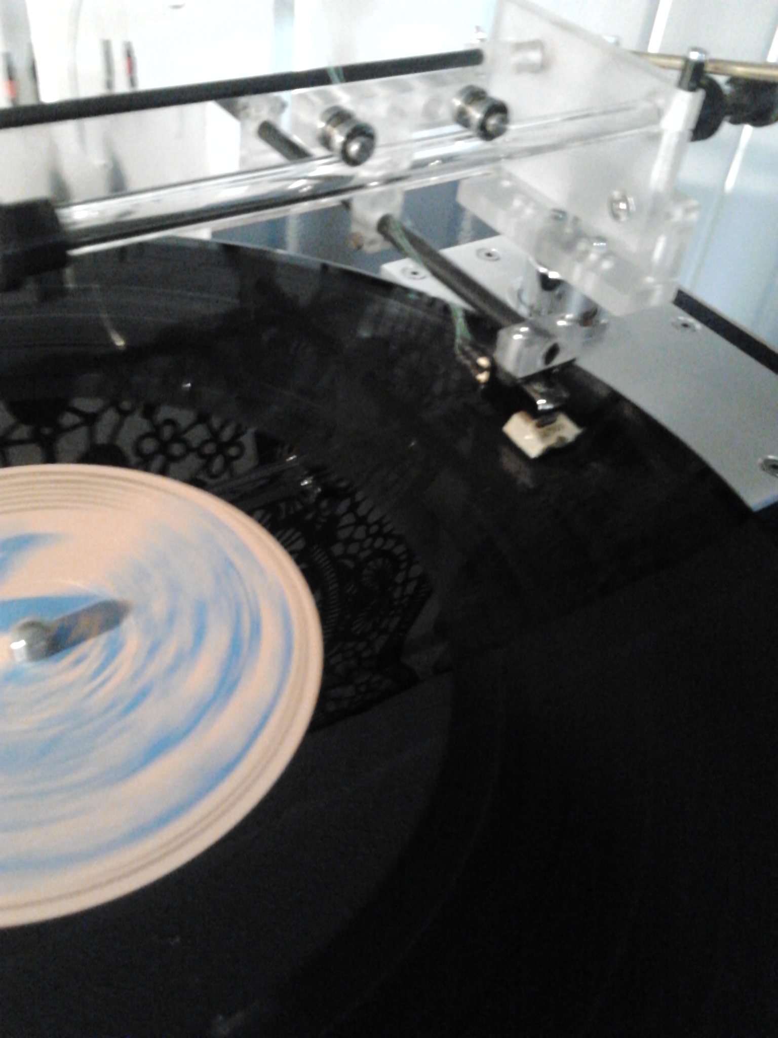

Pickering XLZ 7500S
I went to the XLZ 7500S Pickering cart with this arm ( no fear ) .. tracking force at 1.75 Gram .. what a great little sleeper this amazing cart . hooked it up with a battery feed SK146 junction fet prepre .. stunning believe me !
Also fiddled a bit more with the wiring and decided to try an extremely thin HF copper litze . almost undoable with bare eyes .. but I succeeded .. as most the times 😉
What a JOY

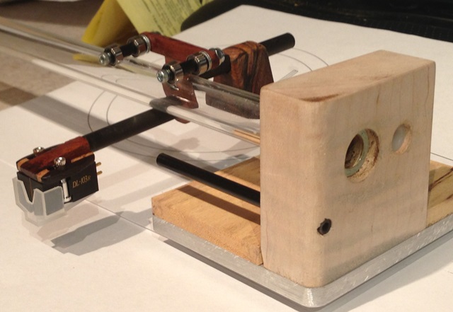

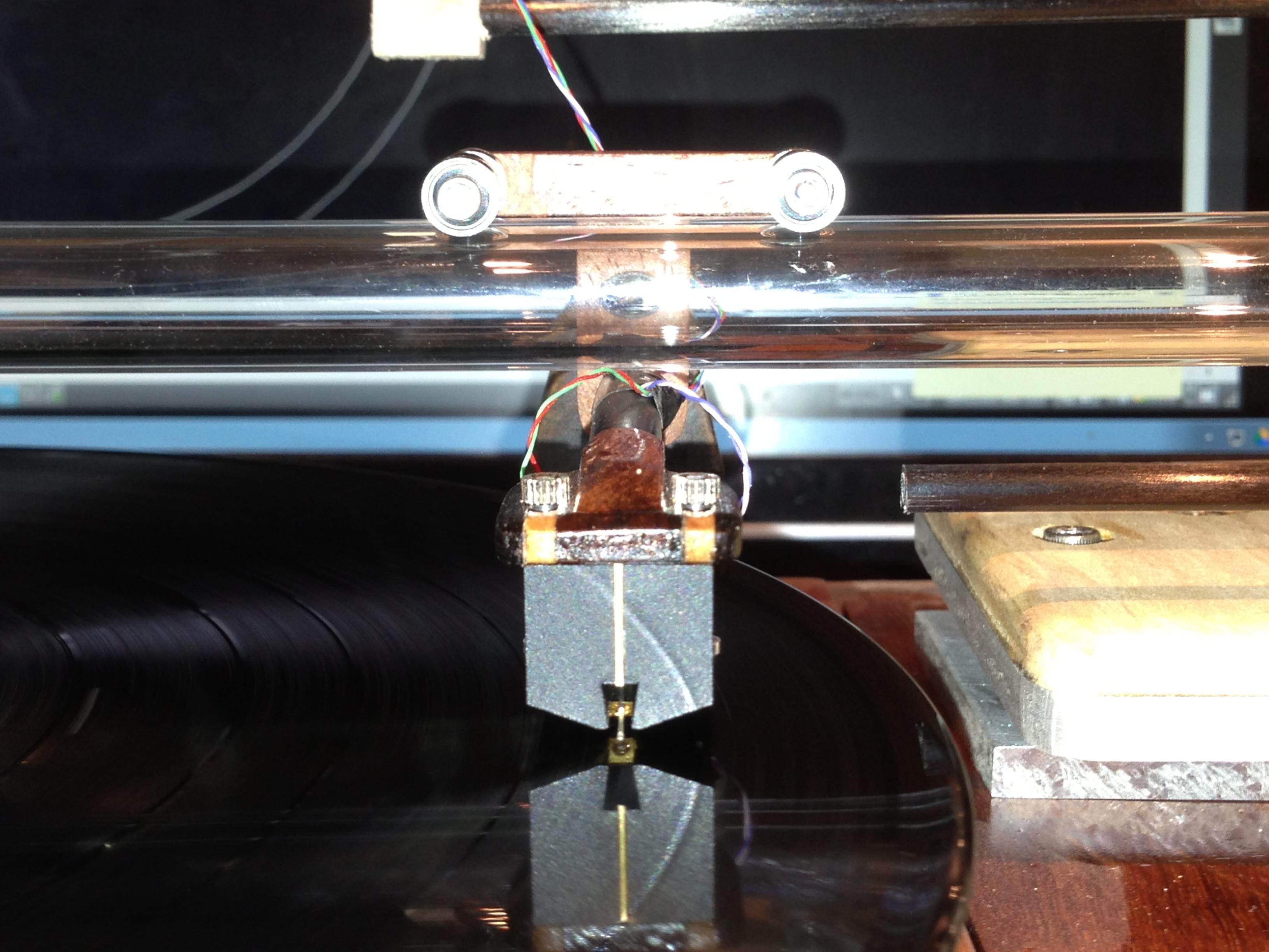

Hi Everyone
Not sure if I've been successful in uploading photos, but here goes...... It worked. note the leveling apparatus at the base. Simple and works a treat.
Chris
Hi Chris.
Could you give us a shot on the leveling apparatus from beneath showing whats under the top circular shim? How did you fasten it to the tubeholder and the bottomplate?
