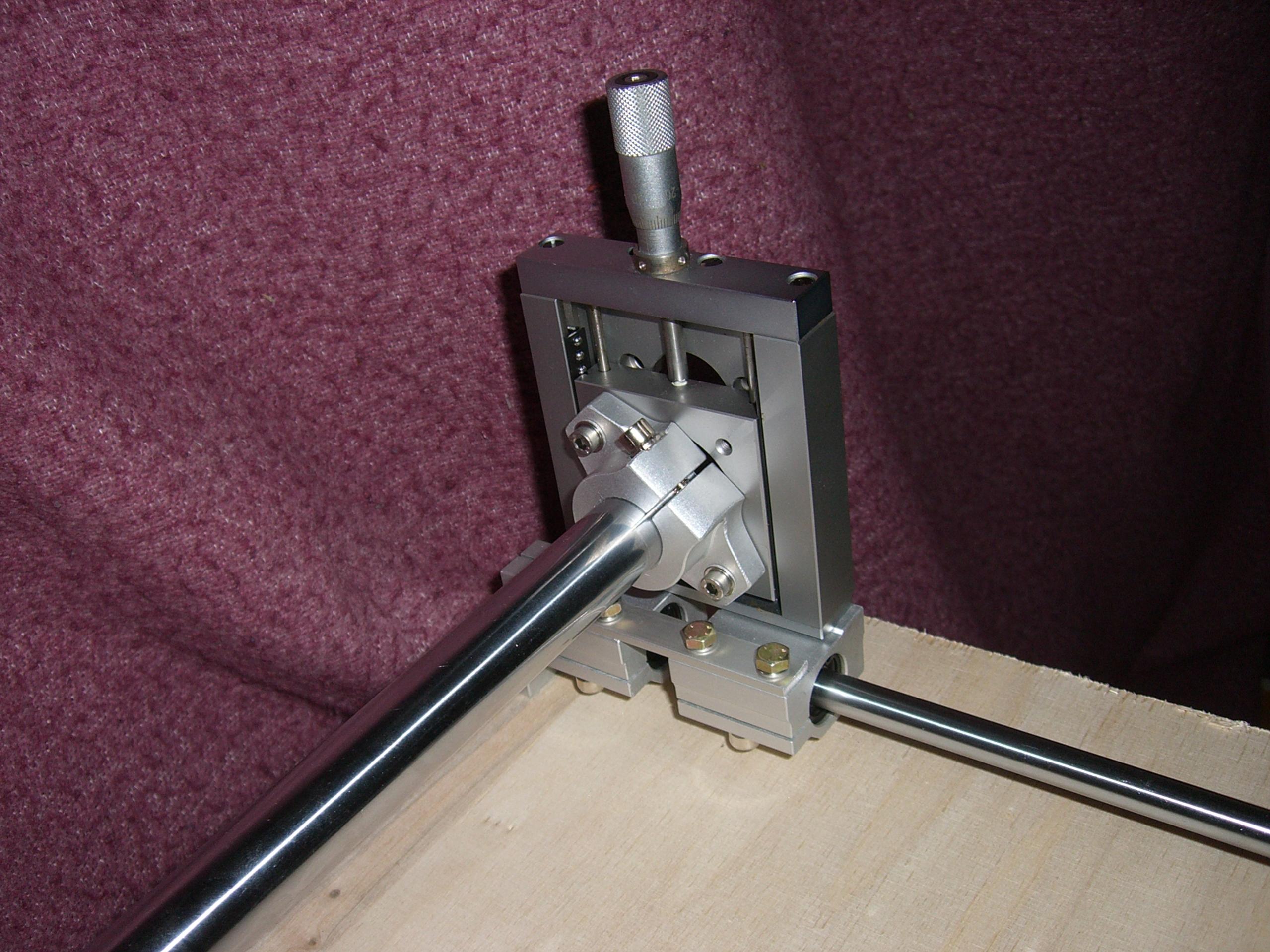

This is also what I am currently working on, the basic structure is working.
Wilfried
Wilfried,
I use the same sliding parts ( Dold Steinach ), but I keep both sliders at the right side of the teller and a 100-100-10 mm Alu angle profile for the crosstable.
Hans.
Nice for CNC machines!
Regards zeoN_Rider
My main goal is to have a stable construction, and believe me, this is extremely stable. In addition I will have a Panzerholz tower bridge mounted on top. The looks should nicely match my MG-hifi Optimal 4 turntable.
Wilfried

What you can see at the moment cost me ca. 180 EUR. I was lucky finding two of these Linos linear tables with 50mm travel range for 105 EUR at ebay.
There will be more costs for the Panzerholz bridge, and the glasstube, bearings, armwand, etc. But I think in total it will be below 500 EUR.

In my 'construction' (only on paper at the moment, I have to produce over 50 Lenco idler wheels before I can start some private work) I thought of using two 8 mm guide rails, both on the right side like on Hans' picture. Just because I have them (from old printers), but do you think these are too small? I have also some thicker rods (a long 1/2" piece also, for which I see no other purpose in a metric country. This would result in a heavy affair then. The length of these rails would be around 160 mm.

I use 10mm rail, long 200mm, but I`m not sure thats thick enough.

My rails are 10 mm in diameter, and 250 mm long (Präzisionswelle 10mm h6 geschliffen und gehärtet, 250mm).

some CNC parts
The 10mm shaft was bought by a friend with a linear bearing but it didn't work!! I then bought the clamps from the same ebay guy.
Bearings are open unoiled from RS Aust about 8$ each. Screws etc are 3mm.
A bit of meccano too!
I havent heard a Shure M97HE sound better!!
Still some mild sticking problems. Increased the weight to 2.5 gms and lifted up the stupid damper and its better. I have been playing old records though. Just put on a good Sade UK album and seems good. The wire is from a mouse and may be a bit stiff and could be better dressed with the guide at the back of the TT.
i am a bit concerned with the increased weight and am working on a hinged arm. V blocks a la Lenco arm come to mind. I have an old arm I might chop up and fit V blocks or some 1.5mm v section I have seen at the hobby shop.
