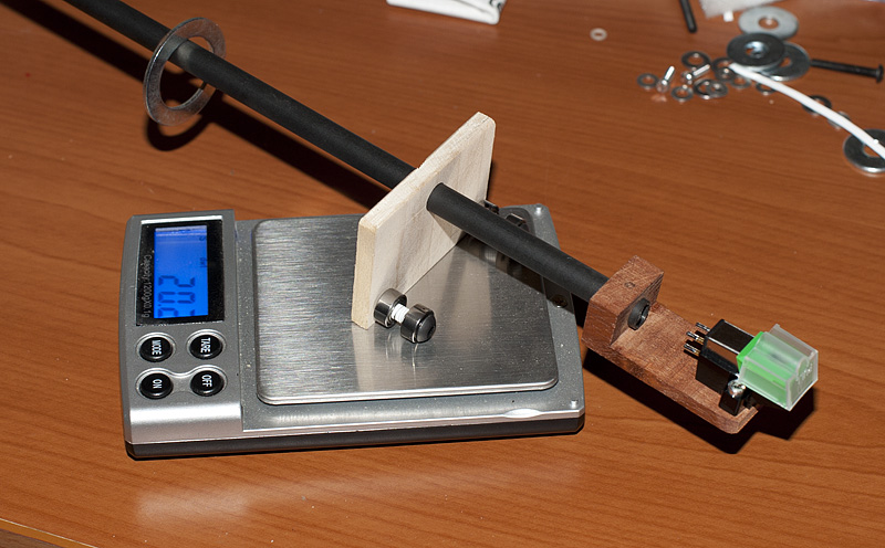

I just finished my test carriage. Including a rough counterweight and an audiotechnica AT95e it is 20.2grams in total.
The square thingy is made out of 50x35x5mm maple, and I could easily make it lighter by using mahogany and cutting the edges to make it a T.
I just had the maple piece already cut to thickness and I was bored to get my miter saw out.
The headshell can also be easily made lighter by making it like the one Colin uses. Meaning cutting the plank thingy and just keeping the base more or less.
About the bearings and the threads, I do not have any brass tubing, and to be honest I cannot justify using it anyway. I know I should trust Colin by now, but it is defeating the whole purpose of using a bearing. If we want double bearing we should use that. Two bearings one inside the other (if we find a way to keep them in place...).
In any case, I have used M4 threads with alen heads. Their threaded part fits nicely through the bearings, but it still had some play, so I used a thin layer of teflon tape. The bearings are now nice and snug on the threads, and I have placed them so that they do not touch either the wood or the screw head. They are not very tight, just snug enough to require some finger force to move on the thread.
Unfortunately I could not find a glass tube so far and the SKF axles were too expensive, so I am making some preliminary tests with a 10mm plexi tube I had laying around.
What I have noticed is that the bearings do not always roll. They slide/rub on the surface of the tube. If I apply some more weight with my hand, they seem to roll just fine.
I had to put some black marker spots on the bearings to notice this.
Have you guys noticed something similar?
My bearings are SKF 4x9x4 closed ones and I have not used any lubrication on them.

Did some more testing...
It seems that which-ever way the carriage moves, different bearings move.
If I move the carriage to the right, I get rolling on the right front and the left back bearings. and the opposite when I move it to the left.

Hi Dimitris ,
Seems that either you'r sliding tube has some deformation , or too much bearing friction for some reason 😕
I'd try to get a glass tube first ... should be a labatory glass supplier in Athens ?? search the web for this as there must be one in such a large city .
BTW .. I like your headshells 😉
Paul
Also ... check the carriage for straightness .. also , the bearings should be positioned 100% perpendicular onto the carriage surface . even the slightest off-axis will cause friction .

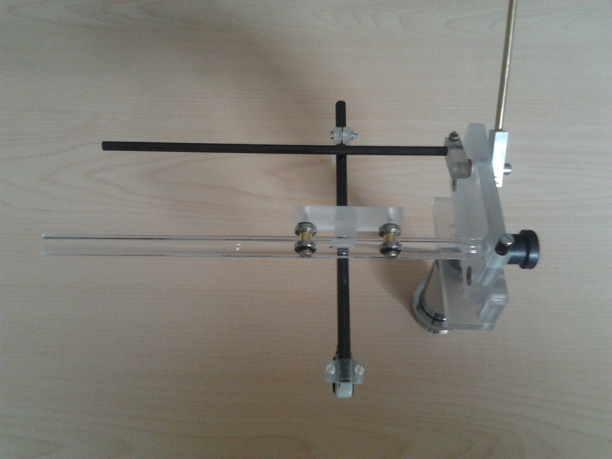

SO FAR , SO GOOD
Well ... looks as I can have it installed on my mass TT plinth pretty soon 😀
I want a support for the signal wiring too , somewhere halve way the wand
travelling ( grooved record surface ) and some kind of loop too have it going
as easy as reasonable possible .. my gosh ... another challenge at this point haha .. nothing for free I guess 😉
Give the guys a call , Dimitris .. I got mine within a mile from my living place
too .. never expected them to be that close too 😀
Paul

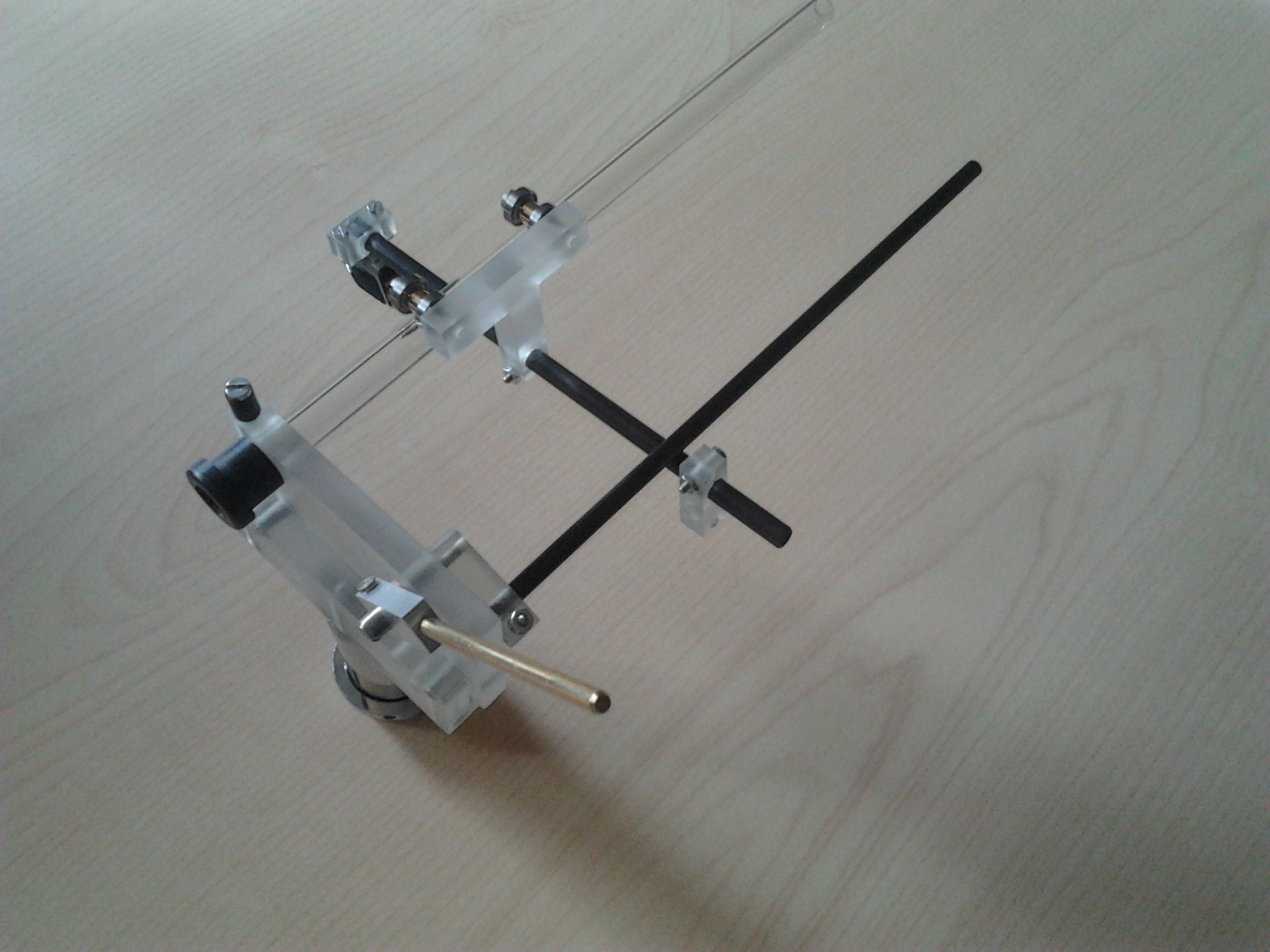

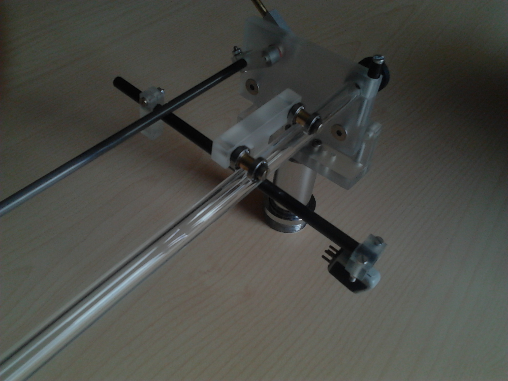

Hi Paul,
would you mind sharing some pic of the arm holder? It seems very well done, and also easy to set up!
Your build is a truly inspiration!
Ciao.
Marco

Closed or sealed bearings will be pre-packed with lubricant.
Maybe best to remove the shields/covers and clean it out?
