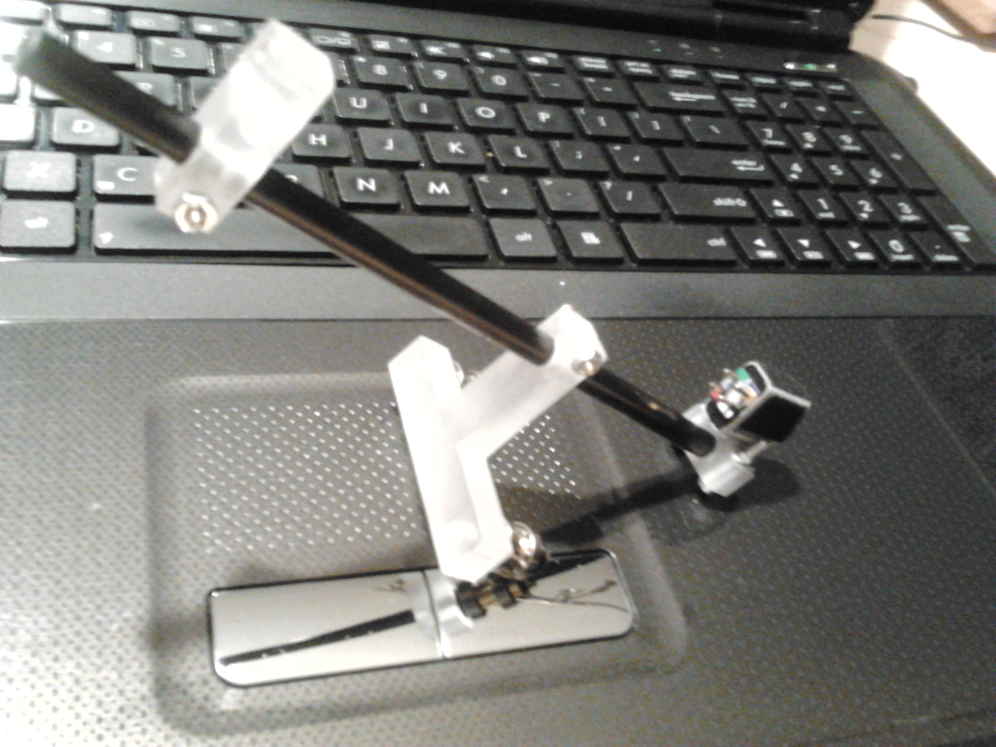

carbon tube / polycarbonate carriage
This is going to work out far better 😛 14 Gramm w/o cart and CW .

How about something like that for the carriage T part?

Golana,
Exactly as it states, platter top to bottom of glass tube.
Polycarbonate is great stuff, easy to work with, easy to cut and holds its shape well. It's also light, and stiff enough for this use.

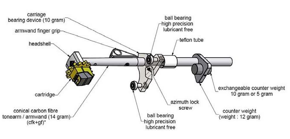

Clearaudio TT1
Another interesting document from Clearaudio is their patent on the TT1. Worthwhile reading:
https://depatisnet.dpma.de/DepatisNet/depatisnet?action=pdf&docid=DE102006052913B3
Wilfried
Wilfried

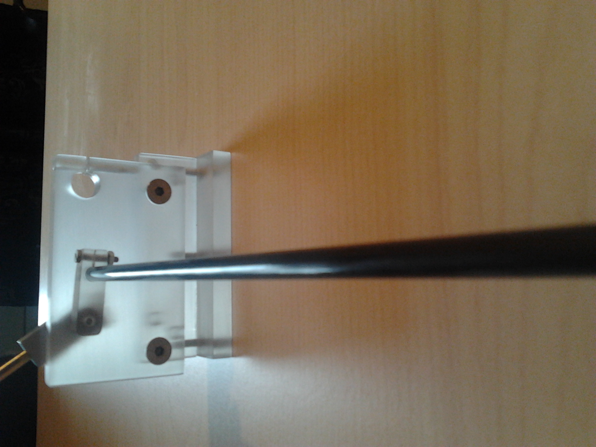

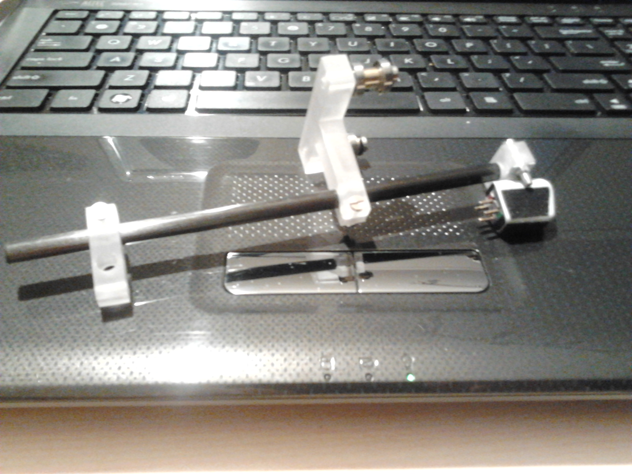

carbon / polycarbonate
Hi there ,
I have attached two shots of the current brew . still some work to do but this is my first attempt . it weighs a very little over 28 Gram incl. a Stanton XV15 body .
There's space on the T-bar to drill a couple 6MM holes .. just in case I'd be in need for further loss of weight . 😀
As for now ... I'm lurking to try the 6MM carbon tube to serve as bearing shims . that would again save weight .. though I'm not sure if it works out .. will see 😀
Also .. I'm at the point where I should start thinking about the right wiring ..
i.e. minimal friction , souplesse , quality etc.
THX for looking and any inputs will be appreciated of course !!

Nice one 🙂
For wiring I can vouch for cardas litz shielded. You would have to run it unshielded for the most length though to allow the arm to move freely.
I also liked some 33AWG medical grade silver wire I found on a local shop.
spinning wheel:
You have done a nice job on the arm. The carbon fiber tube shim will work and save weight at the same time so long as it lets the bearings roll freely. You should shorten the rear part of the arm and use a brass or bronze counter weight and get it as close to the pivot point as possible. When you are happy with the performance/weight of the carriage you can always reconstruct it out of solid carbon fiber to make the whole assembly as light as possible if you wanted.
Joe
Joe
Joe,
This is not a regular pivoted arm,the same rules don't apply. You don't want a heavier weight nearer the pivot here, not only because of lateral mass but because a heavier weight nearer the pivot lowers the vertical effective mass, since its small and already much lower than the horizontal mass we want to increase it. This means smaller, lighter weight further back in the wand 🙂.
Colin
Colin
Thanks for the inputs guys !
Meanwhile the postman brought 5 pcs of Duran glass tubes , very well cutted in lenghts of 25CM . extra thick 2.2MM wall btw ( feels very solid and less ringing if you ask me ) .
I'll take all advices and options into consideration during this project !
For now .. time to cut a couple of different wand lenghts .. some CW inserts
to balance and apply VTF etc. Have some ideas how to do this and will share with you as soon as it works out OK .
THX again guys !!

I think I have just seen ( and realized ) the reason for a light weight CW .. positioned at the end of the tail 😉 .. there's no need for anything heavy on the tail end ... and have the cart + gravity do most of the job regarding VTF .
Than after I have used my scale and set up things for approx. 1.7 Gram VTF .. only than the up and down movement of the wand + bearings is getting as smooth as it gets

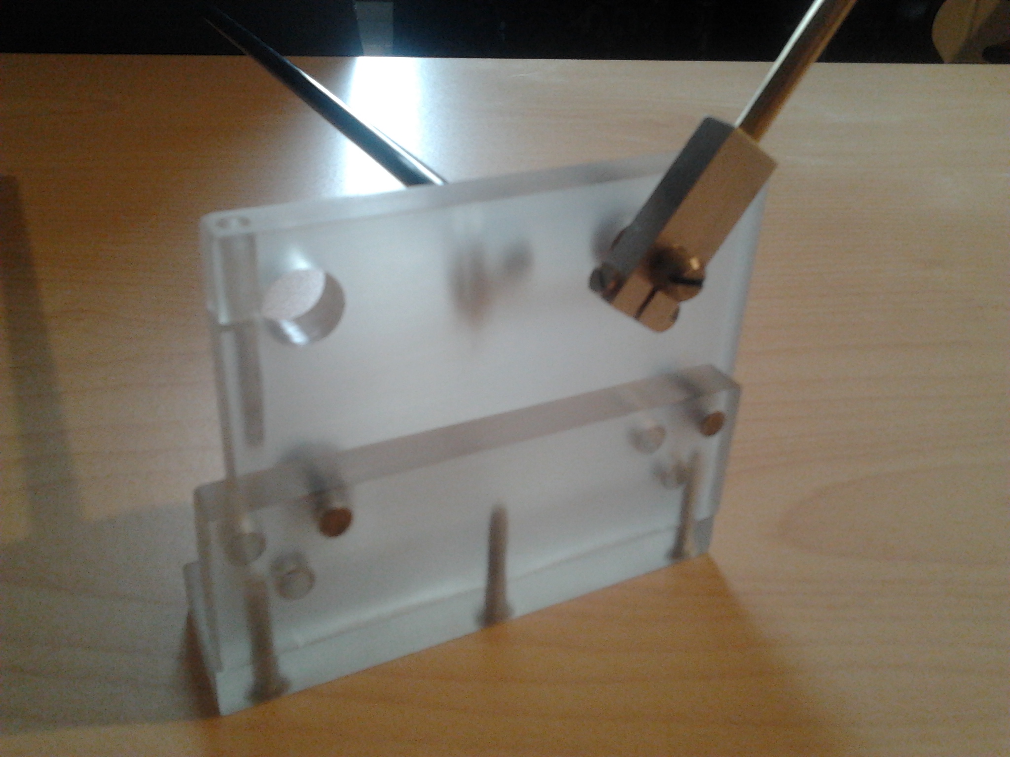

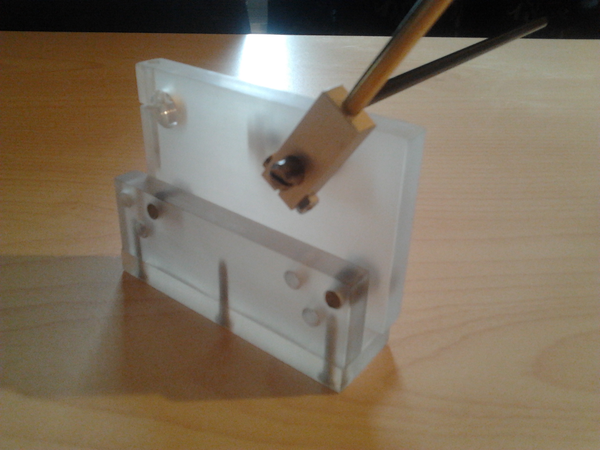

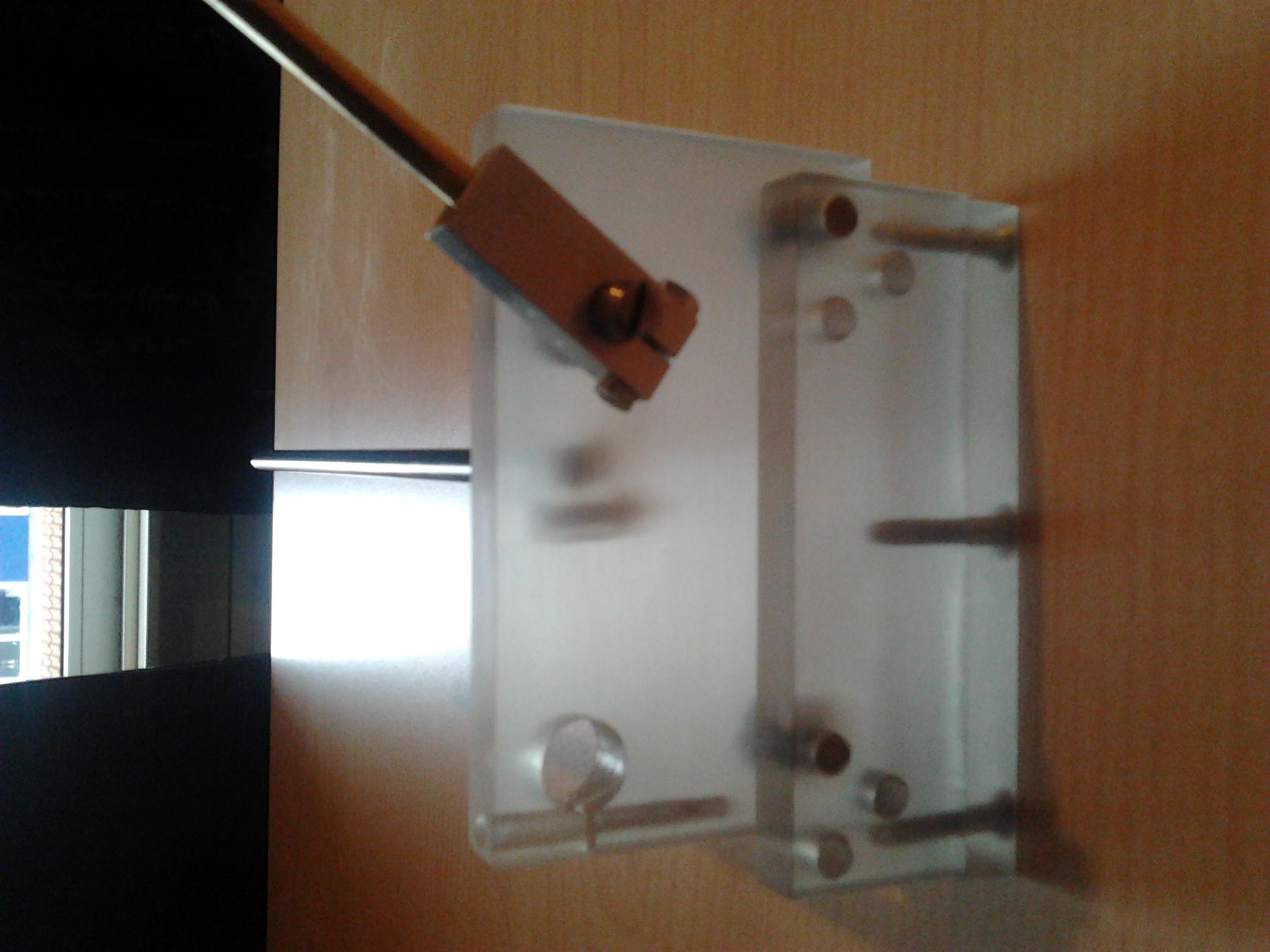

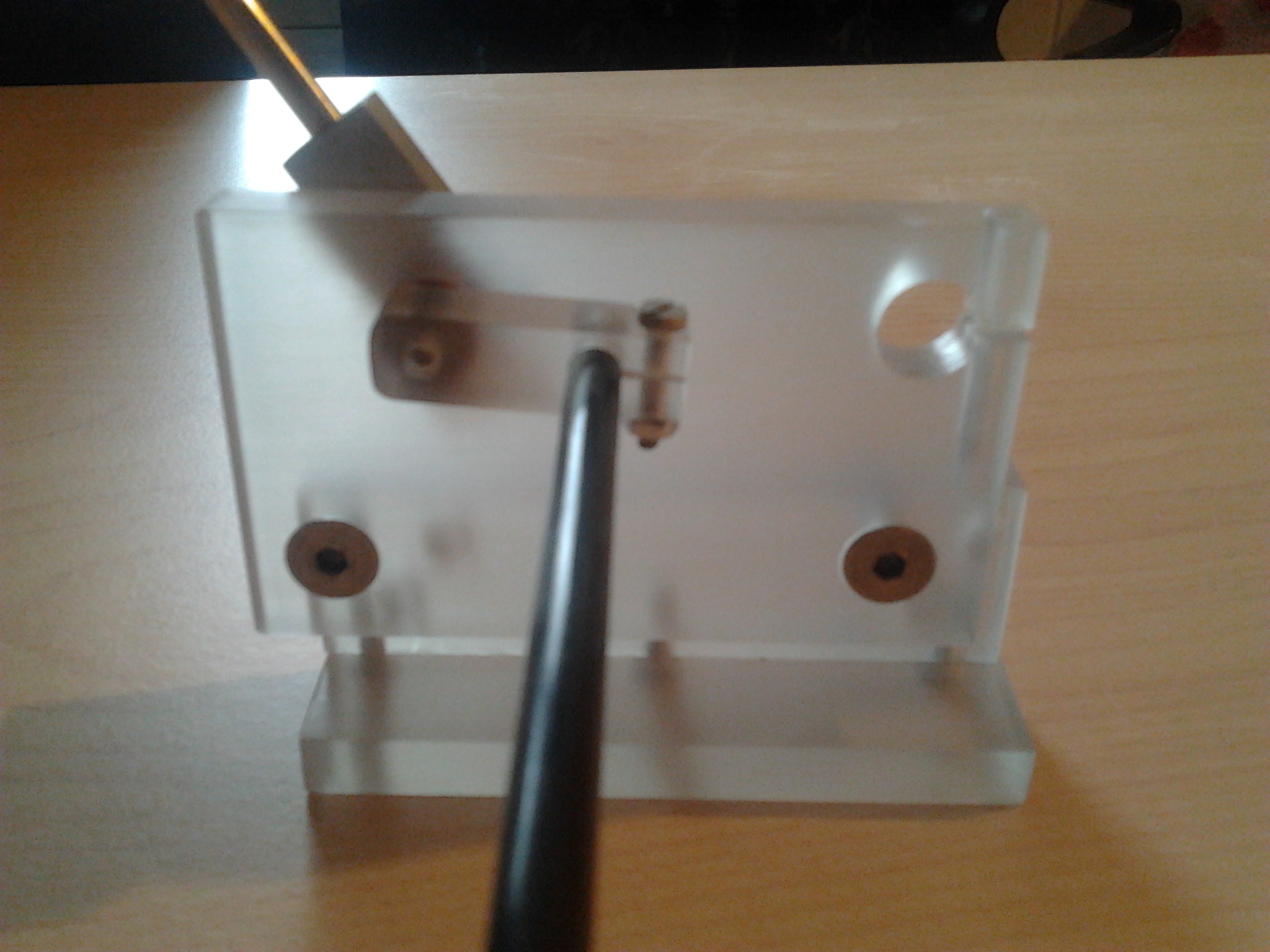

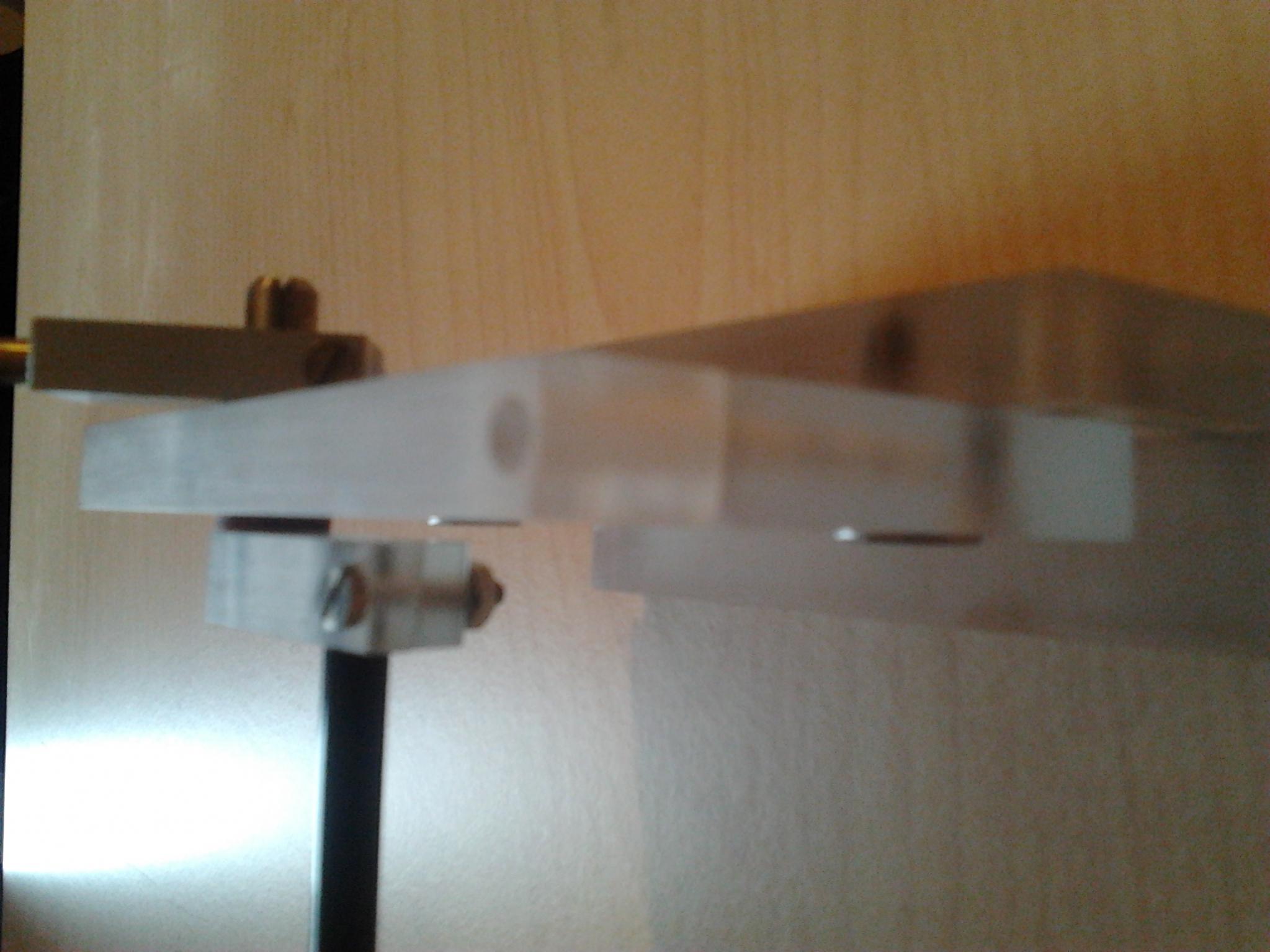

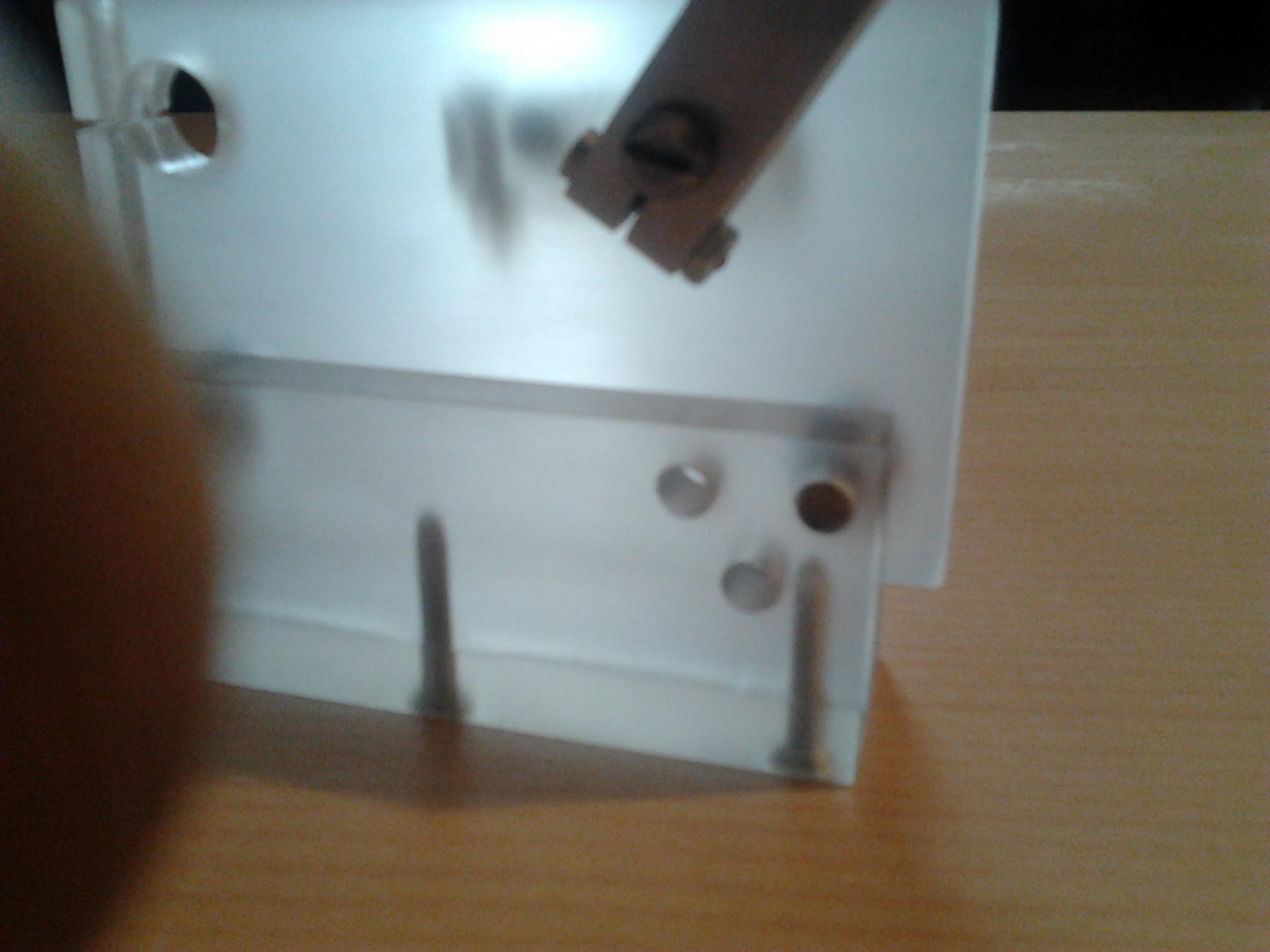

Hi Guys ,
Made some progress in the arm construction . it took me some time to figure
a smooth movement of the armlift and adjusting points etc. , but here some shots of how one and other is looking at the moment .
Have a nice weekend !
Paul
