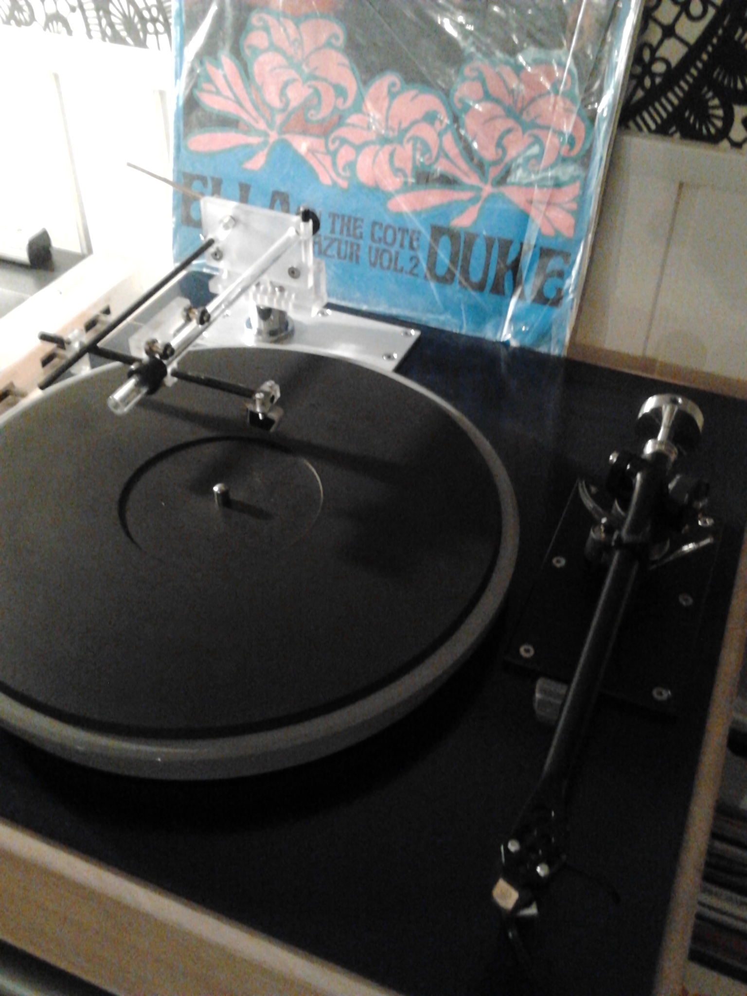

I have just installed the arm on my Lenco deck 😱 looks gorgious 😀
The armboard is machined out a 4MM thick aluminum sheet . tightened to the deck with 8 Torx screws .
Time to manage the wiring and draw myself a tangent protractor in order to precisely set-up the arm .
Think I can have a listen this upcoming weekend
Paul

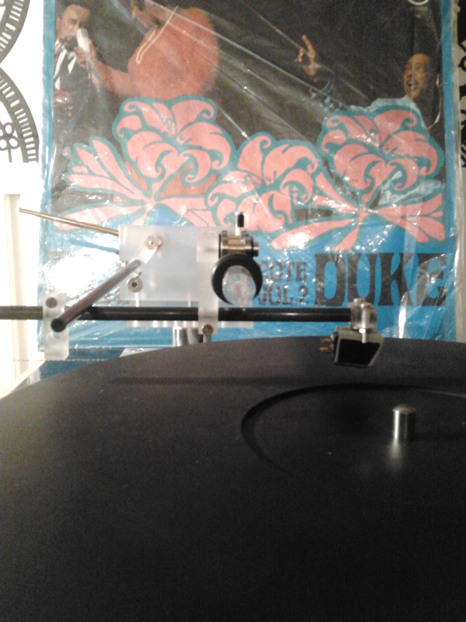

Yep I got two tubes of 1,5m each and I just cut my first piece. I did not see your post in time and I scored an entire circle around it, but it broke pretty evenly. I just put it on my desk with the scored line on the edge and gave it a push like when breaking plexiglass. Super easy.
And the new carriage I am trying seems to work perfectly. Unfortunately the wood was too thin and I managed to snap it, so no photos for you today... Perhaps after my dinner if I am not dead asleep 🙂

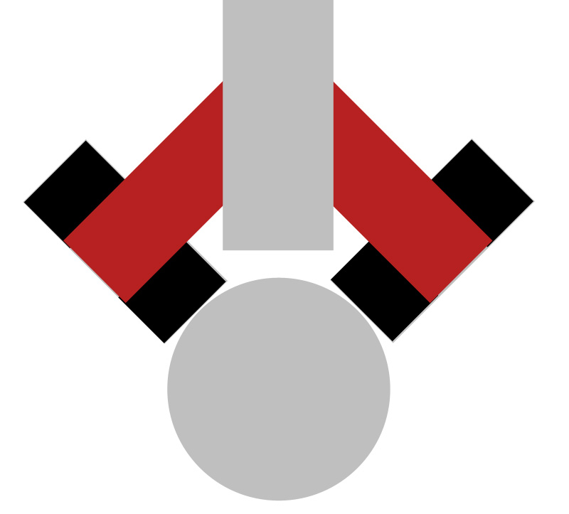

Did some more testing...
It seems that which-ever way the carriage moves, different bearings move.
If I move the carriage to the right, I get rolling on the right front and the left back bearings. and the opposite when I move it to the left.
I managed to figure this out after all.
If you notice the maple square, it is cut with the wood lines vertical. This along with the small thickness made the wood very bendy in the axis of the screws. Not what we want at all.
Tomorrow I will cut a thicker piece and make it a T. I am within weight limits anyway.
About the alternative design, the idea works nicely and allows for a much lighter carriage, but it requires some precision angle drilling which can be tricky...
Here is a sketch of it, looking it from the side.
