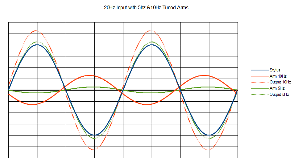

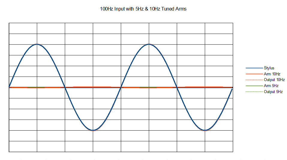

I'd like to discuss the mechanisms by which vibrational energy is transmitted from the stylus/groove interface into the body of the cartridge and by extension the arm. I'm going to say a lot of stuff that you already know. I'm putting it in to help paint the picture.
The stylus moves in what is basically a linear fashion to follow the modulation of the groove. It's movement is constrained to the vertical and horizontal plane. The vertical movement is inclined to about 23°, the tracking angle. This angle is not important to this discussion. Technically the stylus travels in an arc due to the pivoting of the cantilever. This angle, even at its maximum, is very small at less than 1/4 of a degree. So there is virtually no rotation of the stylus.
The cantilever is compliantly attached to the cartridge. The compliance is set so that it is stiff enough to allow the arm to be moved at very low frequencies, such as those produced by record warps and eccentricity, and flexible enough to allow free movement at higher, audio band, frequencies.

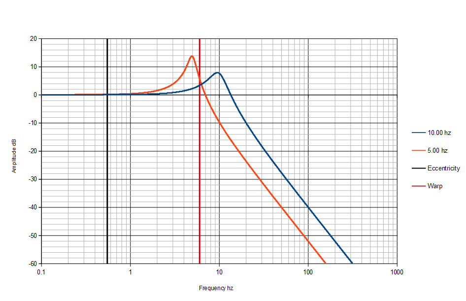

In combination the mass of the arm and the compliance of the cartridge will have a resonant frequency. Well below this frequency the arm will move with the stylus. Well above this frequency the arm/cartridge body will remain roughly stationery as the stylus moves back and forth. It is this relative movement that powers the output of the cartridge. The resonance is normally set to be between 8-12hz so that it is above the frequency of warps (up to ~5hz) and below the audio band, starting 20hz. Ideally we want the cartridge body to remain absolutely stationary relative to the record surface as any movement will be output as if it were groove modulation.
Unfortunately the cartridge does move relative to the movement of the stylus. The amount of this movement decrease as the frequency of movement increases. The amount of cartridge body movement decreases by 12dB/octave. At 20hz the cartridge body's movement is typically only 10dB below that of the stylus. This means that the cartridge body is moving more than a quarter the amount the stylus is. By the time we get to 100hz the relative motion is down to -40dB. This chart shows the movement of the cartridge body relative to that of the stylus, the frequency response.
The blue trace shows the typical response of an arm cartridge tuned to 10hz. The orange trace shows the response of an arm tuned to 5hz. As you can see the resonant peek now sits in the frequency range of where warps occur. This could cause serious tracking problems. You will also notice that the orange trace is 12dB lower in level. This would result in the cartridge body moving only a quarter as much as in the case of the arm tuned to 10hz. For a typical cartridge with a compliance of 16μm/mN the effective mass would need to be 16g to achieve a resonance of 10hz. To a achieve a resonance of 5hz the effective mass would need to be increased fourfold to 64g.
Warps only occur in the vertical plane so the vertical effective mass wants to be kept in the normal 8-12hz range. Laterally we only have eccentricity which is at a much lower frequency, 0.55hz for 33rpm. The lateral resonant frequency can be set much lower without fear of being excited.
Below around 120hz records are only cut laterally, there is no vertical modulation. This is to prevent the stylus from being flung from the groove.
The vertical and lateral compliance of most cartridges differ by about 25%.
As the frequency range and compliance are completely different vertically and laterally there is absolutely no reason to make the vertical and lateral effective masses the same. By making the lateral mass much higher the response in the bass is massively improved.
By the time the frequency is up to around 100hz the relative movement of the cartridge body, both vertically and laterally, is very small.
These two plots show the actual amount the cartridge body moves relative to the stylus. At 20hz there is a huge difference between the 10hz and 5hz tuned arms. At 100hz, before there is any stereo information, the difference is very small.
