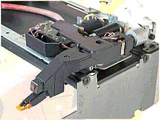

Once I had a Philips automatic turntable that featured a linear arm. It worked with some stepper motor and feedback to control the movement along the track. Sounded decent. Very inspiring project, it tickles my diy nerves to go along this route. Not easy but as you write very rewarding 🙂
http://www.grammofoon.com/Philips/Philips_70FP440.htm
Hopefully not too far off topic... this tone arm worked with a servo, controlled by a photoresistor and controller. Would this be of interest to imitate?

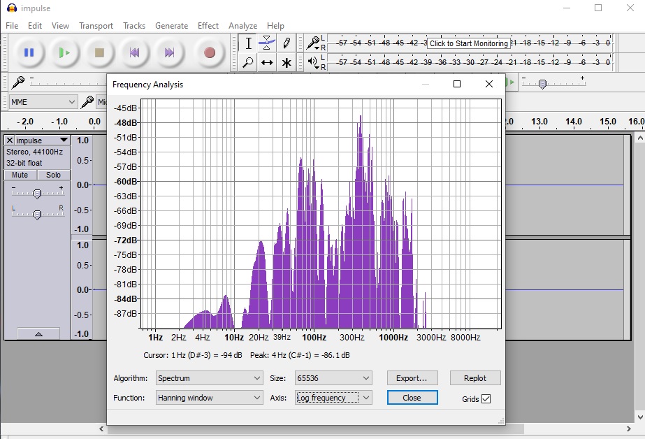

I know this is off topic but thought I'd post these for anyone interested. These are the impulse tests between the R/B and Permalli plinths. The motor and platter were moved from the R/B to the Permalli plinth and the impact was at the same place WRT the platter and TA mount. Measurement was taken with the stylus sitting on a stationary LP at the output of the phono-pre.

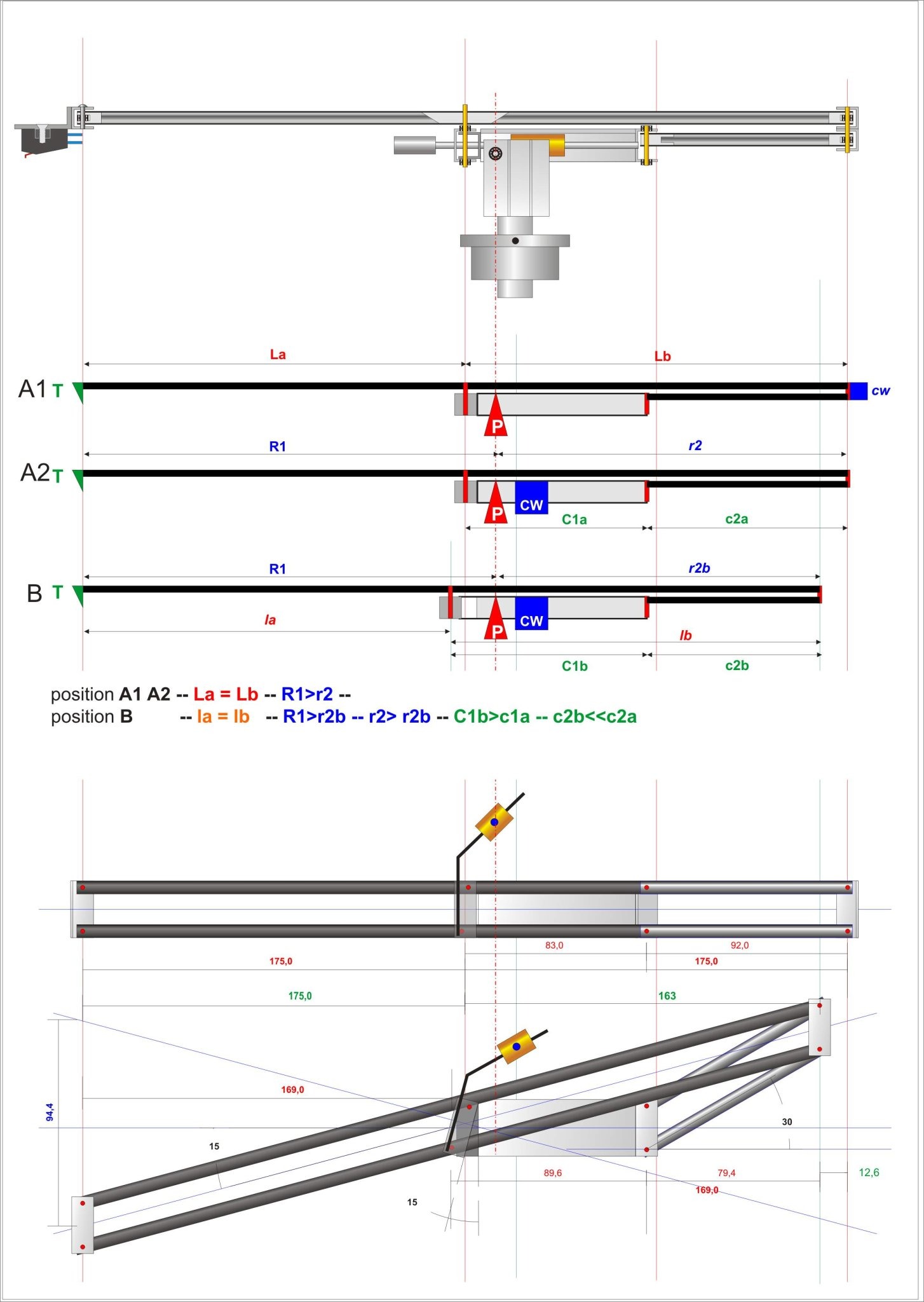

This arm is really a challenge, now I've discovered that the solution designed for the CW is not enough for the task.
Since the projections of the distances La=Lb and la = lb are always equal, the way to have a constant CW balance seemed to make the pivot P aligned to the intermediate joint.
I wasted some time on it but it seemed not feasible, so the vertical pivot was brought as close as possible, hoping that in this way (A2) the variation should be minimal. So much that in the mockup a <15 grams CW very near to P is enough for balance.
But there was still a variation of about 1/4 VTF (!), and surprisingly not too different from A1 solution
No idea how to bypass this issue, but friend Mike(56) gave me the right hint:
"Any horizontally turning lever can be picked, and add an orthogonal lever in opposition to the shortening lever length will generate the compensation torque?"
And here we are:

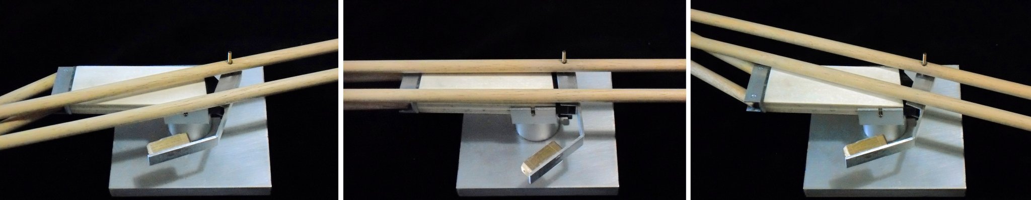

the center lever (better the short one with its greater angle) is the only one that moves back 'n forth = the right way to balance the VTF variation. A tuning weight is attached via an angled rod - the 90° side determines the shift length - and the 45° one + the cw mass determines the recall.
The device works perfectly: simply taped to the mockup, the VTF variation is now under 0,1 g and can be tuned to zero.
With the further advantage that the center lever that helds off axis all the moving parts, now is somehow balanced by the side cw.

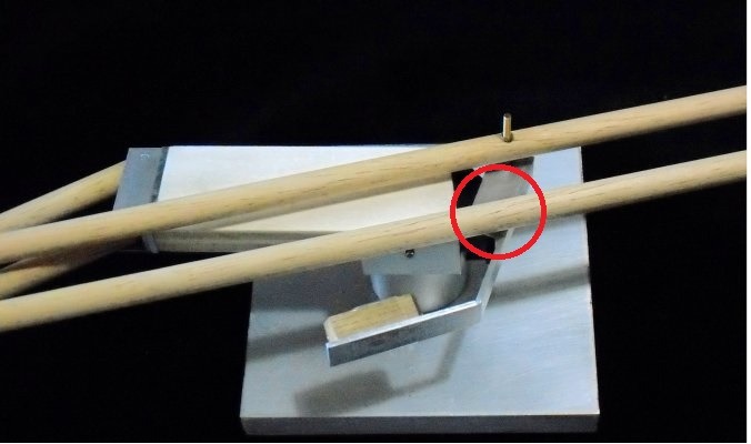

Carlo the reason VTF is varying is because the arm circled in red is moving forward and backwards WTR the vertical pivot. Have you considered moving the vertical pivot to the cartridge end like the Dynavector this way you could increase the horizontal structure beams hence increasing rigidity.
View attachment 1202402View attachment 1202403
I assume its the other way round in the measurements, Permali first, not in the order of the text? BTW, can you scale them to the same vertical axis, to demonstarte the difference.

I'm not a fan of pivoting tangential TA's... #5075
The funny thing is that I agree - at least in part - Warren: and from experience (a pair of good working PTTA done in the past).
But since this pivoting linear has nothing to deal with pivoting tangential TA's, the only way to get a sensible opinion on a new (?) completely different geometry (line, not Thales circle) and force distribution is to understand it first*, and then to explore practically its effective geometric and mechanical feasibility.
Frankly, the fact that the mockup with wooden bearings passed without skipping my eccentricity test, difficult for many linear trackers, forces me to go on.
carlo
*eg, the reason for the VTF change is that all the levers shift forward to the 3 fixed pivots, but the rear control levers at twice the angle of the main ones; The position/relationship of pivots is strictly determined.by the Peacellier AP=BP condition; how could be used the split plane strategy?
