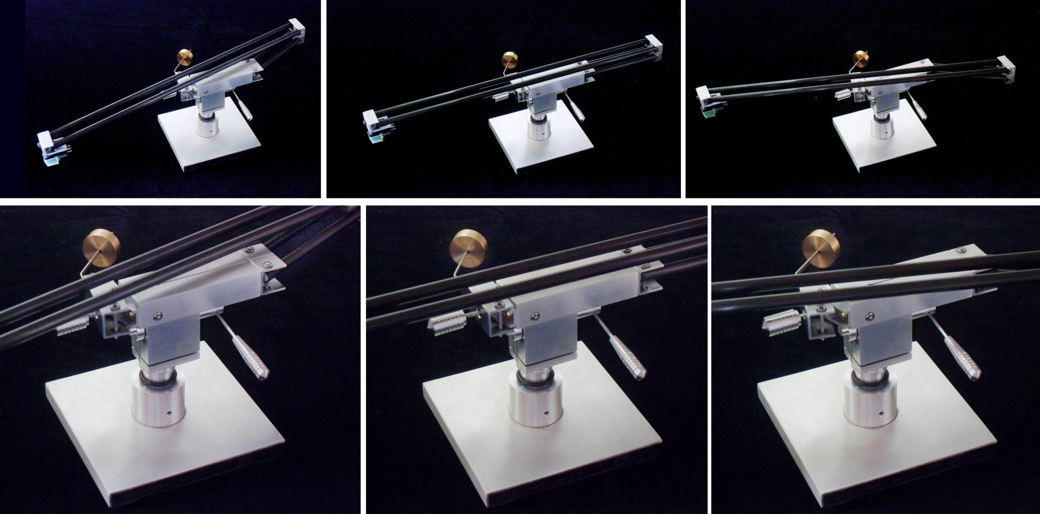

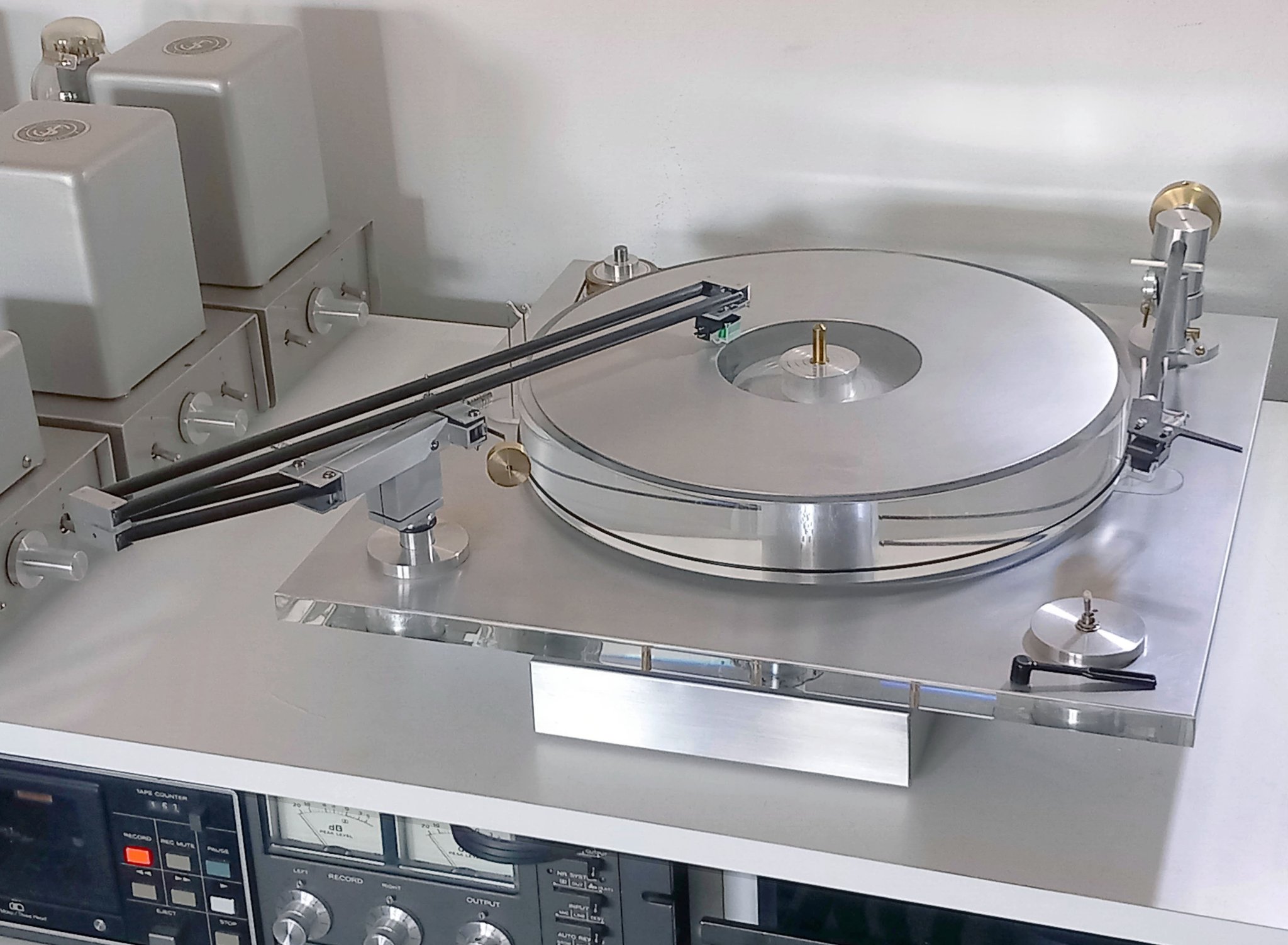

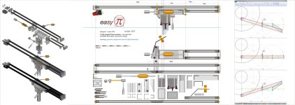

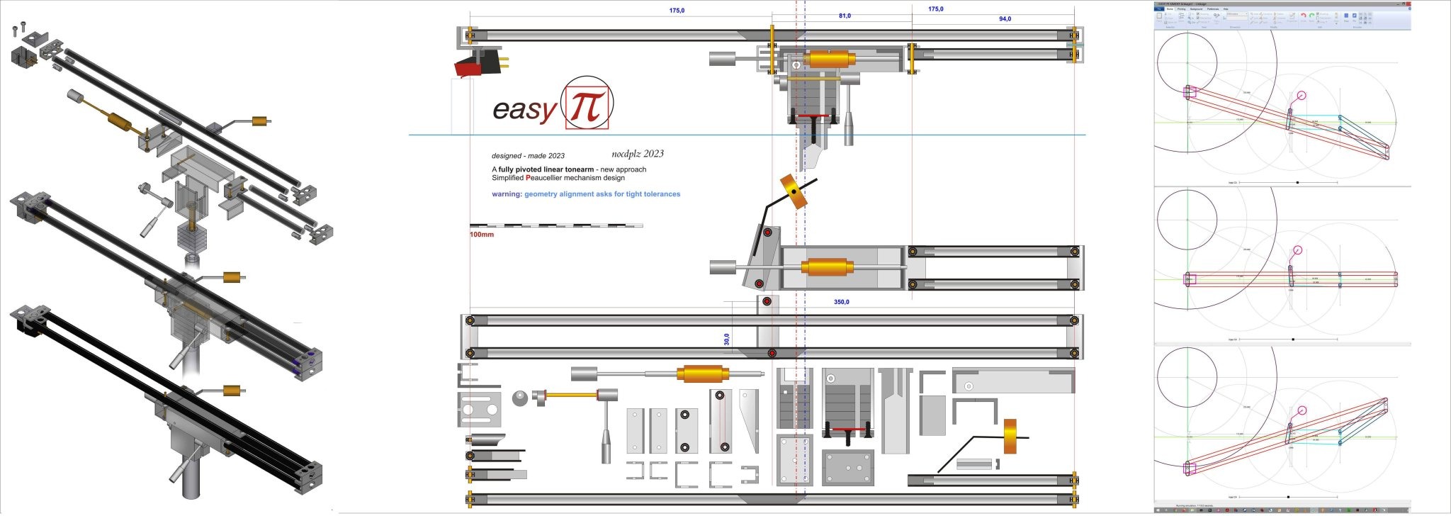

# 4611 to # 4947 et seq. The no-rail linear TA problem
Done, and working smoothly.
Attachments: simulation - design draws - photos of the tonearm - "crash test" videos
ciao - carlo
special thanks to Mike and Doug for their precious advices... and patience.

Impressive design, but IMO the main advantage of linear tonearms is when they are short (3 - 4 inches) to control stiffness / resonance.
This arms seems to be some 14 inches long; I wonder how much is "gained" overhang-wise when compared to a normal pivoted 14 inch tonearm.

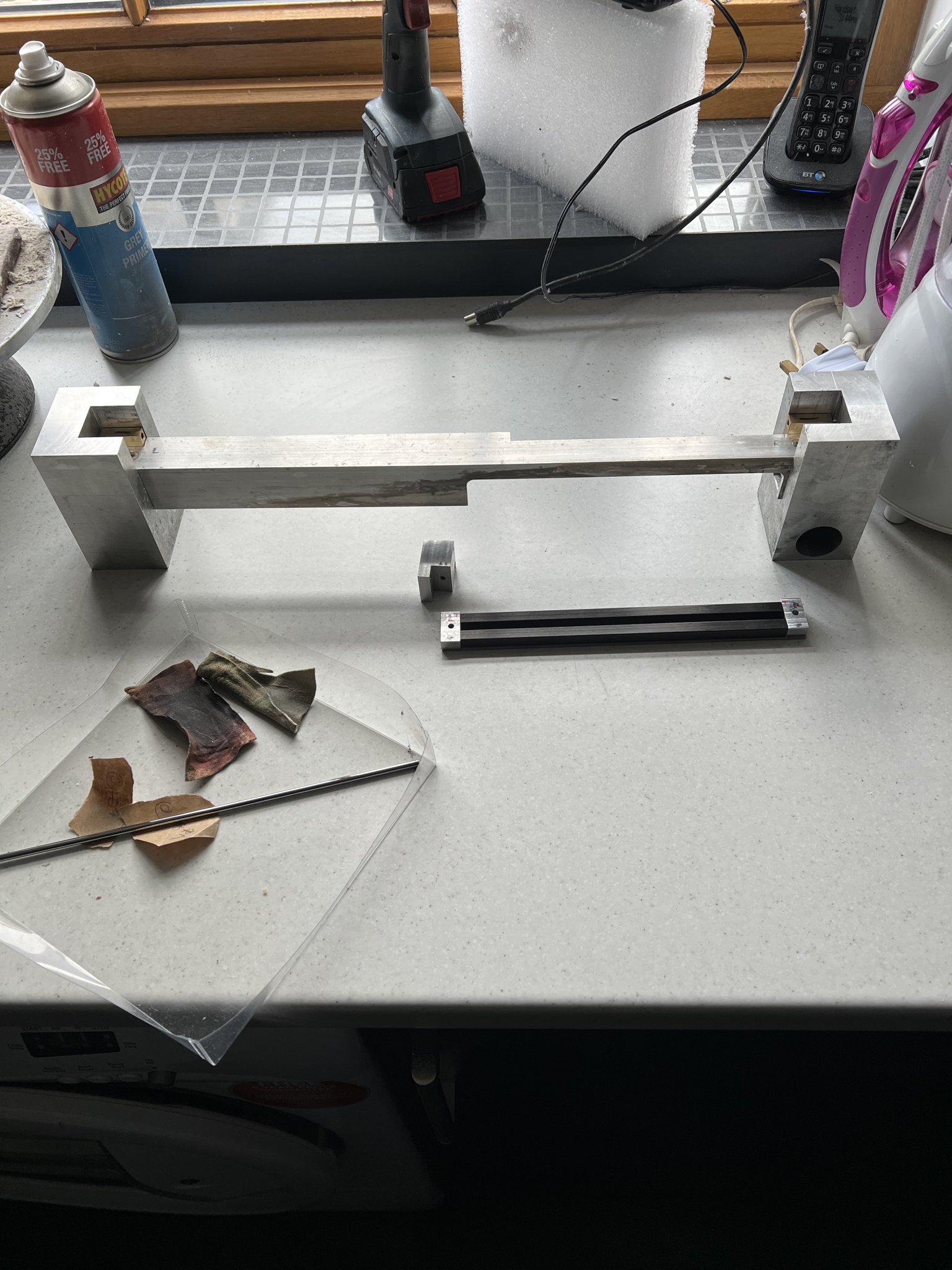

Hello everyone, I feel I’m very late to this party but I’ve been enthralled by this thread for months, some truly ingenious ideas! I’ve finally gathered together some materials and commenced on a variation/combination of Niffy and Warrjon’s design, see progress so far. The plan is to use this LTA on my Garrard 401 with some kind of custom plinth. I’m having trouble sourcing the vee bearings as from reading in previous posts many of you have experienced similar problems. I’m based in the UK and Truepoint’s website keeps redirecting me somewhere else? Have any of you found alternatives in the UK or have any of you over ordered and have spares which I could purchase? Also @warrjon a few threads ago, I see you machined a pocket carrier for the 4mm TC rods after experiencing adhesion problems with the epoxy. I was literally about to mix up the araldite when I read this! Is it due to the extremely smooth surface finish on the rods, @niffy are you seeing similar on your composite rail block or should I just throw caution to the wind!?
Sether

Sether, great to see you following some of these intriguing constructions, no doubt influenced by the fine work these folk do in setting out information and opinions, like Niffy, NOCDPLZ and Warrjon in recent posts, and many others in the past.
We look forward to seeing your progress, i am interested to know what you are running at the moment?
As you say, it makes enthralling reading and i would like to take the opportunity to encourage such contributions and thank them for their efforts, as they constantly inform and challenge my thinking!
More please folks, any time you're feeling informative!
M
Hi Mike, thank you for the kind response. The knowledge which all the contributors have is simply incredible, it’s such a shame i came across this thread so late. In the true spirit of diy audio I can see many similarities to the Clear Audio design but with significant gains through group prototyping and subsequent improvements, truly astonishing…and on a budget! Reading back through the thread I can’t help thinking about the pin bearings and that something I use with my work would have perhaps been an option which is TC tipped engraving tips, the type used for cleaning fossils?! This is of course before the implementation of the far more accurate sapphire vees and TC pivots. I might have to try these if i fail to source from the UK. My interest in HiFi is quite broad, from restoring vintage speakers to complete speaker builds. I attach image of a horn which I’m working on utilising a planar magnetic mid/tweeter. However, my current setup which is sounding quite beautiful is a pair of 50 year old KLH model 28 omnidirectional speakers with a pair of omnidirectional super tweeters which I’ve built using AMT drivers.
