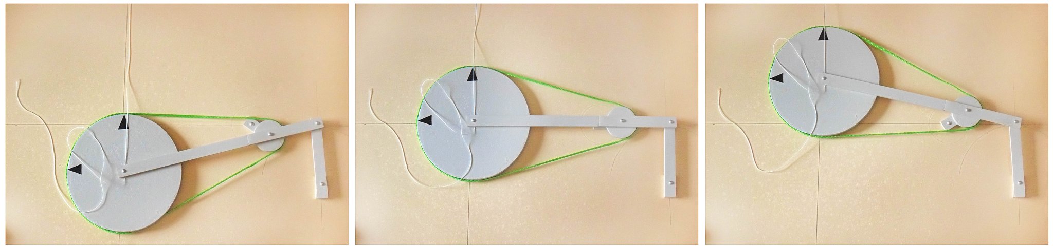

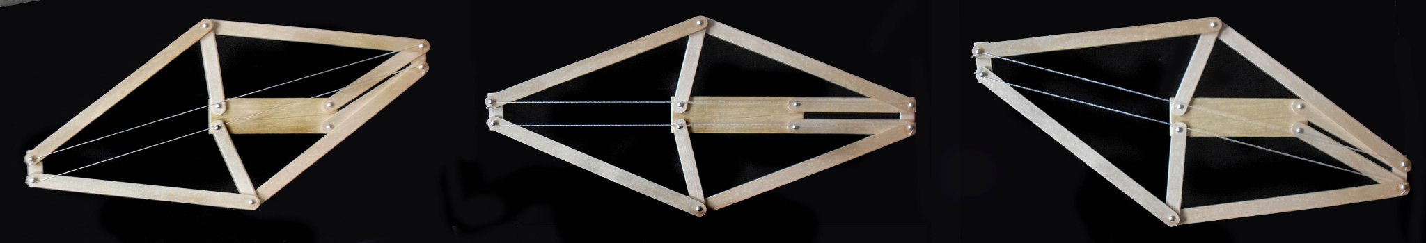

Not being able to replicate the simulation #5037 of the linear movement despite some hints from Alighiszem (mine are all locking on the horizontal) i went back to the dear old wooden mockups of the past.
The string test confirms that the mechanism works fine with the Side Force (no lock up -some variable traction) while it it doesn't start at all with the Stylus Drag, totally dissipating it
I've also completed the Twin Peaucellier mockup with the two strings of the simulation #5029, and it works smoothly: string tension is ok, no lever needed. Sooner or later i'll have to build a working prototype...

Trying to better understand the vector breakdown I made this lever version simulation, for those allergic to pulleys...

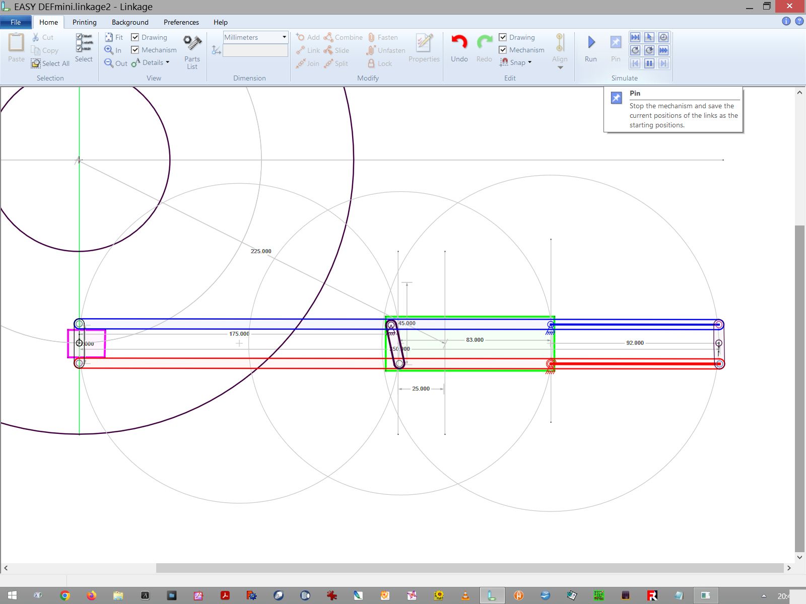

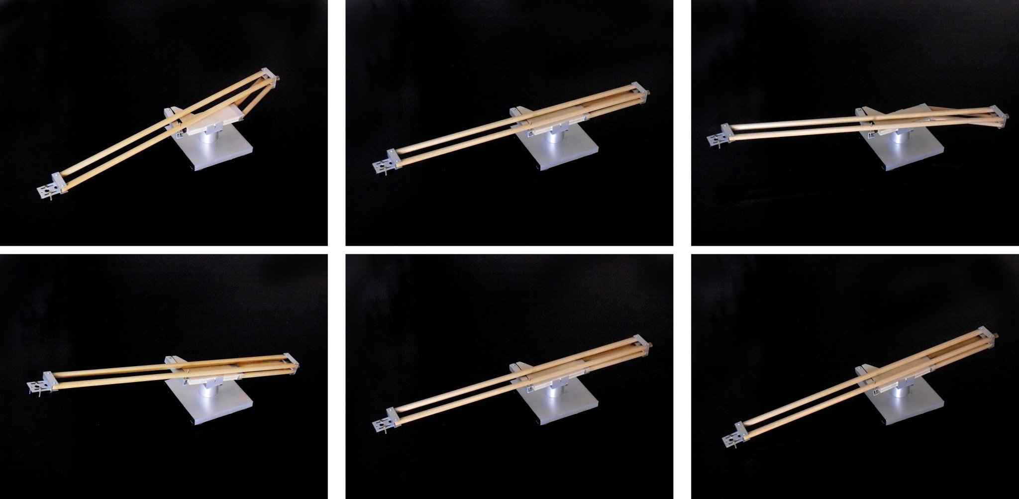

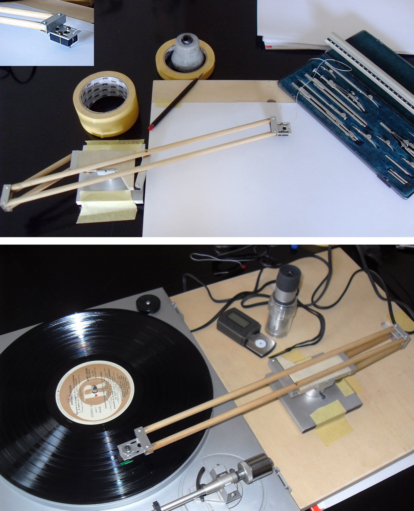

after #5044 simulation tuning, back to reality
..more than a mockup, (much) less than a prototype...

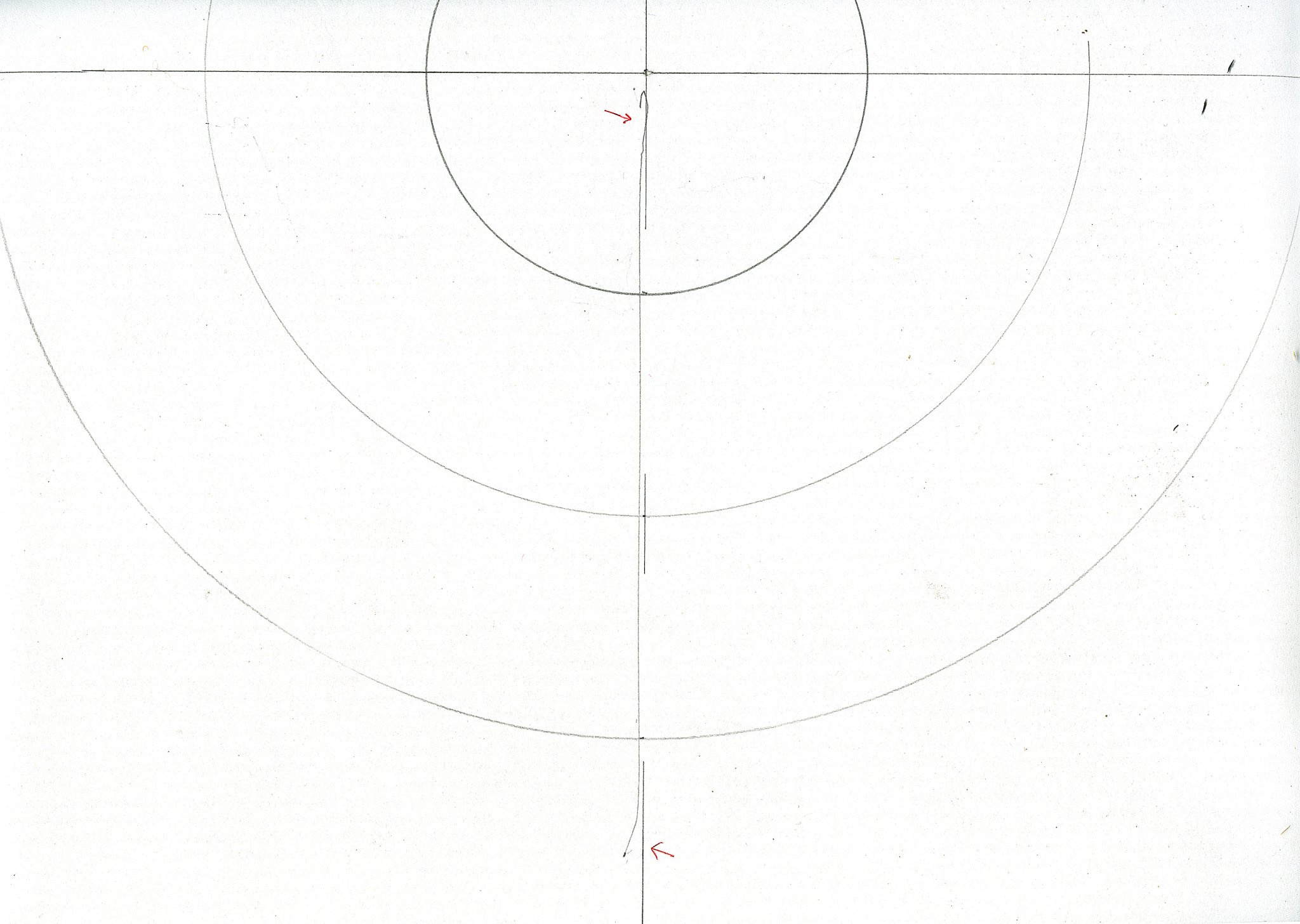

but equally surprising, because also done in this rough way with aluminum rivets on wooden bearings (!) this gadget doesn't skip, and bypasses the +1,5 -1,5 mm eccentric test - not trivial even for many Cantus clones LTAs. Of course with visible cantilever bending, but without skipping the AT 95 with 2.0 gr VTF. - Attachment 1, 2
Also the geometry is near perfect - the pencil lead tracing shows a nice straight line. - Attachment 3
Frankly I hadn't hopes for it, so I was laughing alone while wondering about that behavior, like when seeing first time the radial rail in action.
What would Monsieur Peaucellier think after 150 years? Maybe that this lame son spoils the beauty of his perfect mathematical achievement, but will the same be able to earn an honest living playing vinyl.
Thanks for your patience - c
if someone is interested i may collect some infos about geometry tuning - forces in action - tests observation/thoughts for a serious design and realization of such a nowheels true linear.

String test - sure, it's mainly done for that. Confirms the favorable simulations in Algodoo: the SD behavior is complex, I'll talk about it after further checks

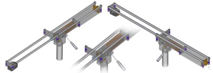

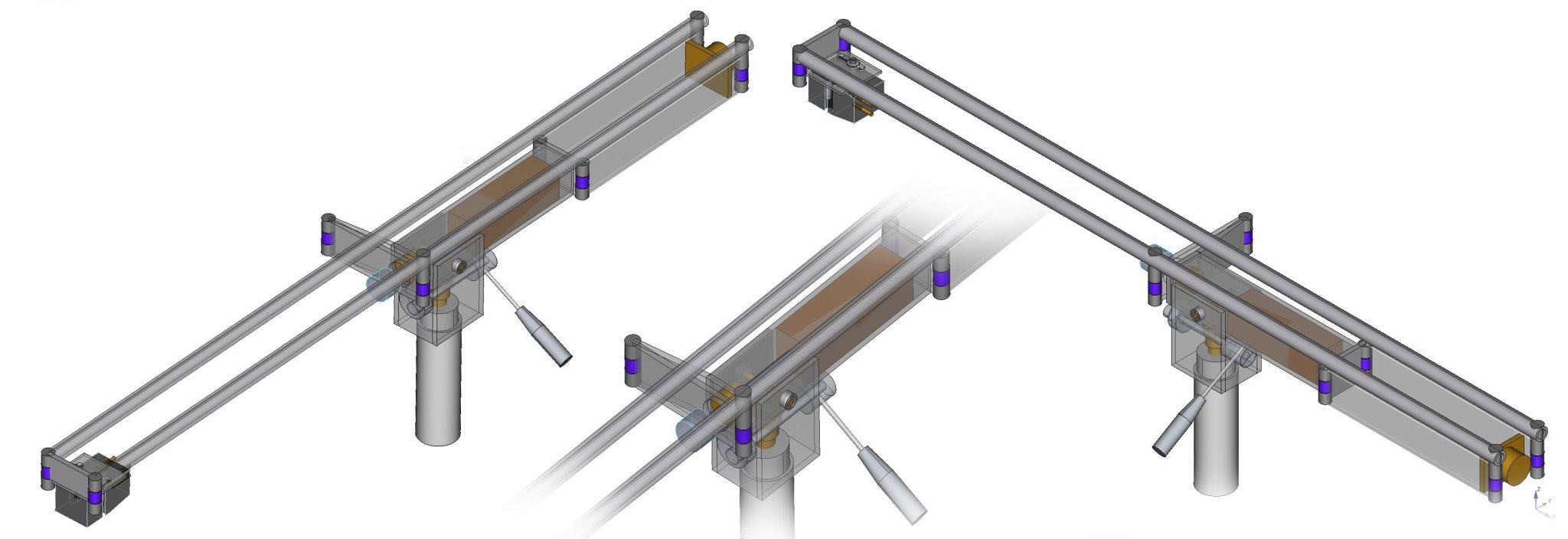

CW + vert. articulation- the answer in the drawings #5048; in the mockup there is a brass Cw simply glued under the main body, and a small VTF tuning on the rear.

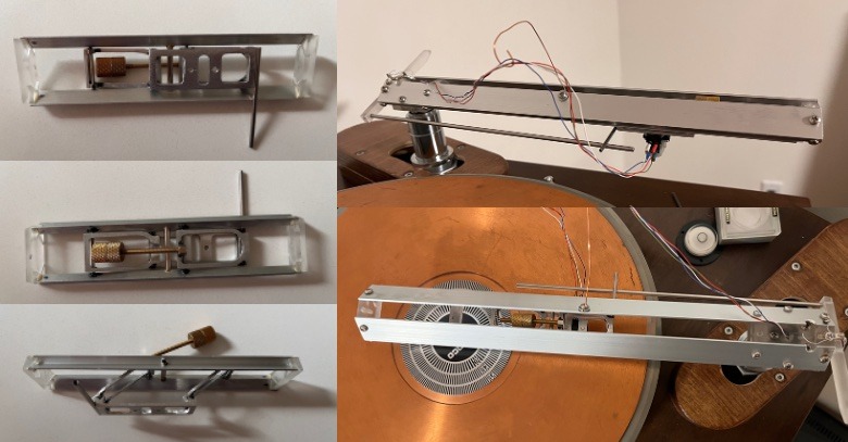

Thanks Carlo, don't have same skill so trying best to make it easy 🙂
The cable is actually softer than most magnet wire (have to hang it there otherwise it drops down), pure copper litz sounds nice too (compare to silk/cotton covered 7x44ga litz)
ABEC-9 got from aliexpress is very smooth and no play (was using abec-3), it's not rust proof though as first batch was a disaster after cleaning up the oil.
Looking forward to your new experiment.
Cheers, Wei
I use 8 strands of 0.08mm magnet wire 2 strands per run. This is far better and has less influence on carriage movement than the flexible wire I used previously.
2 strands are twisted together then cut to make to make the 4 runs. each channel L & R are then twisted together. I also wind the leftover around both channels which becomes the shield for the open wiring and is connected to the ground in the cable and the phono pre.

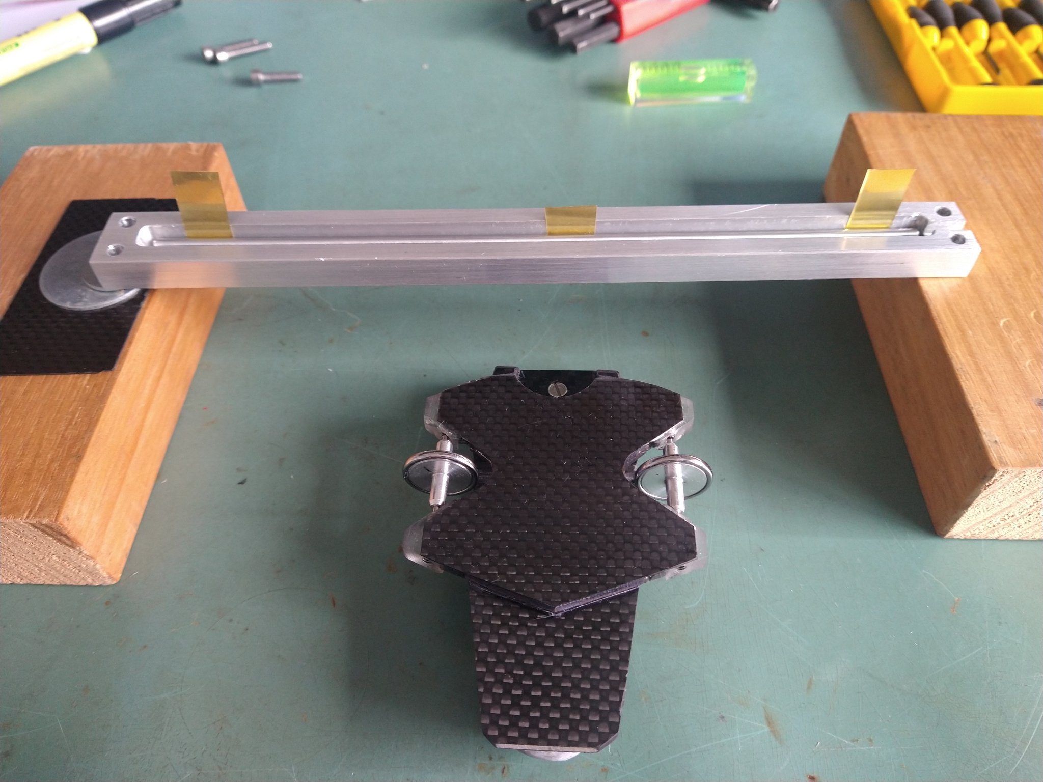

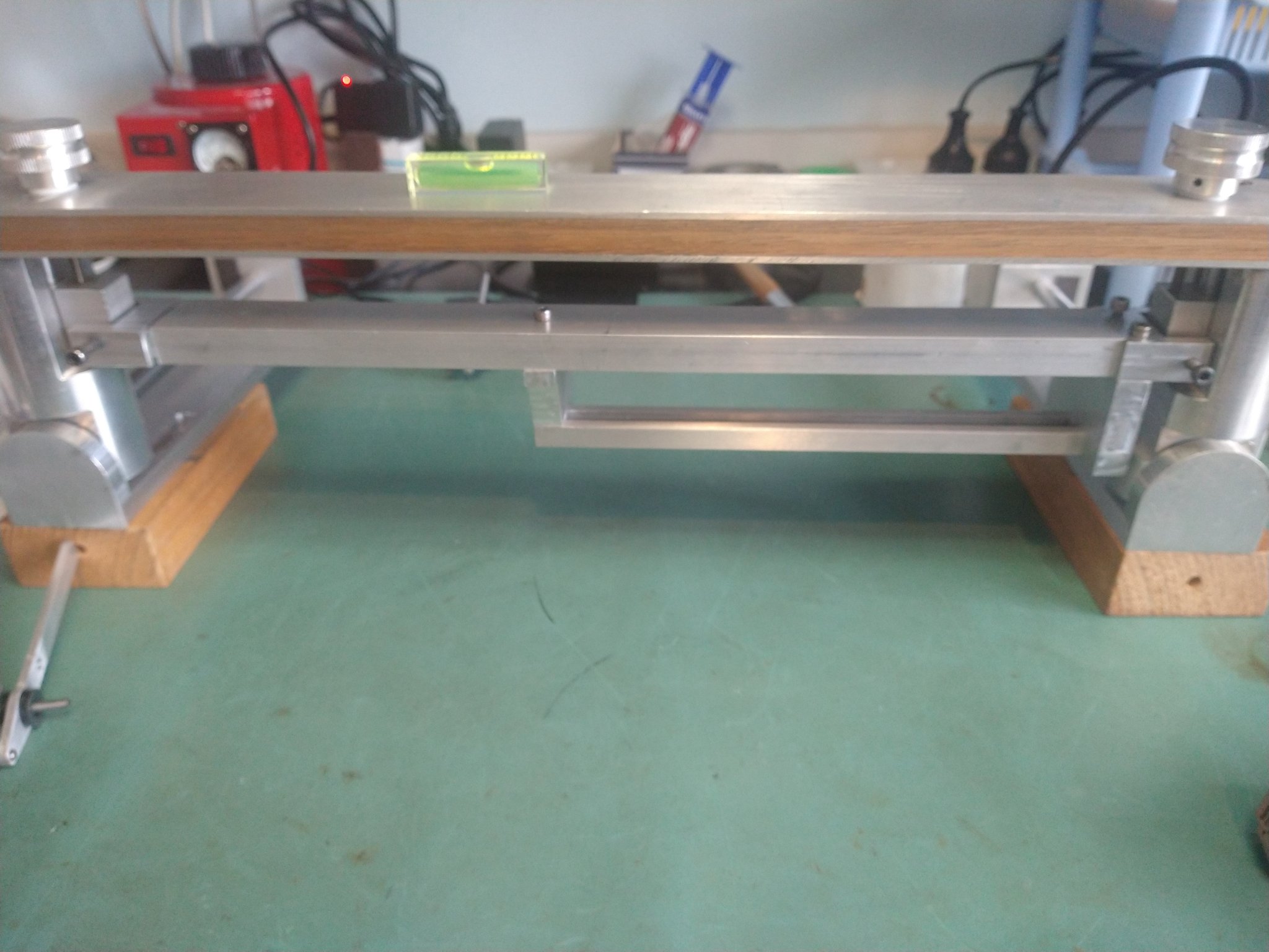

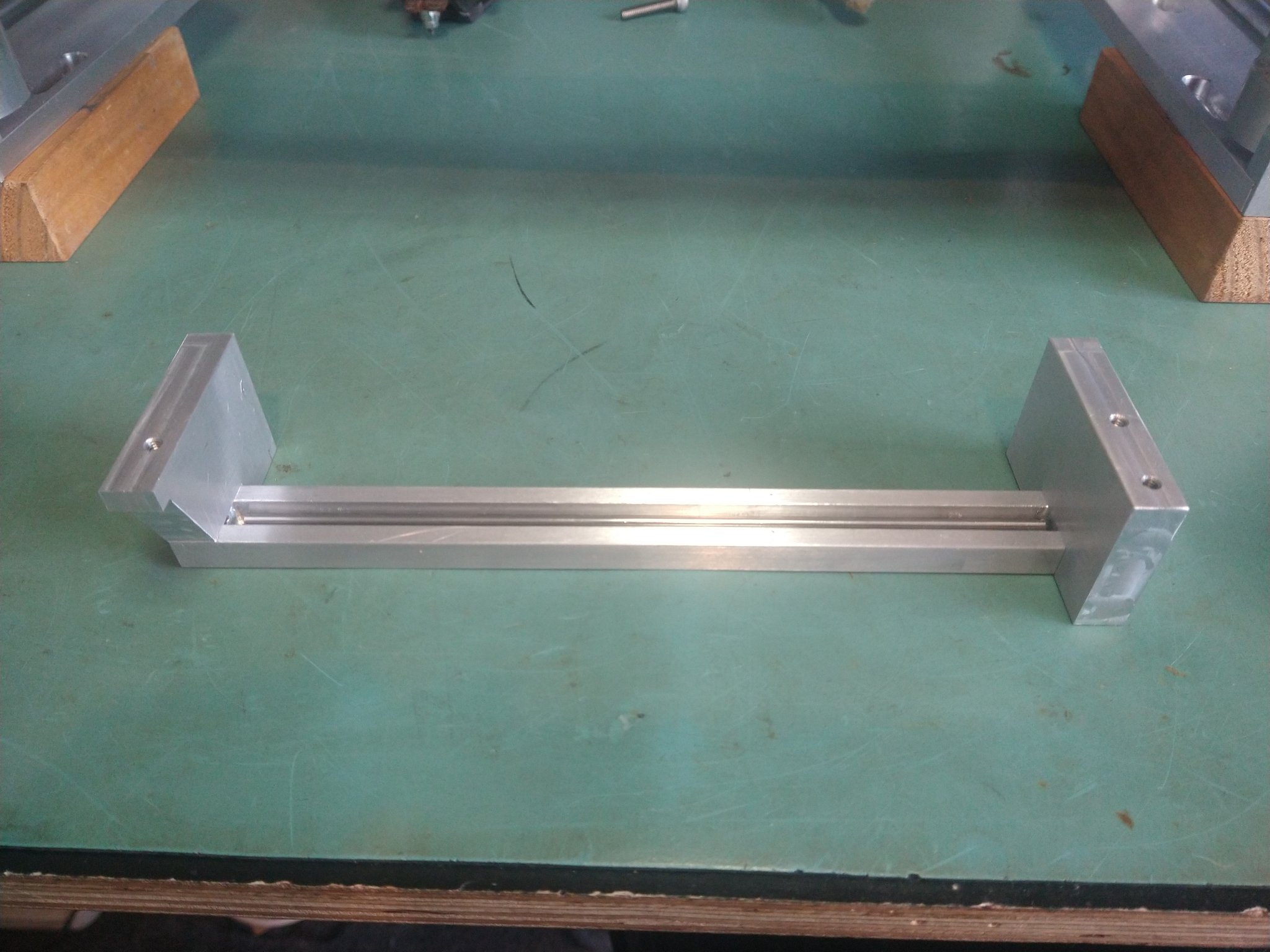

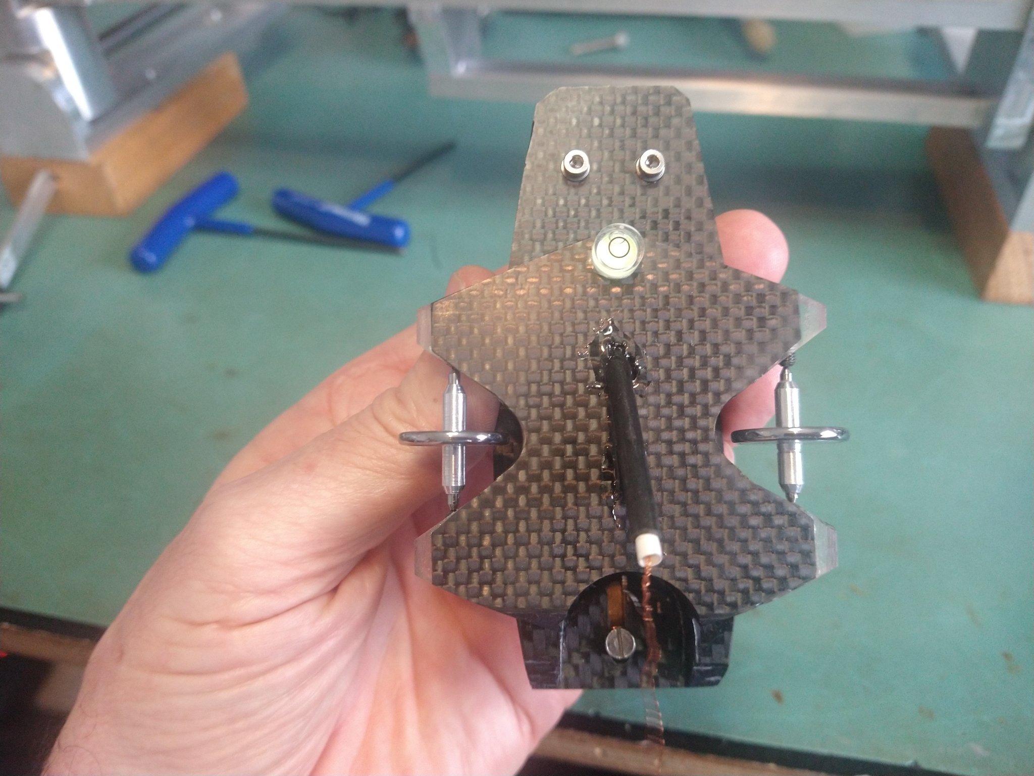

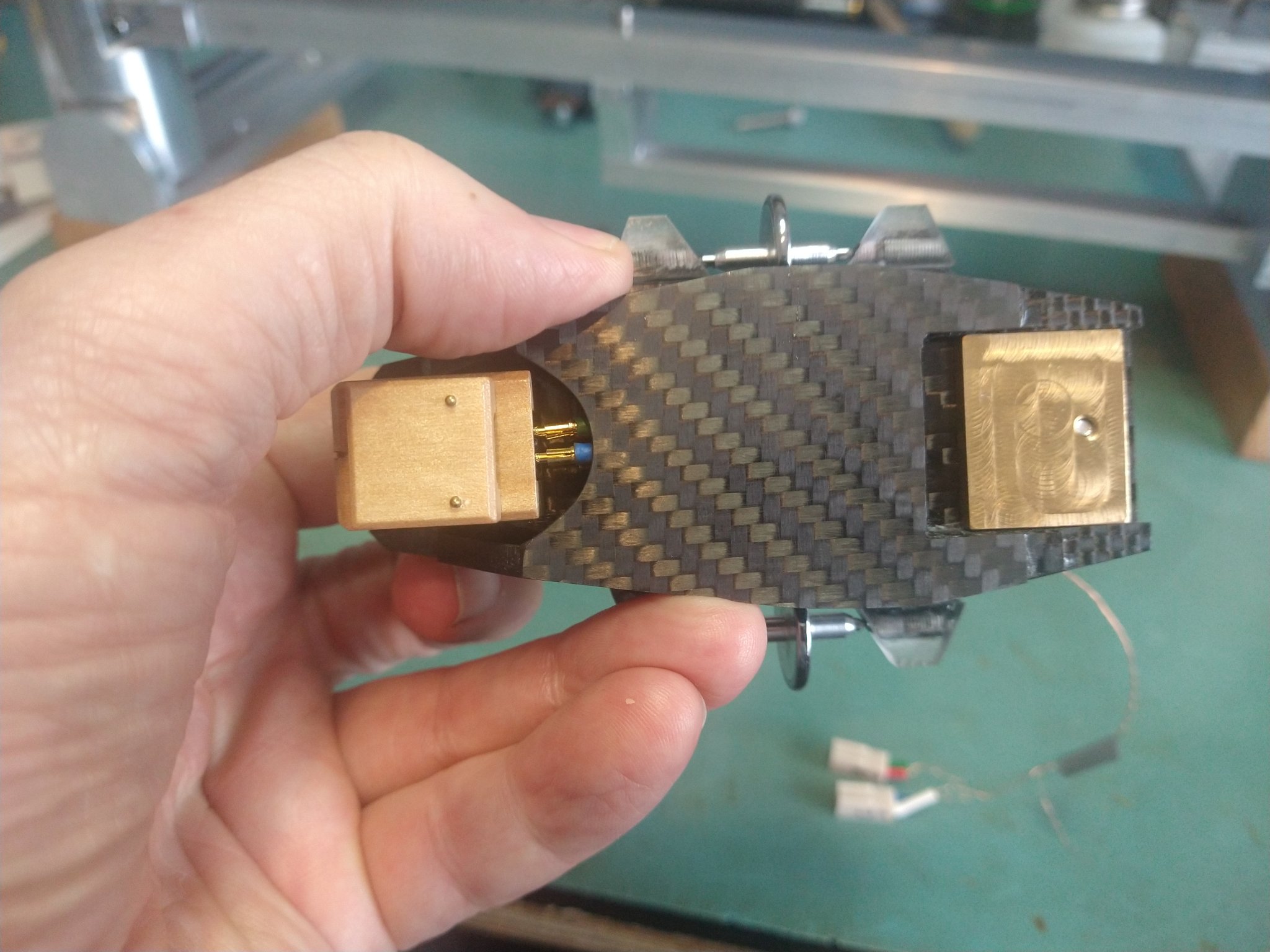

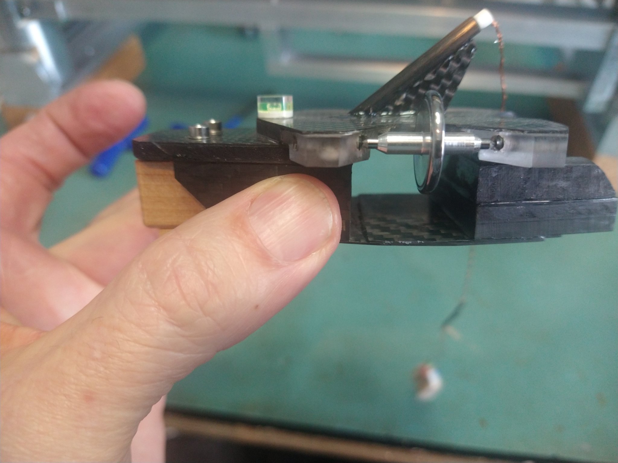

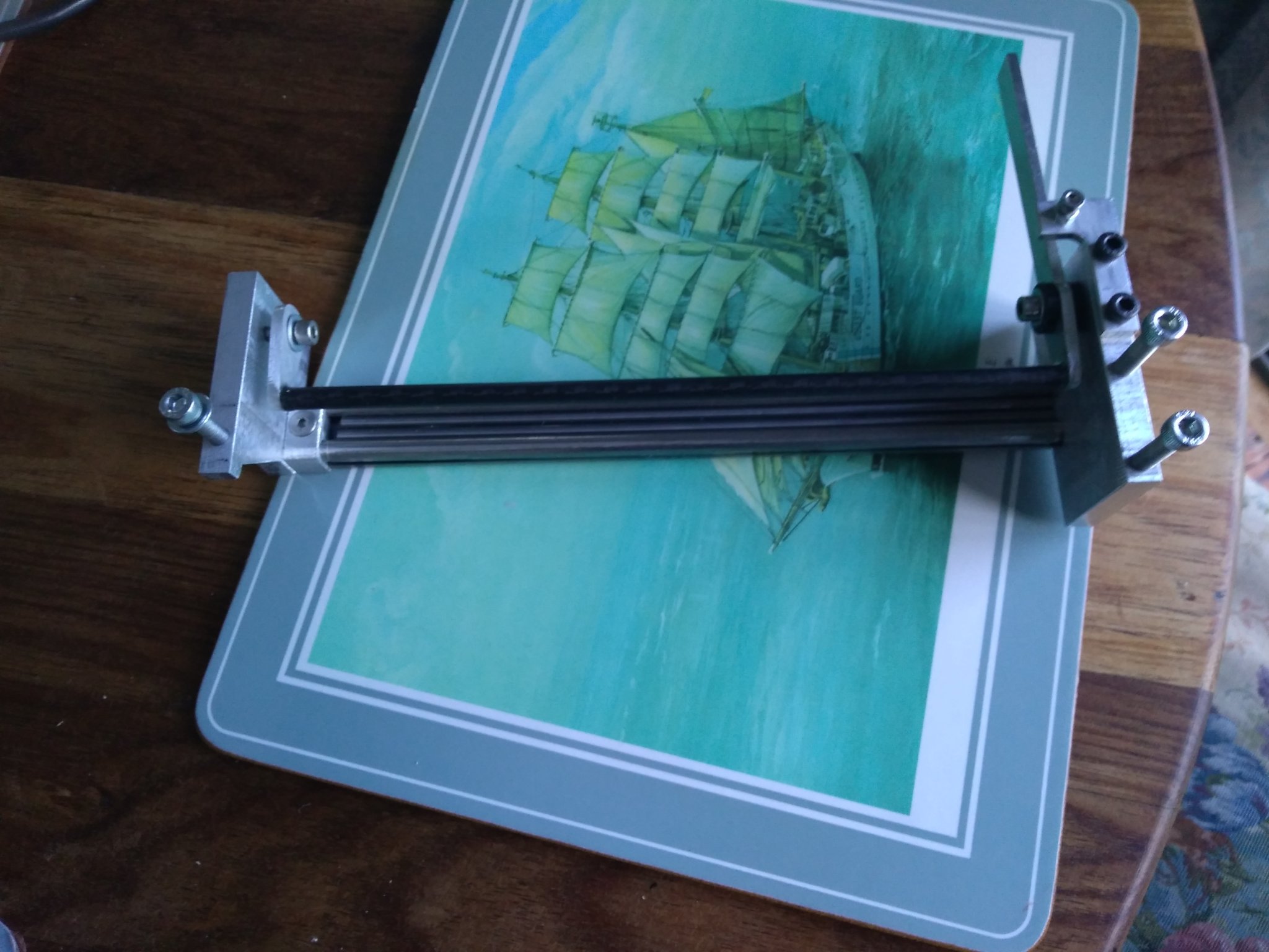

I rebuilt the rail and rail carrier for my LTA to increase rigidity and swapped the M3 setscrew Vees for sapphire. The improvement is quite noticeable. The biggest noticeable difference is in click/pop suppression.
The old rail made in the same was @niffy did his fell apart when I removed it. The epoxy had failed on the SS rods compromising rail rigidity. The new rail is solid 20x10mm aluminium with a pocket machined for the 2x 4mm carbide rods. The rail carrier was also increased in size from 20x10mm to 30x20mm with a beach laminated beam inserted up the center to damp as well as further increase stiffness.
Pics in order Original rail, new rail prior to gluing the rods, new rail and hangers, new rail and carrier mounted on the bridge, last 3 are the carriage with new sapphire Vee's
