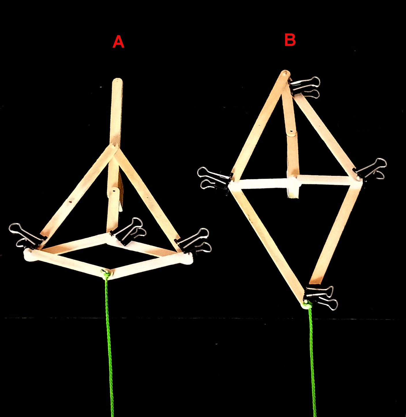

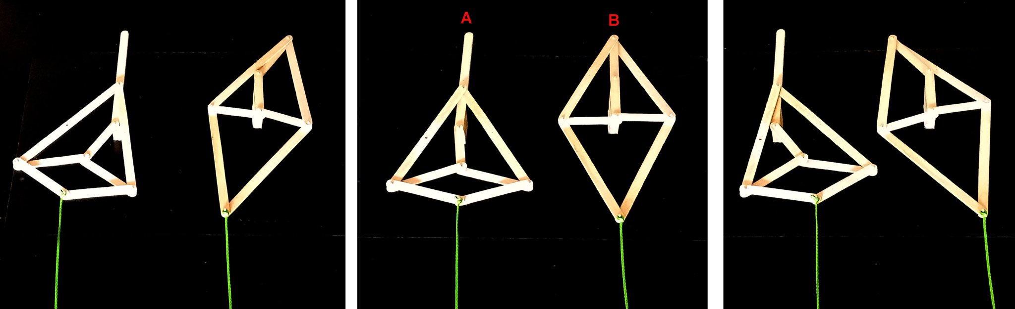

If things were simple (i.e. if the rhombus were rigid), my little knowledge would be more than sufficient, and you would simply be wrong.
As I (and others) had already explained in the post #4957 (I repost that graph with further clarification).
Things instead are not simple: I redid the string tests of the Peaucellier type A (the best known) and type B (more suitable for our needs). Previously I had built just a type A mock up, thinking the B behavior was the same
Instead:
- if the rhombus is rigid - string test 1 - both behave exactly as expected, i.e. left - null - right skating
But when the Peaucellier is free to move - string test 2 - we notice (to my surprise) that
- Offset skating is much less than on string test 1
- In type A we have left - null - right skating as previewed
- in type B -- surprise - we have the opposite right - null - left skating (maybe because is an "inversed" A type?)
This is what I can observe on these rough mockups.
So, more than simple lessons, I need someone able to define and calculate in details this complex mechanism

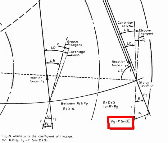

Here is the only correct definition of skating. It can be tested in reality and it makes sense theoretically.
A tonearm doesn't skate as long as the line between the needle point of a cartridge and the pivot or the virtual pivot (for tangential pivot arms) is tangential to the groove.
In the definition above, the word, tangential means a lot. It involves friction and geometry.
By the definition, Carlo's model skates. Just as Warrjon correctly pointed out. It doesn't skate only at one point.
The Theta angle is what counts, not the offset angle. (Angle between groove tangent and effective length axis).
"Ray's string test is based on offset angle only".
Not true, it is based on the same Theta angle.

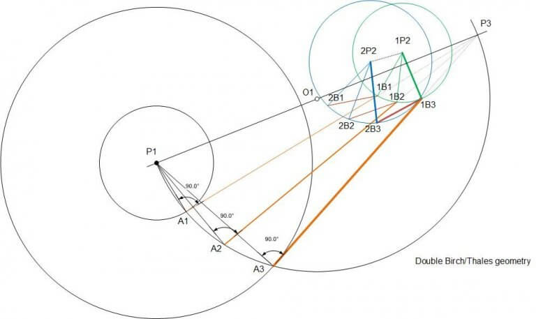

This video proves that the movement of a Birch tonearm (blue) is rotation around the center of the Thales circle and simultaneous rotation around the stylus.
I don't know what you are talking about. This is Birch style tonearm. In the diagram, 01 is the center of the Thales circle. P3 is what I called a virtual pivot. There is no physical pivot at P3, but an imaginary one.This video proves that the movement of a Birch tonearm is rotation around the center of the Thales circle and simultaneous rotation around the stylus.

Dear friends, would anyone like to apply his vast and consolidated knowledge to the new challenge of a "simple" vector breakdown of a Peaucellier mechanism?
As said, to design this working TA it would be necessary to know the distribution of the tracking forces - SD /SF - at the 6 joints level, in correspondence with the outer and middle groove positioning.
I made a simulation by forcing the angle and sizing to highlight as much as possible what happens during rotation
thanks in advance - carlo
funny - no one has asked me yet how the headshell will not rotate, like in SIM ONE. (the point draws a line, but does rotate too) and instead stay parallel as on SIM TWO; Without that...
Maybe i've already got a solution but I'm interested in knowing yours, probably much better.
