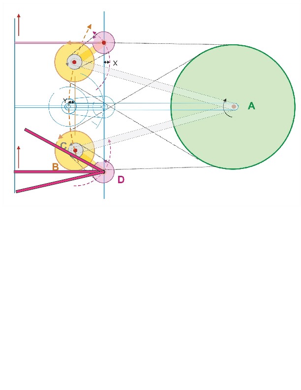

hi Alighszem.

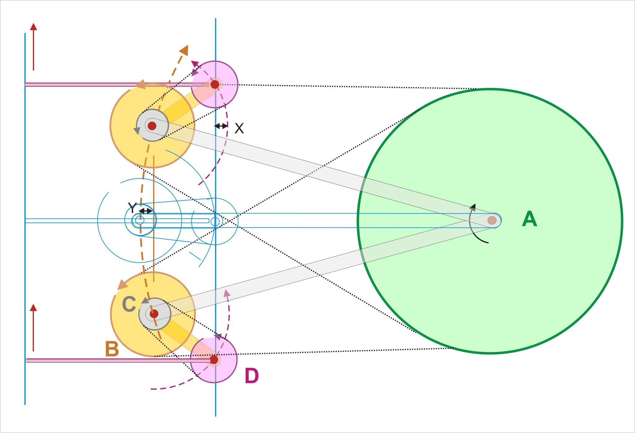

following your description I tried to make this skethc to better understand how, and if it works. If it's correct you may clarify it better than me
p.s - for me - geometrically - it works - my congratulations again

Please see the image.following your description I tried to make this skethc to better understand how, and if it works. If it's correct you may clarify it better than me
There can't be any skating force when the stylus can move only perpendicularly to the stylus drag.The issue I see Carlo is this has the possibility to mistrack unless the pivoting HS is coupled to the mechanism so stylus drag force can drive the system. It will also have variable skate force. Inwards at the outer groove becoming zero centrally and outwards at the inner groove.
Stylus drag force is very misunderstood. In a parallel tracking TA like Niffy's and vynuhladdict's, stylus drag force with the positive castor of the CL is what drives the carriage across the LP, like a shopping trolley wheel stays straight. This then requires very low lateral friction otherwise the CL will deflect.
You can not decompose the stylus drag force vector into perpendicular components.
It doesn't matter. The rear end of the arm wand is a pivot. It may move sideways freely and won't be tangential to the groove. Please see the diagram. The broad red lines indicate the possible positions of the arm. As I said before, this plan won't work. It makes things complicated for nothing. This plan is already complicated enough. But it still needs extra structures and mechanisms to keep the arm wand tangential to the groove.this sketch can be clearer
distance X - Y = 0
jim - alighiszem may aswer much better - for me the alignment is determined from connection axle to single pulley and pulleys ratio. It was the same on my belt PLT Rabbit - strange devices, the pulleys ..

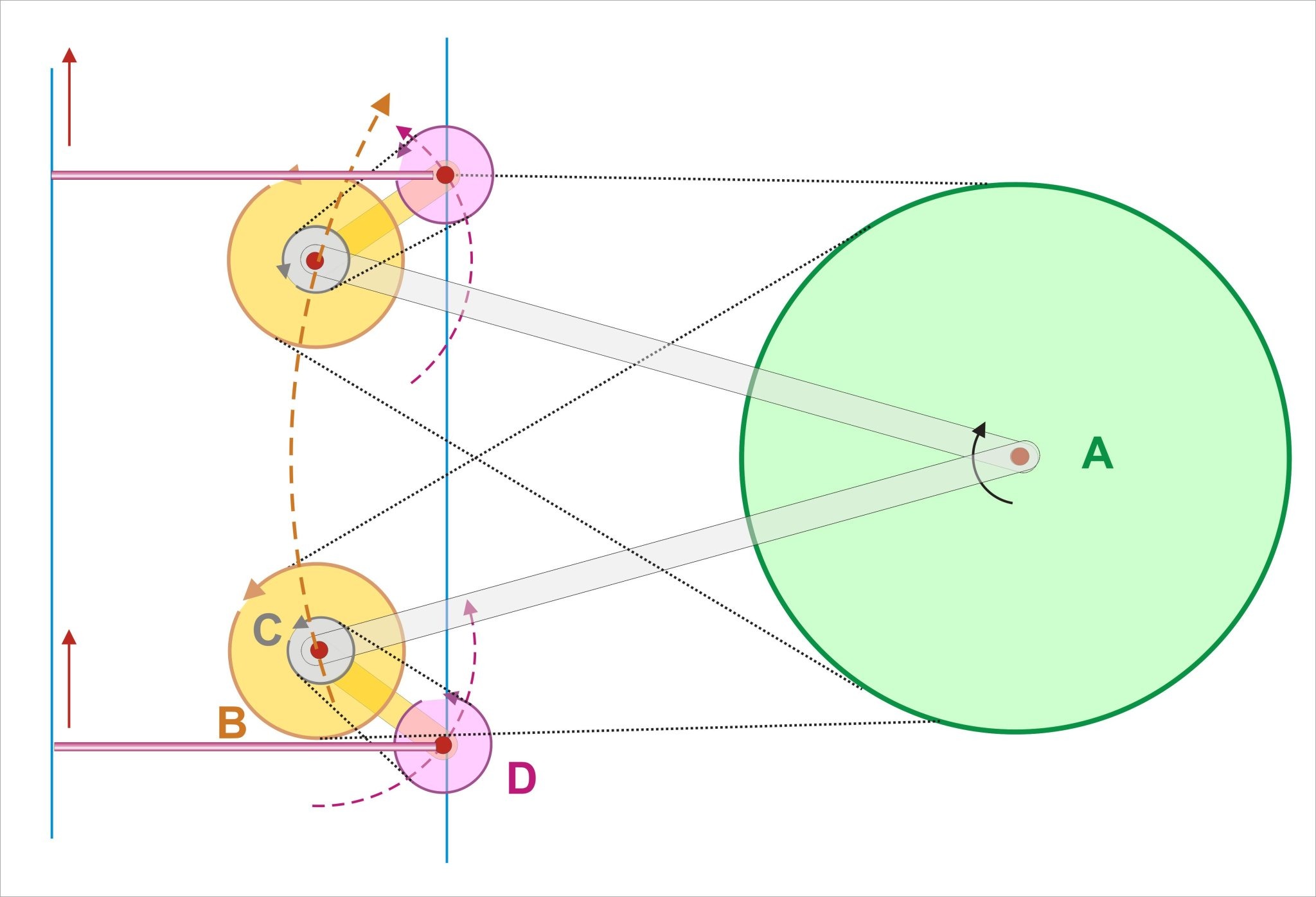

You simply do not understand the mechanism. Since the pulley D is connected to the othe pulleys, it cannot move freely.
I have never said that the pulley D will move freely, but the arm wand B.You simply do not understand the mechanism. Since the pulley D is connected to the othe pulleys, it cannot move freely.
Carlo,
I think your original drawing at 4947 can be seen as two equal and opposite twin arm PLTs with a shared wand. The rear control arm is also shared and could be built with a string, magnet, and attractor.
The genius of this is that skating becomes a positive agent as in Ralf's arm, but passive. A popsicle stick version of this might be fun to build

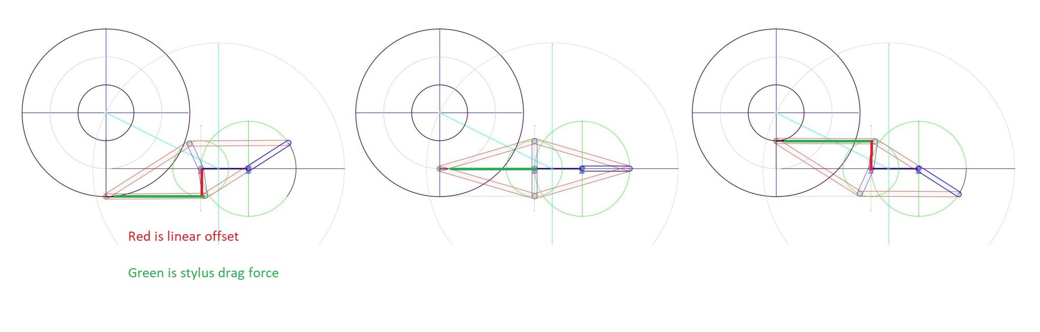

Incorrect, skating force is created when stylus drag force is not coincident with the pivot. In Calro's arm its only coincident with the pivot at the center.

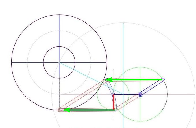

Thought I'd add a diagram to illustrate skating force. In the diaram stylus drag force GREEN acts on the imaginary point of intersection to the linear offset RED creating a torque around the pivot hence skating force.
How? Does the arm wand B "decouple" from the pulley D?...which is firmly attached tu pulley D. Why else were there the pulley D?!
Intrigued folks.........Thought I'd add a diagram to illustrate skating force. In the diaram stylus drag force GREEN acts on the imaginary point of intersection to the linear offset RED creating a torque around the pivot hence skating force.
Can this Skating force be useful in "driving" the stylus across the radial track? - and if so it will vary from plus to minus, mid record, might it be beneficial to set the pivot outside the record and have it all the same sense, then, if so is that useful?
Eccentricities would remain a problem, driving back against it?.....
M
Not true.Incorrect, skating force is created when stylus drag force is not coincident with the pivot. In Calro's arm its only coincident with the pivot at the center.
Skating force is created when the sum of the torques caused by the stylus drag is not zero, snd this is only possible when the direction of the stylus movement is not perpendicular to the stylus drag force.
Stylus drag in green

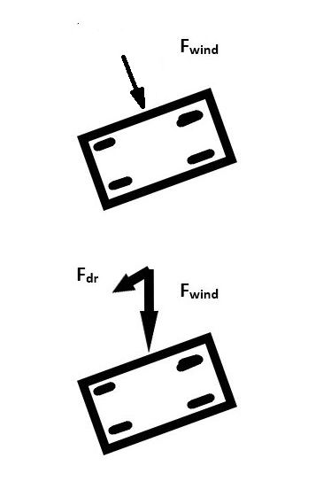

Another example:
The wind is blowing on a zero friction car. When the direction of the wind is perpendicular to the direction the car can roll, the car will not move in either direction. But when the wind is not perpendicular, there will be a component of the force vector F dr in the direction the car can roll, and it will move.
A nice analogy.
But if the rear wheels are fixed as you've drawn (i.e. the pivot) and the front are not but can move around an arc restrained by another pivot..........then one end will move, change the fixed and partly restrained and it goes the other way?

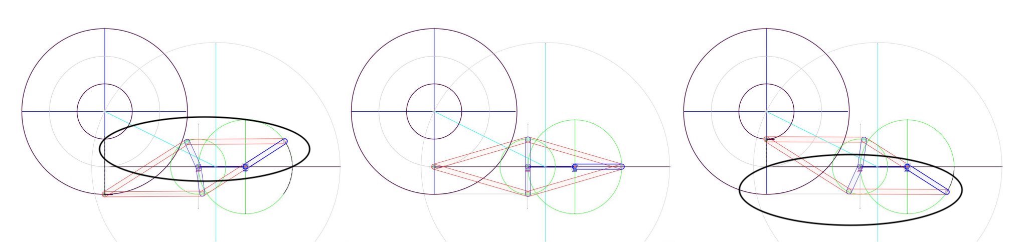

First of all thank you all for your interest in these topics, it's nice to see our sleeping thread come back to life.
Your observations are all clever and correct, highlighting some problems not easy to overcome, as noted on my #4995 etc
As you say the action of the SD is favorable in the first half, neutral at the center, and contrary (!) in the second *-
therefore, #4957
So I'm thinking to design the arm with an asymmetry in order to get some inner force during the whole tracking. (old simulation based on first type Peaucellier geometry)
Or simply positioning the main pivot centered on the outer groove?
Before posting the Peucellier geometry I spent some time exploring it, with the help of a couple of creative friends.(thanks) and trying also to imagine what could be like a working TA of this kind.
Now to go further we need a detailed vector breakdown of this complex model, but my surviving notions of vector calcs are really inadequate for such task.
Difficult, without those data, to "guessstimate" if it could be feasible or not, and useless too
