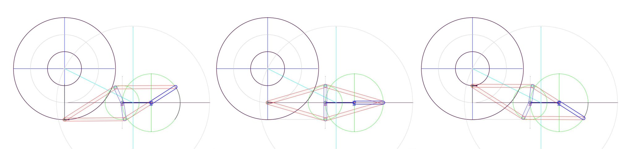

Maybe someone may remember my attempt to build a linear TA based on pivots instead of wheels + rails (page 231 from #4616 to #4635)
Hope not, given the complete failure of that hypothesis = impossible to avoid a sliding guiding movement i.e. wheel+rail.
But the other day, browsing among the actuators used in robotics, I discovered Monsieur Peucellier who, a century and a half ago first invented how to convert geometrically a circular motion into a straight one.

I began to think if that geometry could be right for us by testing some linkage2 simulations, and the premises are there, especially for this variant of the Peucellier mechanism, but of course may also be guessed a lot of problems:
I'd be curious to know your opinions before annoying with my first design hypotheses
- keeping the orthogonality of the headshell, perhaps obtainable by splitting in halves the rhombus
- the number and even more the type (the triple ones!) of joints/bearings needed
- etc- etc - etc

I feel it may be simpler for the joints and offers some easier alignments?

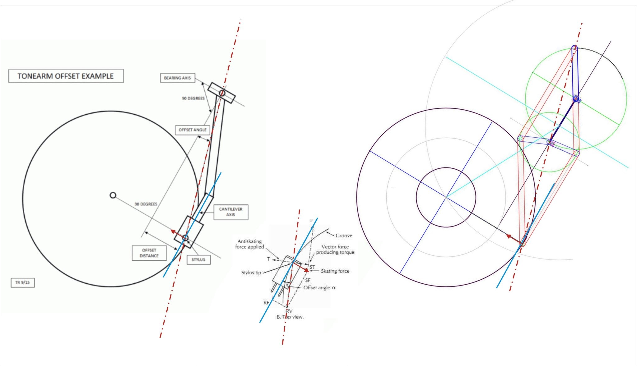

I'm trying to better understand how the first one works, because the Side Force seems to counteract somehow the appropriate rotation of the pulleys: so limiting the torque at most becomes important.
One of the things intriguing about the Peaucellier is that, when properly positioned, it can use the Stylus Drag to trace much like a Birch PLT.

I understand your 'gut feeling' but since the main wand does not rotate, the "side force" can not counteract.
The Peucellier can not use the stylus drag since the direction of the stylus drag is perpendicular to the movement of the stylus.

Peaucellier - I wish it were as you say - the cantilever is aligned with the stylus drag, but the TA main pivot is not - it's only aligned when the rhombus is centered.
So, as Ray would say "there is skating" or, at my hoping,: if you know how to use it, there is a tracking movement with very little side force

Re: Peaucellier:
Since a vector cannot have a perpendicular component, the friction force force cannot drive the lever in a perpendicular direction.

Sorry, I can't see any differences between my Peaucellier (at the start) and a common Pivoted one: same offset angle between groove and eff length. = same skating force. (their component)
So I'm thinking to design the arm with an asymmetry in order to get some inner force during the whole tracking.

There is a pivotal (pun intended) difference between your Peaucellier and a common tonearm: the common tonearm"s movement is not perpendicular to the friction force, the angle is less than 90 degrees. The fiction force vector does have a component in that direction.

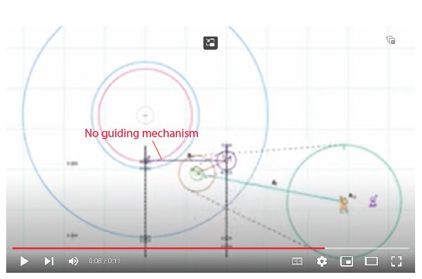

The superimposed - as you call it - pulleys function as follows (version 2.0):
The green (big) pulley is static. It is in connection with the amber pulley whish is firmly attached to the amber wand.
The turquoise wand is firmly attached to the (smallest pulley) at it's end which is connected to the purple pulley at the end of the tonearm.

The issue I see Carlo is this has the possibility to mistrack unless the pivoting HS is coupled to the mechanism so stylus drag force can drive the system. It will also have variable skate force. Inwards at the outer groove becoming zero centrally and outwards at the inner groove.
Stylus drag force is very misunderstood. In a parallel tracking TA like Niffy's and vynuhladdict's, stylus drag force with the positive castor of the CL is what drives the carriage across the LP, like a shopping trolley wheel stays straight. This then requires very low lateral friction otherwise the CL will deflect.
Both ideas won't work because there is no guiding mechanism to ensure the wand is tangential to the groove not to mention all the pivots and wheels. It is completely unnecessary. If you want to go to point A from point B, just take the shortest route.Thank you!
