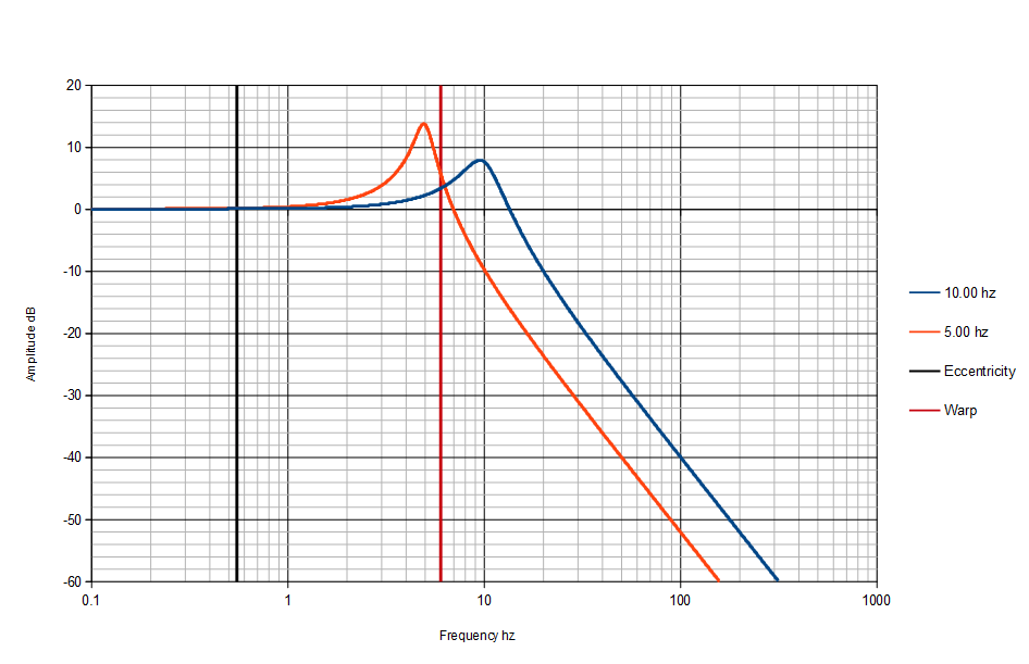

The diagram shows the transfer function of a typical arm-cartridge combination tuned to 10hz and 5hz, blue and orange. It shows how much the cartridge body moves relative to how much the stylus is moving.

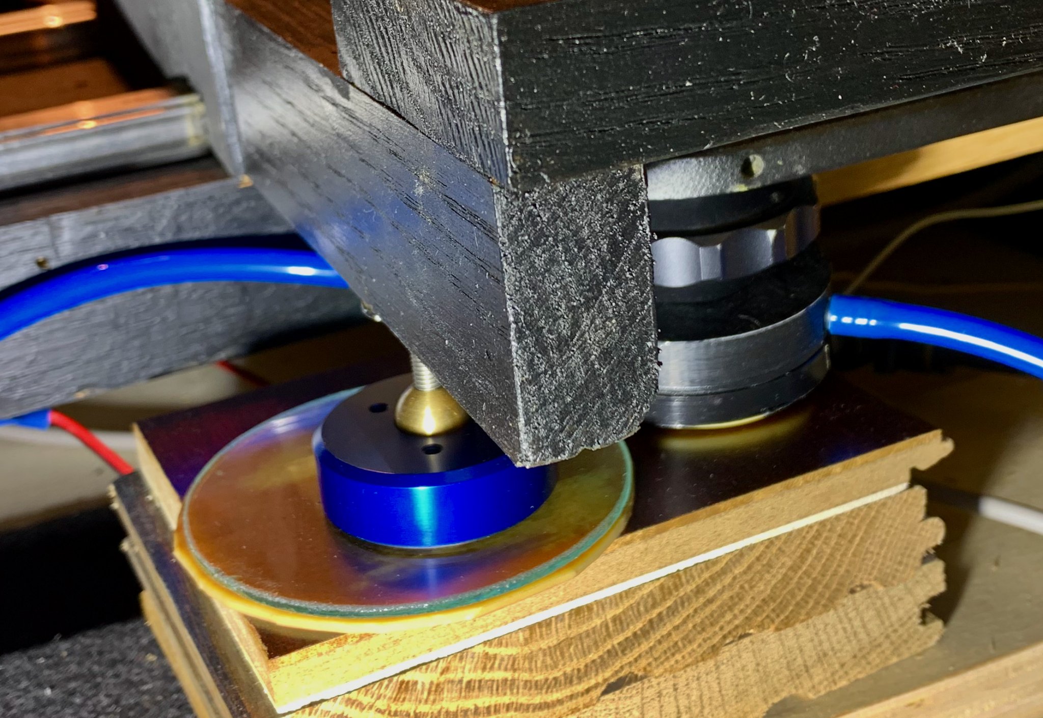

I am always wondering why my air-bearing arms are so quiet.

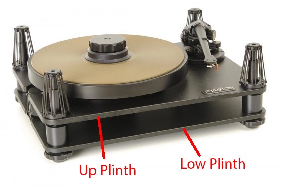

This can be another reason. My table is SME 20. SME 20 has two plinths. The up plinth is suspended with rubber O rings.
I modified the table. The up plinth and the arms are floating on 5 round air bearings. These round bearings are supplied with 90 psi compressed air. The total weight of the top plinth with other structures and arms is about 30 lbs. So, the air films for these round air bearings are very stiff and must have a pretty high-frequency damping factor. The low plinth sits on 4 air pucks. These air pucks are supplied with 20 psi compressed air.
I am not saying the vibrations from the cartridge may transfer through the air film of air bearings. I guess the air film dampens the vibrations since one of the properties of air is damping. The stiffer the air film is, the higher frequency of the damping factor. Stiffer air film can be achieved by increasing the load or air pressure.

Are the air-pucks supporting the top plinth by themselves or do you still have the original o-rings in place? If you have removed the o-rings how do you keep the deck from sliding sideways?
One definite advantage of an air bearing is that its friction is not dependent on load so you can build a heavy arm suitable for very low compliance cartridges. I think that my jewelled bearings could be used for arms up to about 100g though I probably stick to 80g for safety. This would still allow for cartridges in the 10-12μm/mN range.
Low friction is important to a point. Once you get the dynamic friction below 1 or 2mN any cantilever defection will be completely inaudible.

Niffy,Are the air-pucks supporting the top plinth by themselves or do you still have the original o-rings in place? If you have removed the o-rings how do you keep the deck from sliding sideways?
I still use the original o rings. The o rings are mainly for holding the plinth in place. Otherwise, it will be sliding.

The "problem" with air bearings overshooting due to eccentricity is not actually a major problem and would be just as applicable to mechanical linear trackers. This overshoot is actually not unique to linear arms and is applicable to all arms, it applies to pivoted arms as well.
The best way of thinking about this is to look at how much the cantilever is deflected by this overshoot.
A typical cartridge fitted to a well matched pivoted tonearm tracking a typical level of eccentricity will have its cantilever deflected by maximums of less than 0.01°. This is the deflection due to just its effective mass and does not take into account any other factors such as bearing friction or anti-skate.
I think that we can agree that 0.01° is utterly insignificant.
If your linear tracking arms carriage has an effective mass (basically it's entire mass) 4 or 5 times that of the pivoted arm the deflection of the cantilever will also be 4 or 5 times greater. 0.04-0.05° is still utterly insignificant.
The deflection due to varying skating force in the pivoted arm will be much greater than this.
As you mention the level of overshoot can be slightly reduced by the addition of damping. With an air bearing this is via an external silicone damping trough and with a mechanical bearing it's via bearing friction. One advantage of an air bearing is that the level of damping is tunable where it isn't with the mechanical counterpart.
I wouldn't worry about "overshoot" as it's a problem that doesn't really exist.
