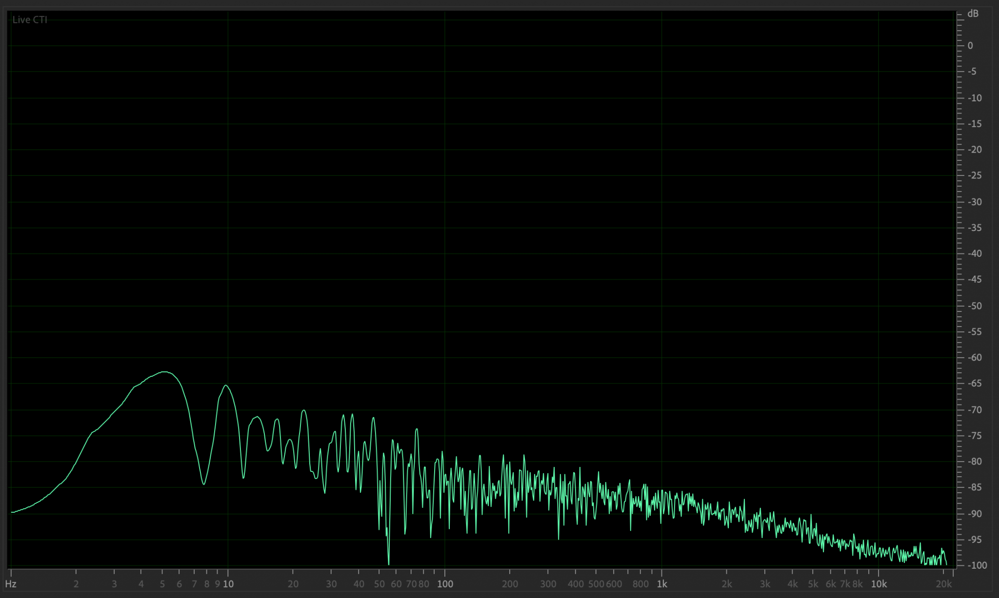

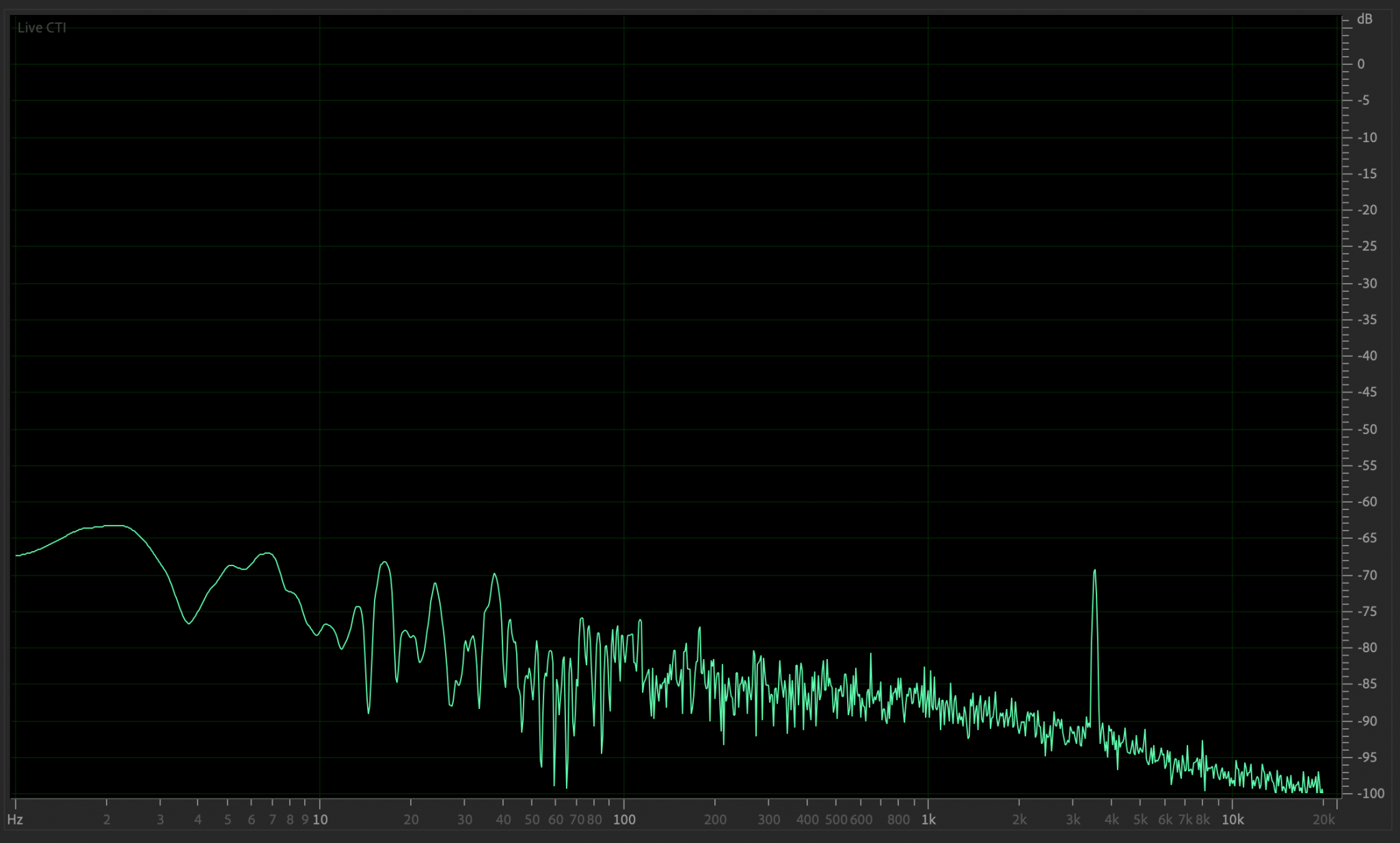

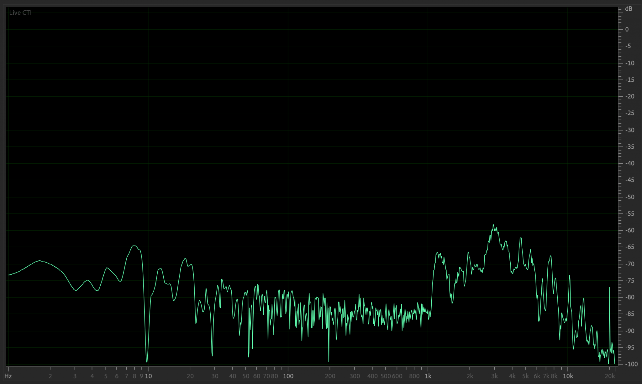

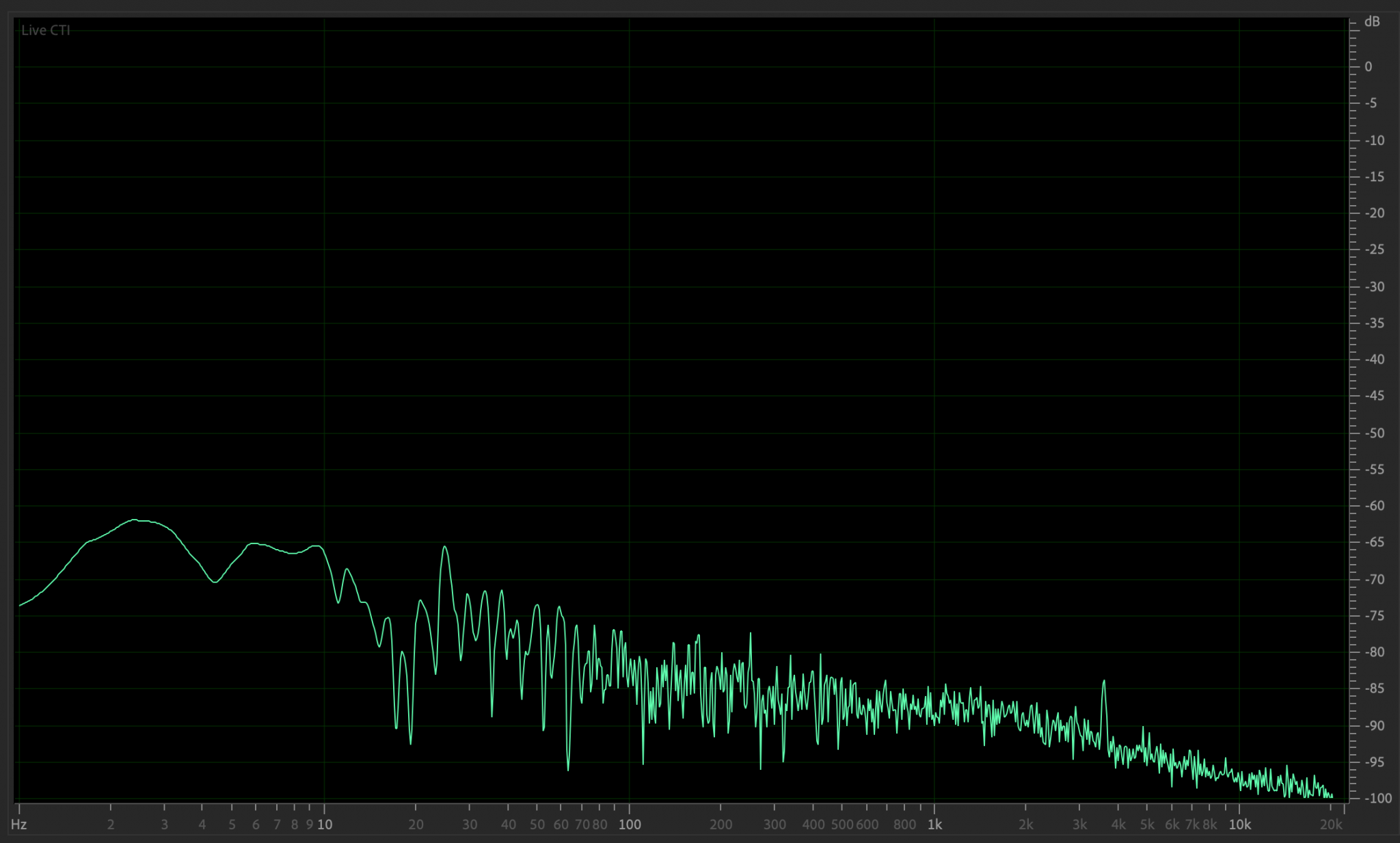

The plots in order.
Bare arm wand, arm wand with CW stub, Silicone tube inserted into the arm wand, last is 3 small earplugs inserted into the wand.
What we.re looking for is ideally a flat plot or as close as possible to flat.
M
All of the plots are almost the same below 60Hz as damping inside the arm tube does little to help down there. What's interesting is how the different damping materials affect performance. I even tried cat hair inside the wand which was quite effective combined with the plugs.
The measurements were performed with a calibrated microphone and the wand hanging on a string. I performed this test to gain a better understanding of how much damping would be needed in the arm wand.

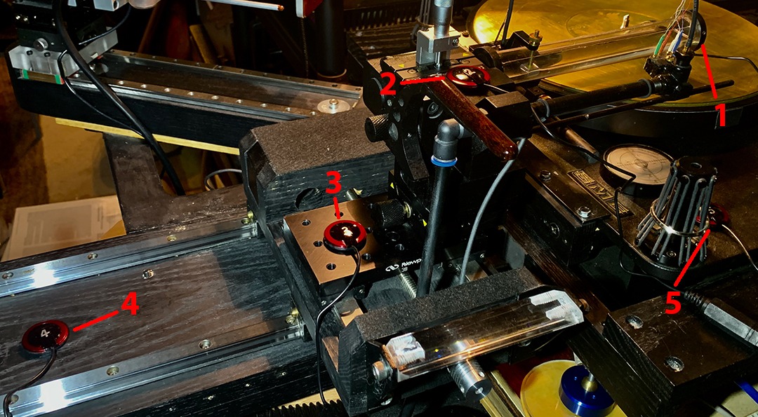

I did some resonant tests today.
I bought a pack of 5 contact mics from Amazon and placed them strategically on my turntable in different locations. Please see the photo below. The smaller number, the closer to the arm.
The number 1 location was on the end of the bearing shaft. I used a piece of metal and let it fall freely on the outside of the air-bearing. Then, I recorded the signal at position #1 under two conditions, with and without compressed air.
Here is the result without air.
Here is the result with the air.
From the results, I can conclude the following:
1. The resonant frequency of my air bearing is about 3.5 K.
2. It is inconclusive if the film of air will make any difference.
3. It seems to me that the bearing with air has less ringing.
I also run a sweep of 30 Hz to 30 kHz signal from Cardas Frequency Sweep And Burn-in Record. For comparisons, I held the contact mic without touching anything. Here is the result. The result shows the noise level without any signal inputs.
Here is the result when the contact mic was placed at position #1.
Here is the result when the contact mic was placed at position #2.
I didn't do the tests for positions #3, #4, and #5 since the signals will be so weak that it is lower than the noise. It is already very weak at position #2. From the result of the sweep, it confirms again, this particular air-bearing of mine has a 3.5k resonant frequency. Comparing the result with the non-contact mic, I would say that the damping of my air-bearing arm is very good. Even at position #1, the 3.5 kHz signal, resonant frequency, is at -70 dB. In other words, only the resonant frequency was transmitted.
In summary, the air-bearing arm has excellent damping. This may contribute to the quietness I have heard.

Hi Jim,
It's a bit difficult to tell exactly what is happening in your tests. It looks like there is very little energy being transmitted to the rail/bearing shafts.
Have you used a stethoscope whilst playing music?
3.5khz is higher than I would have expected for a resonance of the air gap but it could be. It might be the resonant frequency of the bearing shaft.
