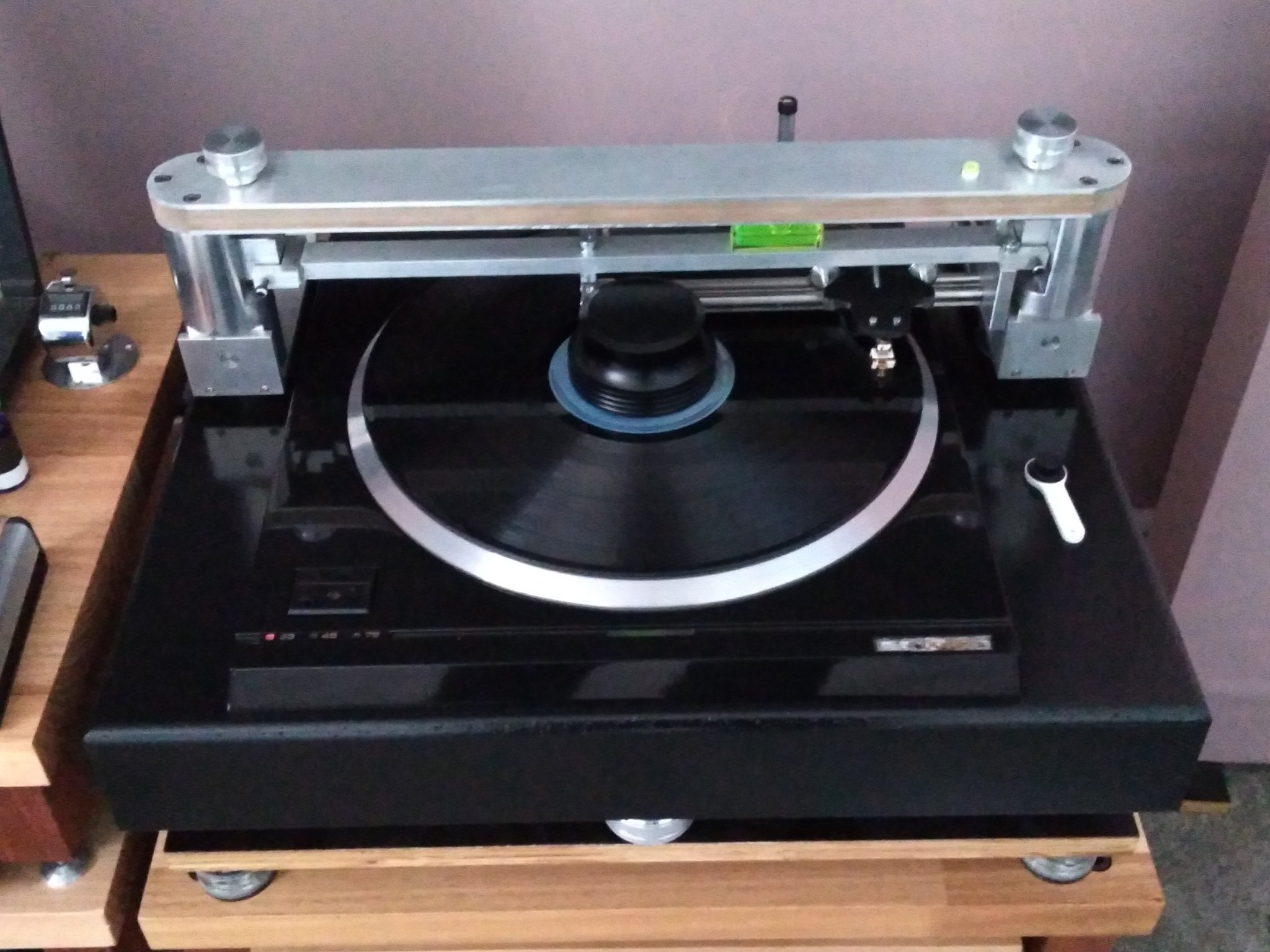

Prompted by this discussion i just did some experiments.
Oh dear!
So, my TA, an RTA using radial rails, demonstrated the following with a record playing but no amplification.
Just to give you an idea, there is little needle talk with this set up, so hearing music through the stethoscope is quite surprising!
Stethoscope on the rails, near the mount, I can hear the music plainly and in detail
Down through the rail mount block, across the pivot joint and down to the arm board base is all similar level.
Seems well coupled through there.
The lower plinth is quieter.
The shelf below the sand bed, i can still hear it and
Even the wall shelf shows up some quiet notes!
I imagined that even in the wall i could hear some notes occasionally, its amazing what this micro-vibration does.
Thats all quite as expected in terms of the gradual decay, but if the music can cross the sand bed, it's not doing its job well at all!
Meanwhile the most significant thing is that the music is roughly 50% louder on the rails on the inside of the carriage nearer the record centre than on the rails that are nearer the arm mount.
So, gents, i need a diagnosis and cure please.
By the way, i cannot dare put the stethoscope on the carriage itself to see how well coupled that may be, possibly i could put a small contact mic on there if small ones are available?

Hi Mike,
I've dug-out my stethoscope and tried the same tests.
I can clearly hear the music on the rail. In my case it is loudest close to the carriage and get quieter the further away I test. It is a bit louder at the left end of the rail compared to the right when the carriage is in the middle. I would expect this as the right hand end is more solidly connected to the arm pillar. The left being cantilevered, though in my case there is a massive beam connected to the left hand end specifically designed to support it.
I can hear the music from the arm pillar and the rest of the arm structure. Like your result it is pretty similar in level regardless of where I test.
The level is reduced on the sub-chassis but is similar in level regardless of where I test. My sub-chassis has an acrylic upper piece mounted on an aluminium-acrylic sandwich structure. Surprisingly the music is slightly more audible on the sandwich structure. As expected it is louder again on the main bearing mounting plate showing that the platter is also being coupled nicely.
Slung underneath my sub-chassis I have a heavy, highly damped slab of laminated aluminium and lead. This is designed to act as a sink for the vibrations coming through from the sub-chassis. The music is only just audible here. Looks like my coupling and channeling of the energy from the stylus-groove interface is working as intended.
Testing on the main plinth, that is separated from the sub-chassis with the suspension, I could hear nothing. Good news as it shows that the suspension is isolating well.
It seems strange that you are hearing sound all the way through your support system. Are you sure that you are not just hearing the stylus talk transmitted through the air?
I also checked the deck with the stylus not in the groove to check for bearing and motor noise. Very happy to report that I couldn't hear anything even with the stethoscope against the bearing mounting plate. I have my motor mounted on the sub-chassis with silicone isolation. Although I could clearly hear motor noise when testing on the motor body directly I could hear nothing anywhere on the sub-chassis. I also use a couple of idler wheels the belts run around and again the bearings for these are still running silent. Good news here as I went through at least half a dozen different designs trying to get them silent.

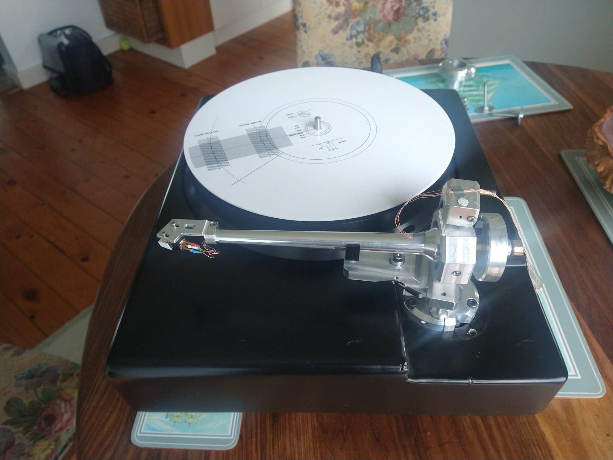

Here are a few things I've learnt from building LT and pivoting arms.
My second LTA built similar to @niffy arm was extremely quiet, ie no clicks and pops on very scratched LP's. Great bass reproduction I suspect from high lateral mass preventing the stylus waggling the arm back and forth, remember under 200Hz on an LP is horizontal modulation. These were the 2 standout qualities.
Modifying the EPA-100 replacing the CW and stub to lock CW rigidly, new far more rigid mounting base/post and viscous damping. These mods improved the EPA-100 to where it was significantly better than the LTA, except for click/pop suppression.
From the EPA-100 modification experience I designed and built the pivoting arm in the last pic. This arm originally started life to be mounted to a linear carriage driven by a motor, I'll go into why I parked the project later. This arm is designed and built to be massively rigid and neutrally balanced, careful attention was paid to mass distribution. It's an incredibly detailed tonearm, the only area the LTA outperforms it is in click/pop suppression. Even though this arm looks massive its minimum effective mass is 12g. So the learning from this is mass distribution and rigidity are 2 key elements to making a great tonearm, @Mike56 has used these principles to construct his LTA and it certainly has worked for him.

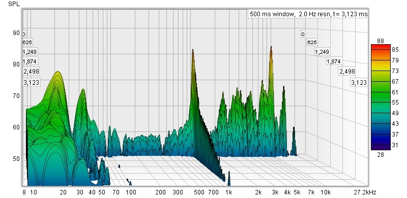

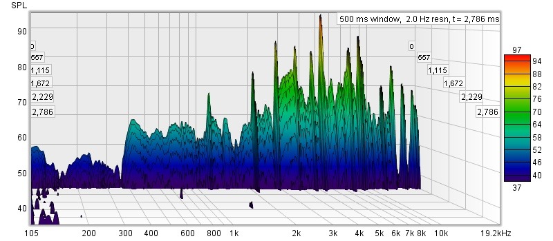

You'll all have to forgive me as I'm going to talk about servo linear arms to bounce ideas in order to refine my design.
I parked the servo LTA because of rail noise, I couldn't eliminate rail noise as the carriage moved. I think I have this somewhat fixed with a different rail and some damping.
From the above learning a pivoting arm on a servo driven carriage has a lot of advantages in that horizontal effective mass is not a product of carriage mass. Viscous damping can be implemented off the LP to prevent possible leakage. The downside is complexity and possible motor/rail noise induced into the cartridge.
A short rigid arm rings far less than a longer wand type evident in the click/pop performance of a short rigid carriage. One possible solution is a Dynavector style split vertical/horizontal arm setup, the down side is non-uniform ellipsoid of inertia, which can cause erroneous movement ie as the stylus tracks a warp it's possible for the arm to move sideways and not straight up/down. Implementation of vertical viscous damping requires trough over LP. This makes me think a very rigid as short as possible pivoting arm wand could be the best compromise.

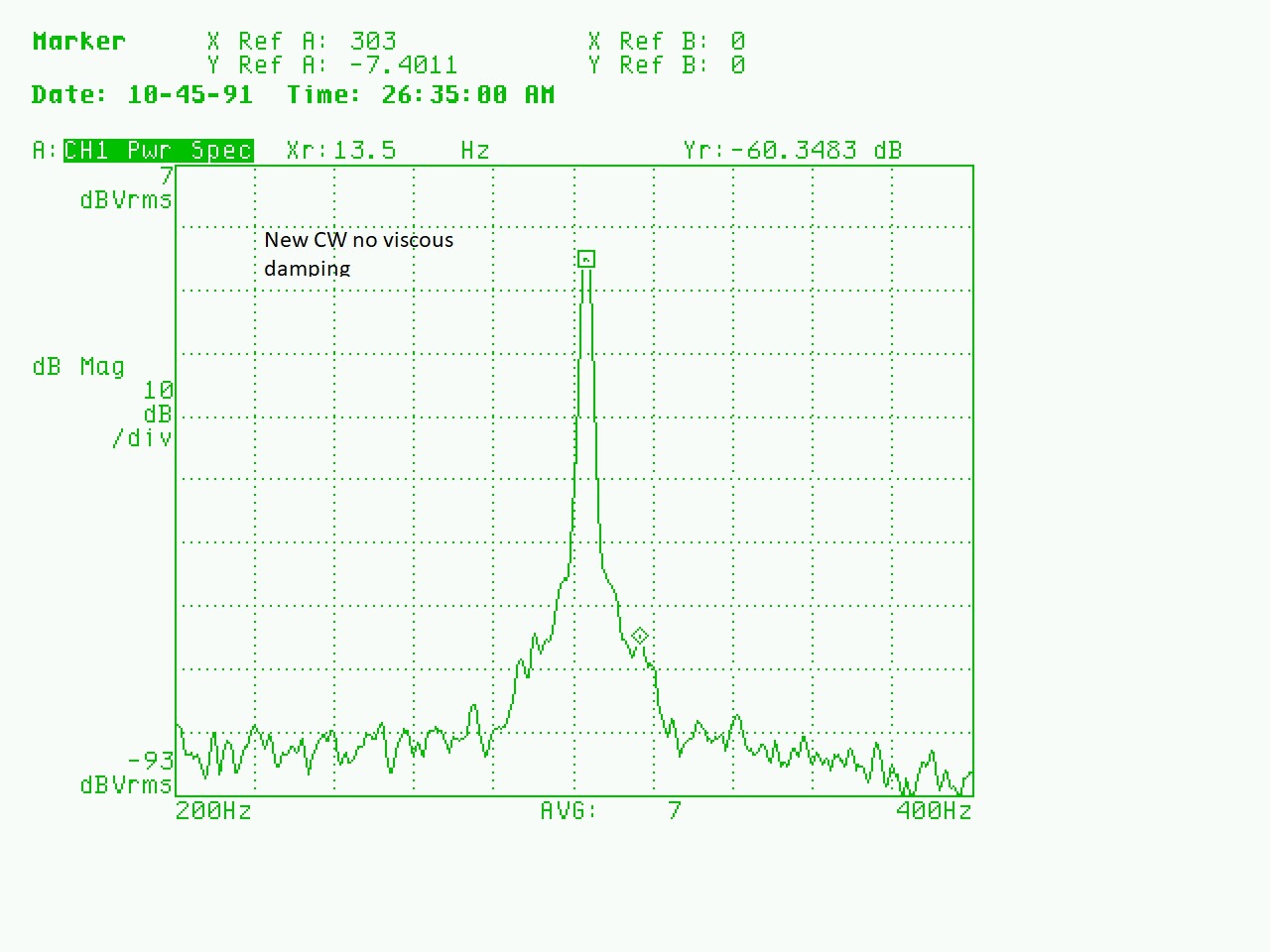

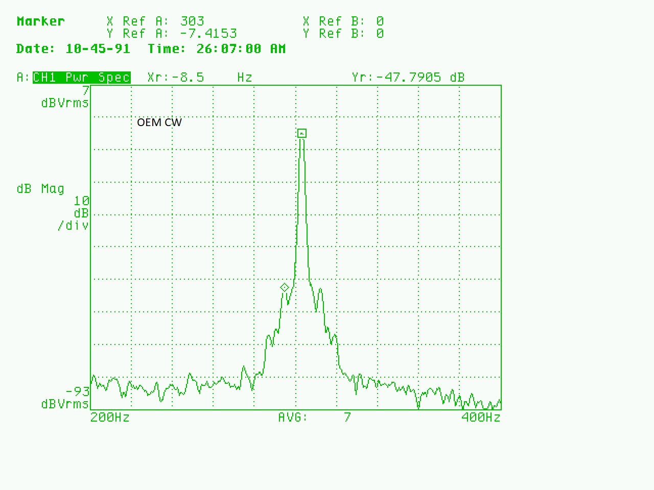

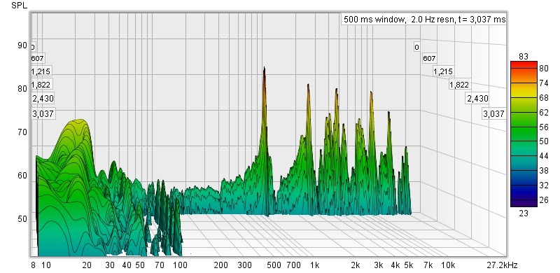

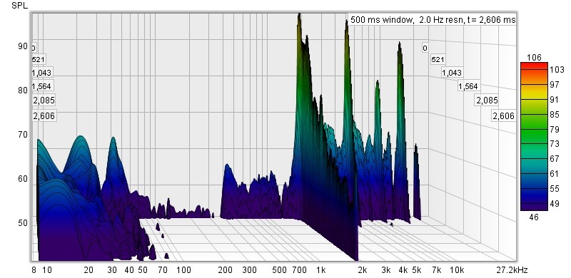

Mike I think stiffness is the key, as stiffness increases so does the resonant frequency. If the Fr can be pushed high enough then the harmonics are also pushed higher and the 3rd is usually the biggest offender. If the 3rd can be pushed out of the audio band you are doing very well. Then a very small amount of damping can be applied.
One thing with damping is what are you damping. Ideally the damping should target the problem. When I was testing my DIY 4 point I performed resonance tests on the arm wand with different damping material until I found the best result, then the CW stub was bolted on and re-tested to ensure the performance was still ok. Small changes like adding the CW stub can drastically alter vibration profile of the structure. What I was looking for was a reduction in level of the fundamental resonance and harmonics without adding other peaks. What I found was incorrect damping added other resonant peaks.
The plots in order.
Bare arm wand, arm wand with CW stub, Silicone tube inserted into the arm wand, last is 3 small earplugs inserted into the wand.
What we.re looking for is ideally a flat plot or as close as possible to flat.
