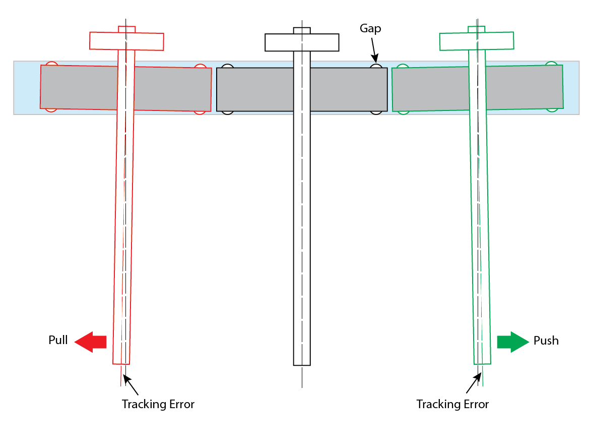

You misunderstood the meaning of another pair of wheels located at the back.I think this is a legit argument. However, I am still not convinced yet. Further investigation is needed.
Here is a diagram to illustrate my viewpoint when I said that the accuracy of the wheels and the wall of the water container is problematic. From the diagram, you can see there is a gap between the wall of the water container and the wheels. Once the record moves, as in your video, the eccentricity of the record will pull or push the arm sideways. It will cause tracking errors. There is also a dilemma. If the gap is too small or nonexistent, the effects of record eccentricity will put all the effects on the cantilever. The cantilever will be bent unless there is very small friction between the wall and the wheels. If the gap is too large, it will produce large tracking errors.
I am not convinced either. Further investigation is needed, too.
I put them so that during the operational movement of the tonearm with my hand, the float does not touch the back of the foam plastic to the glass surface of the aquarium, otherwise the foam plastic slows down.
In the case of finding another pair of wheels, the tonearm can be quickly moved to the beginning of the plate without any problems.
Understand that a system with one pair of wheels, a pulling force of a groove and a triangle - two wheels + a head are self-sufficient, while the tonearm works flawlessly and this can be seen in the video.
We need to make another video clip so that you understand how it works.
I was thinking about avoiding yaw, as Jim (super10018) suspected, and came up with an idea and wonder if it would work... What if I use two thin horizontal round glass rods glued together submerged in water and have a carriage made of floating material with only two wheels rolling on the track between the two rods and a tonearm mounted the carriage between the two wheels, which takes care of the horizontal movement and the wheels' contact points creates a pivot that's for the vertical movement. That should be able to avoid yaw movement, no? The floating material can be adjusted to the desired amount of applied pressure on the track. Instead of a typical mechanical parallel tracking arm with all the mass of the arm rolling on the contact points, the floating material helps to lessen the mass but still having mechanical grounding. The water or fluid helps to dampen movements. I don't have a drawing so I hope my description is not too confusing.
The main advantage of the aquaarm is that the entire mass of the tonearm is on the water surface and moves on it, that is, friction occurs only on the water, and two wheels take the load only from the plate track pulling the float.I was thinking about avoiding yaw, as Jim (super10018) suspected, and came up with an idea and wonder if it would work... What if I use two thin horizontal round glass rods glued together submerged in water and have a carriage made of floating material with only two wheels rolling on the track between the two rods and a tonearm mounted the carriage between the two wheels, which takes care of the horizontal movement and the wheels' contact points creates a pivot that's for the vertical movement. That should be able to avoid yaw movement, no? The floating material can be adjusted to the desired amount of applied pressure on the track. Instead of a typical mechanical parallel tracking arm with all the mass of the arm rolling on the contact points, the floating material helps to lessen the mass but still having mechanical grounding. The water or fluid helps to dampen movements. I don't have a drawing so I hope my description is not too confusing.
The float can be located anywhere in the aquarium, but when you put the tonearm on the going track of the record, it is instantly attracted to the glass wall through two wheels and its geometry takes the shape of a triangle we need, and this is the pickup needle and two wheels adjacent to the glass wall of the aquarium.
This scheme is extremely simple and I believe that it should not be complicated.
In this scheme, you did not take into account the main force of the aquatank.
This is the force of the walking track that will pull the tonearm forward.

I understand that the groove will pull the arm forward. The question is if the base is yawing under the eccentricity of the record. If both front wheels have solid contact with the wall of the water container all the time even under the eccentricity of the record, my previous diagram is invalidated. In other words, the arm is not yawing.In this scheme, you did not take into account the main force of the aquatank.
https://www.diyaudio.com/community/threads/diy-linear-tonearm.238027/post-7148806Я понимаю, что канавка будет тянуть руку вперед. Вопрос в том, рыскает ли база под эксцентриситетом записи. Если оба передних колеса имеют плотный контакт со стенкой резервуара для воды все время, даже при эксцентриситете рекорда, моя предыдущая диаграмма недействительна. Другими словами, рука не рыскает.
The video doesn't show it. My suggestion is to take off the cover, play an eccentric record, and watch both front wheels. If both wheels contact the wall simultaneously all the time, it indicates that there is no yawing.
